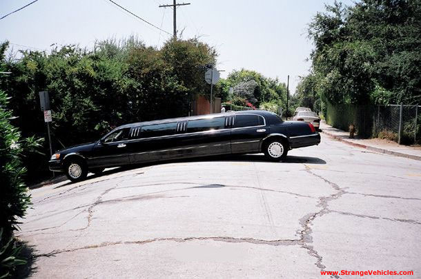

Well, looks like you have many opinions and help from others. I'll put in my 2 cents. Since I did not see any mention of a substitute take a look here and cross it off your list of alternatives. /forums/images/graemlins/grin.gif
