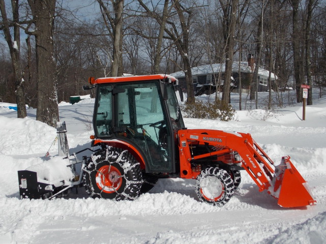

I always viewed a good set of chains like fire insurance. You hope you never need em, but you're glad you have them when you do.
