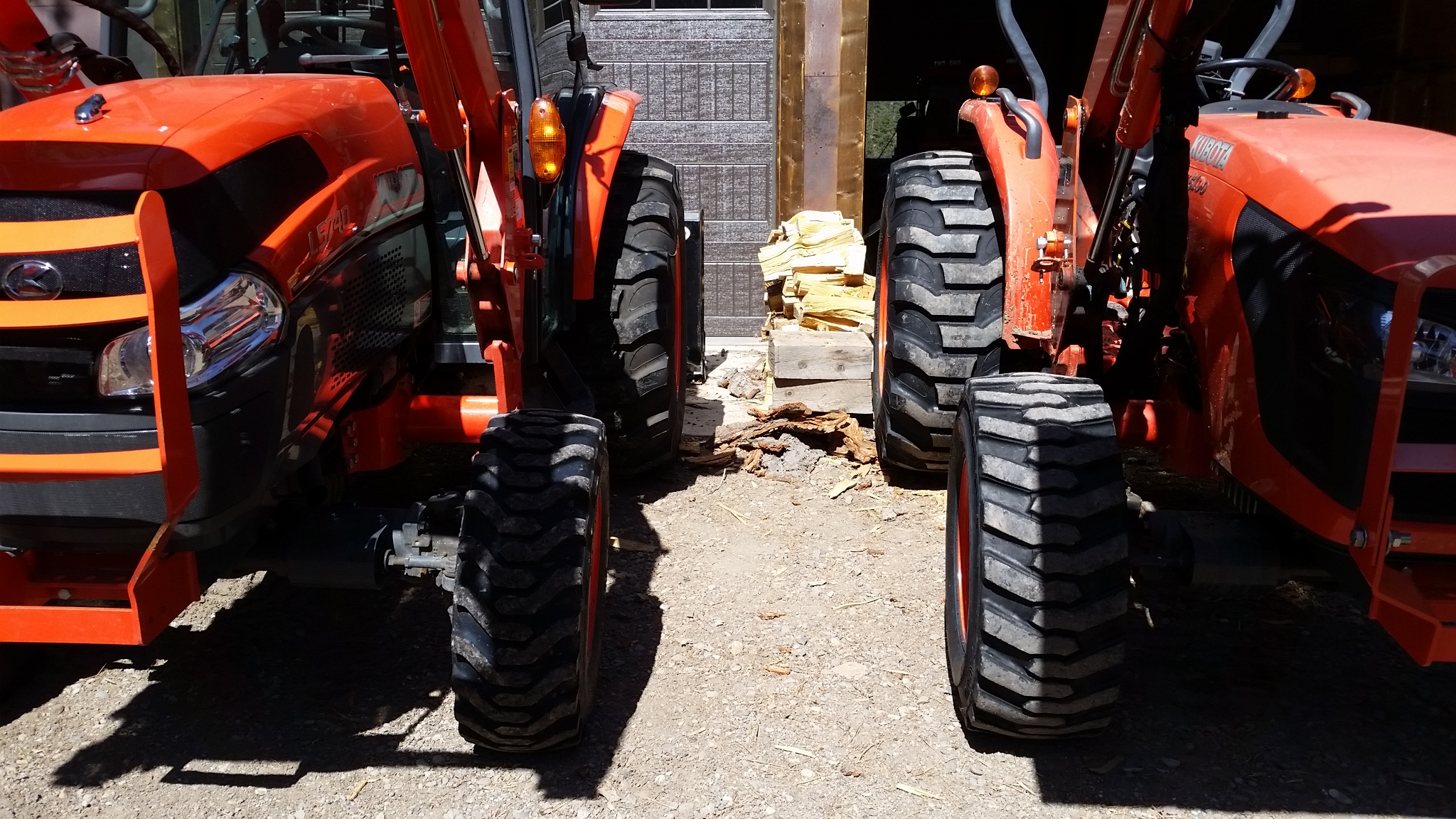

The L6060 ROPS model weighs 3990lbs. The MX5800 weighs 3734lbs. I wonder why it feels lighter? It's also slightly larger in every dimension except width.
To me sometimes the L series feels lighter because of the smaller front tires. Here are the L5740 and MX5100 for comparison. 20170419_105313.jpg
