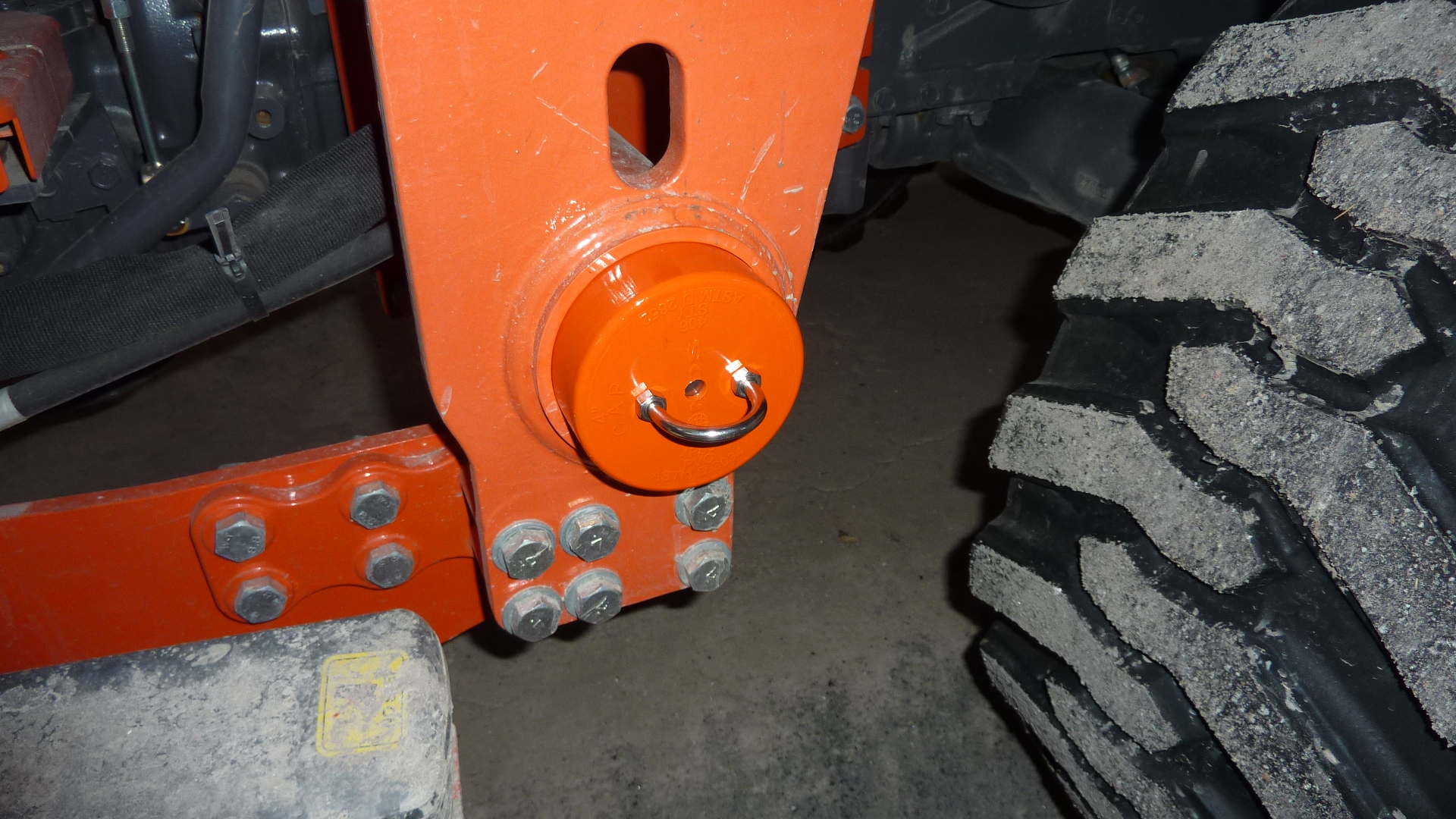

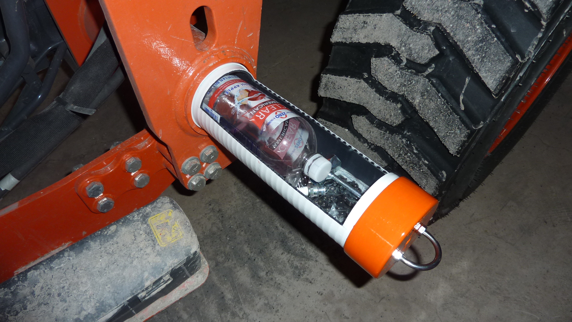

1 - The small ROPS mounted toolbox (Missing if you have a cabbed model) There is no convenient place to mount a larger one without interfering with work operations. As a partial fix, I added a pair of these home made tool trays made from PVC pipe fittings:
A second set can be placed in either side of the FEL cross tube if desired.

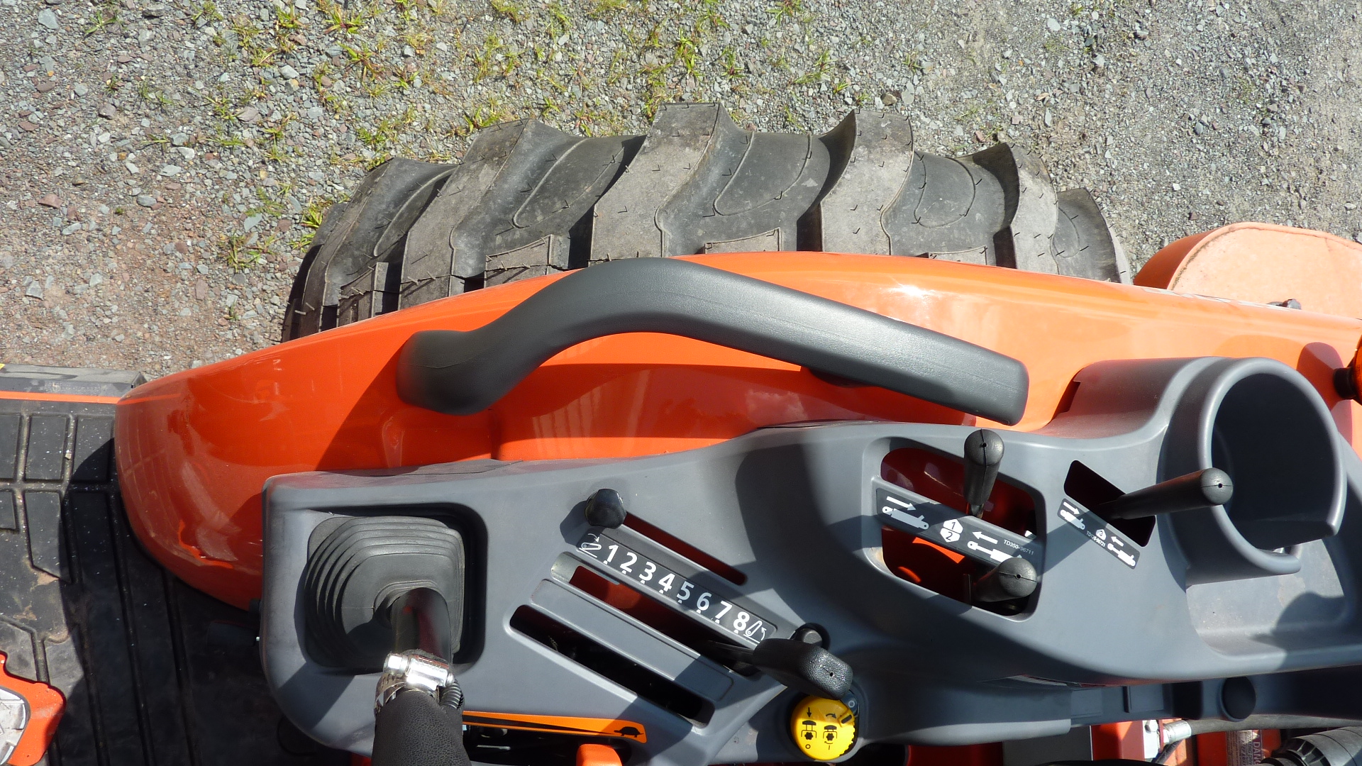

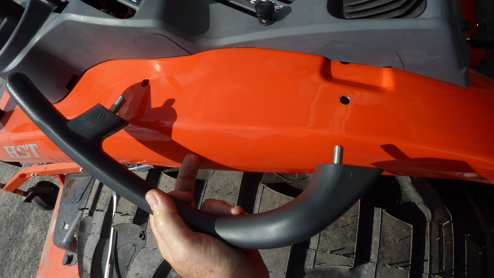

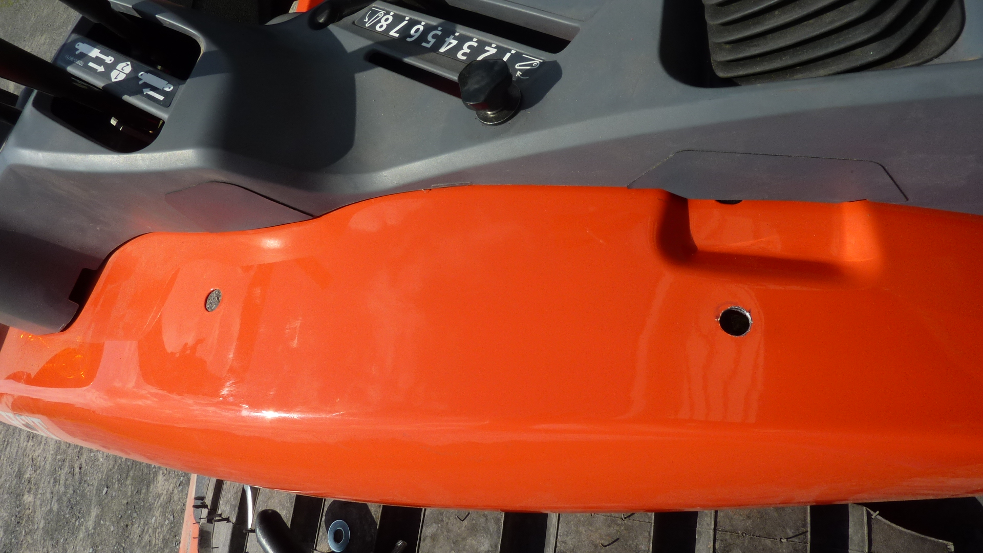

2 - There is no fender handle on the right side since it conflicts with the fender mounted console for the FEL joystick. (Not an issue with a cabbed model) For me, this was awkward since I use the handle when mounting the tractor and to steady myself when mowing a slope. The fix was to buy a right side handle from a MX5800 and mount it slightly out of alignment on the right fender:

I bought a right side handle from a smaller tractor of the same series for my L6060 ROPS. I was able to mount it in the pre-punched holes in proper alignment after a bit of trimming of the handle with a hack saw and file.
Handy, but it still needs a step on the right side.

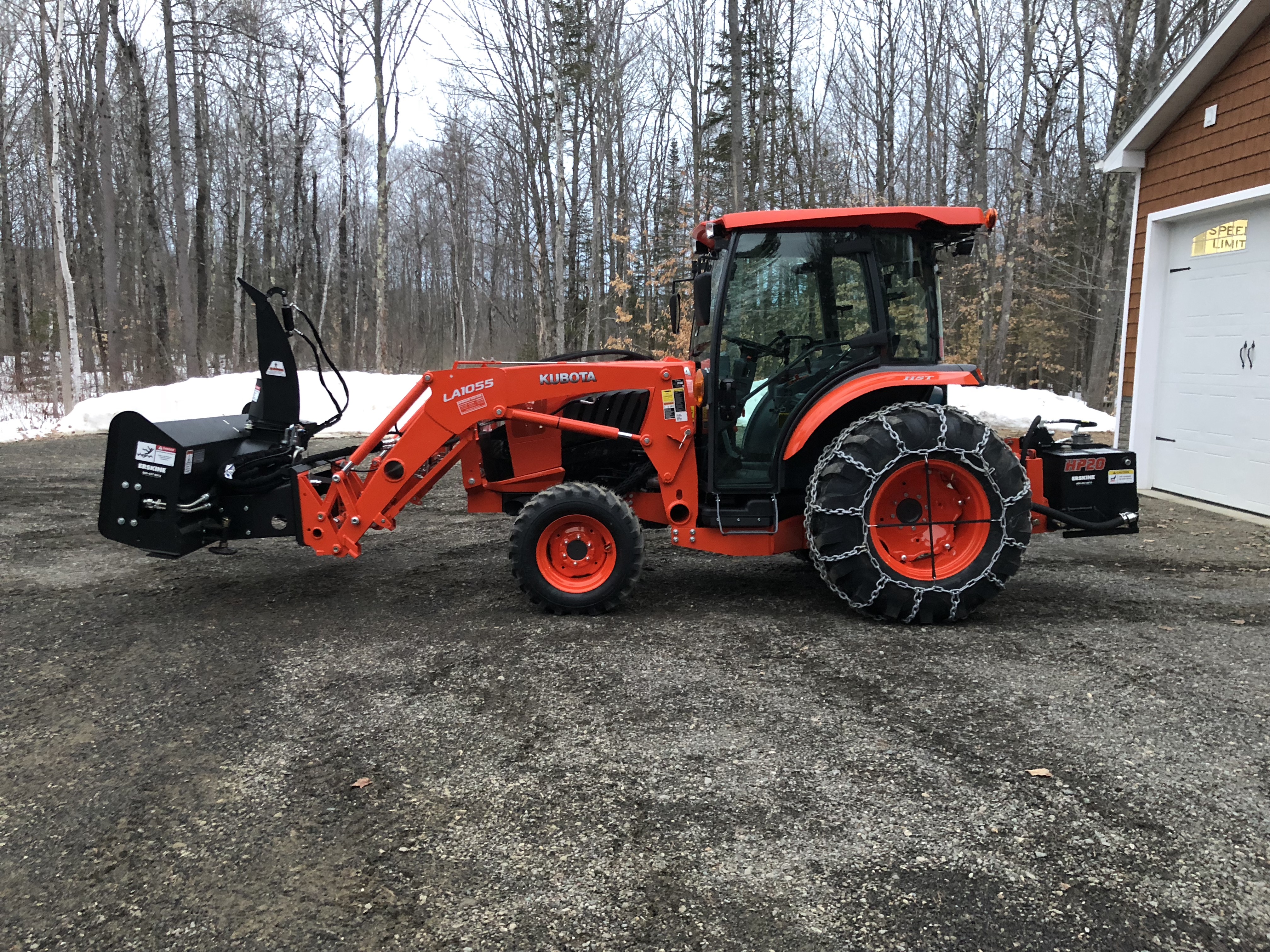

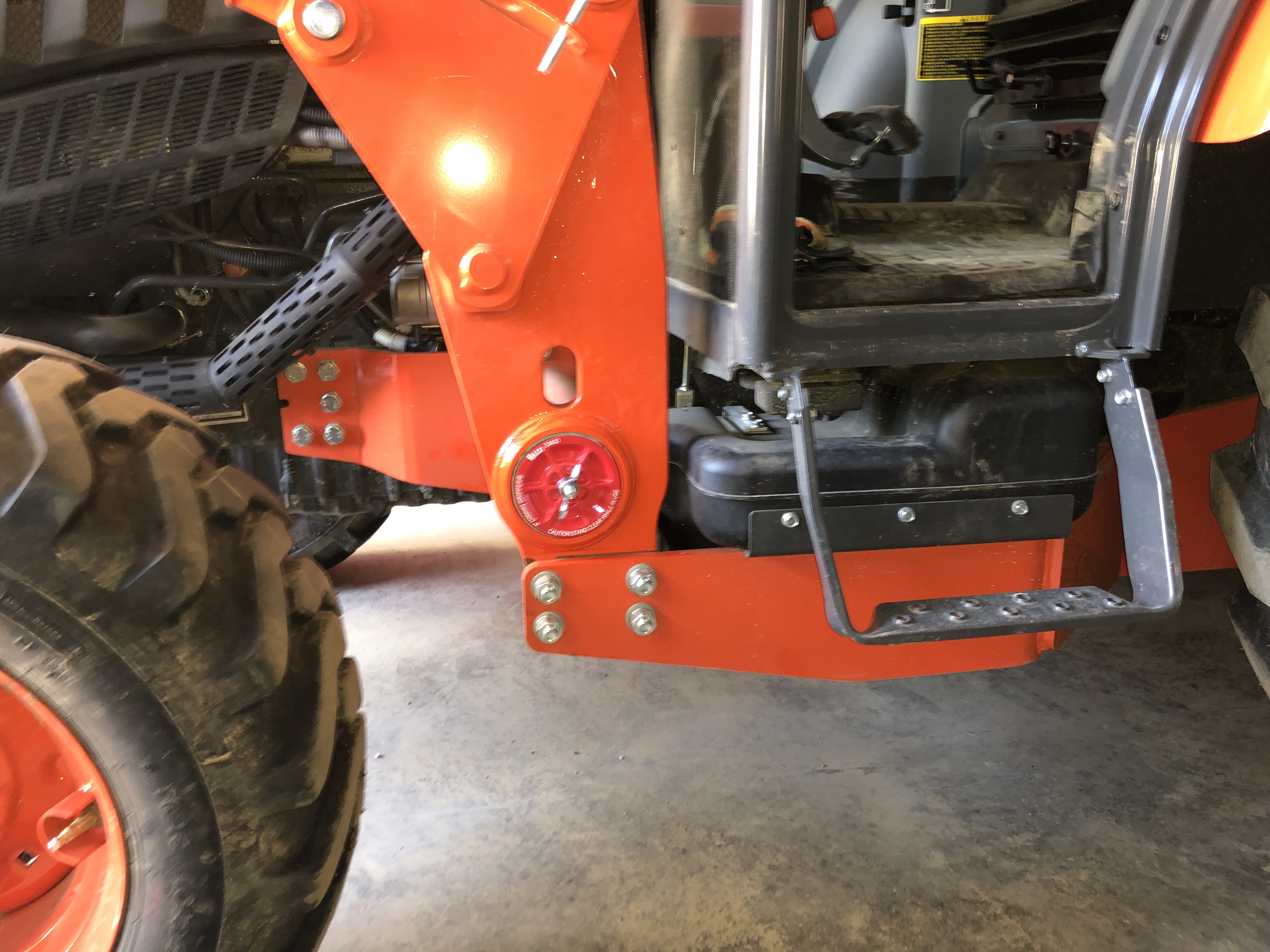

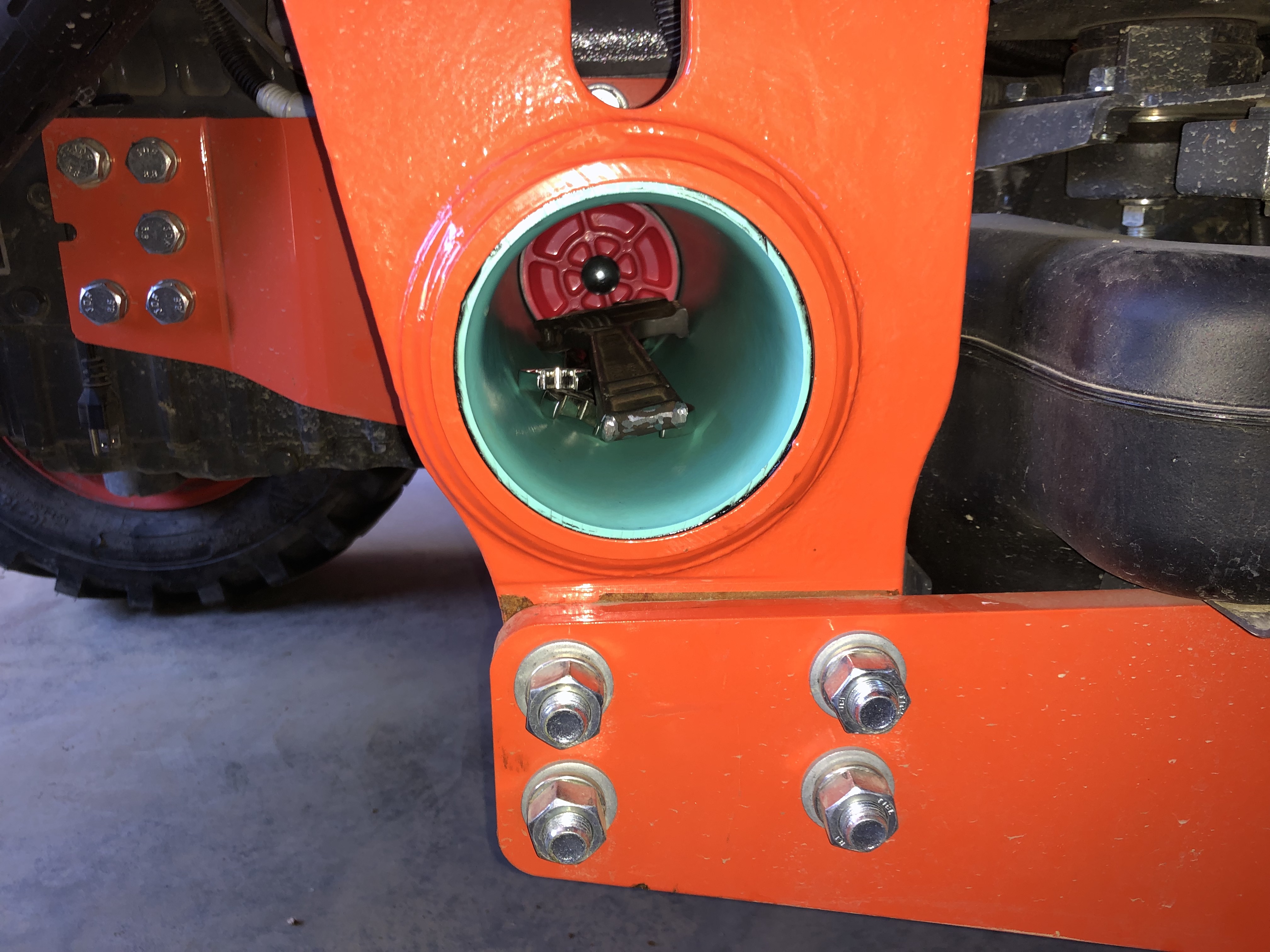

I got my Grand L6060 w/cab and back hoe about a year ago. I was replacing my JD 4310 w/ hoe. I went with the larger HP because I was getting a 79" hydraulic snow blower (Erskine). I do a lot of mowing, bush hogging, box blade or rock rake yard smoothing. The rear tires are loaded. Most every thing I do with this tractor doesn't work it at all. Except the snow blower that will exercise the turbo. It has about 160 hours on it and I like it more every time I use it. I took it to my business a week ago and moved the snow banks back, using a combo of snowblower and loader. There is a small (I call it a trash) can tool box beside the seat in the cab. I made tool box inside the loader frame tube to hold the tools it takes to remove the 3 point hitch arms and install the back hoe. So far no regrets going from JD to Kubota.

I need to revisit using the loader tubes for chain storage. I like your solution... what type of pipe is that, and does the expanding plug snug up inside a of the added pipe?
I looked for a plug last year, but couldn’t find a size that would work directly in the metal tube.
   / Anyone Own A L6060? #50
Lowes and Home Depot carry that same plug, $5 and change. ;)
