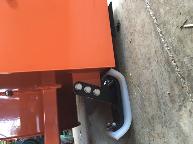

I also have the electrical controls. Very big motor and has worked well so far 0 degrees a few days ago. Only thing I did not like was no stops so could rotate forever and rip out my chute actuator wiring. Sure I could have wired up some limit switches but sawing off a few teeth do I have a dead spot when it’s aimed at the back of my head has worked great. Better to give it a nudge to re-engage the teeth than rewire every oops. As said very impressive build quality 32F97F6A-CB32-4825-81AE-D28806B32127.jpeg129AD770-299F-42D7-9F1B-25EAA39A278A.jpeg7AA637AA-B02A-429A-B222-46262ACAB0CC.jpeg6CD53ACC-6B85-44C6-B2D4-1E4F8962F2C6.jpegand new skid feet are 2x wider.
