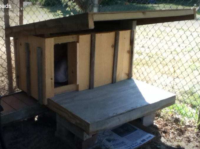

I sure would like to learn some type of cad, but Me & computers........
imgres.jpgmore my speed :laughing:, "wireless" as well.

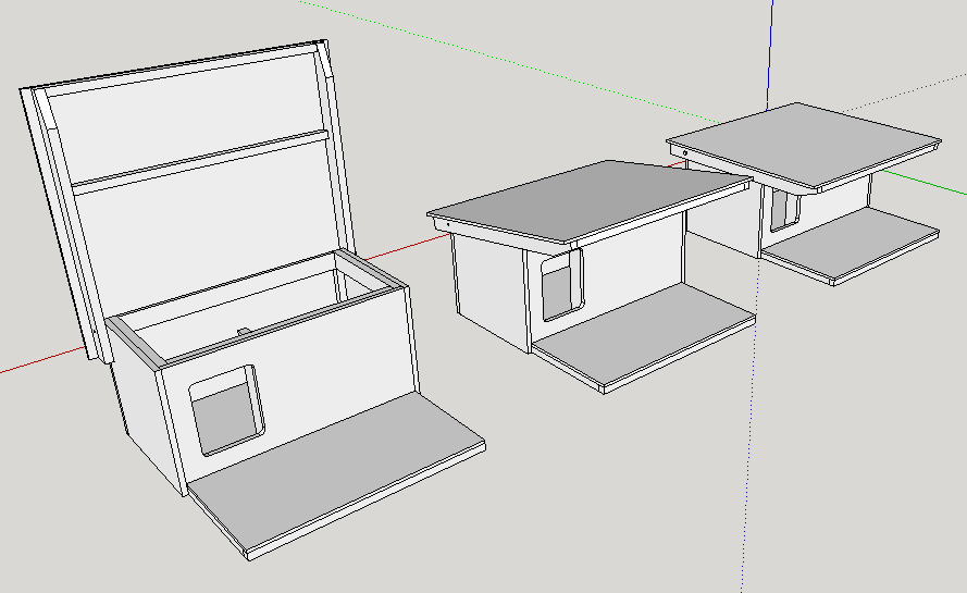

I use sketchup for every large project, as well as some small ones. I laid out some picture frames quickly for some custom prints my wife ordered. It made cutting and sizing the stock very easy.
I agree with learning to use components...it is a great tool. You will learn the shortcut keys quickly too so you can go from moving an object, to orbiting around, to drawing, etc, very quickly.

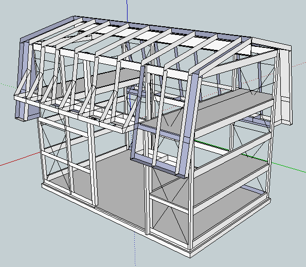

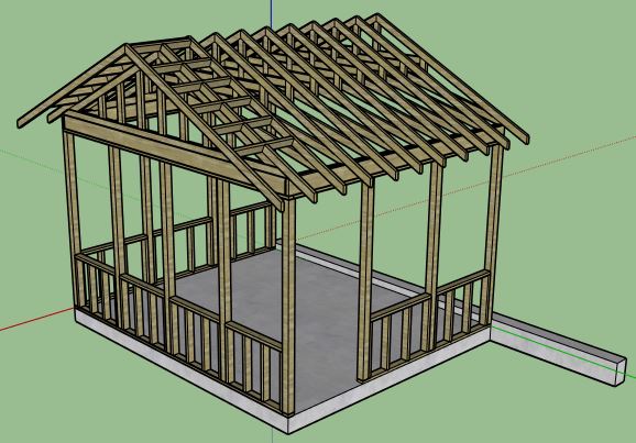

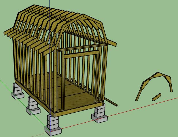

Some of the larger projects I planned in sketchup
Shed plans:

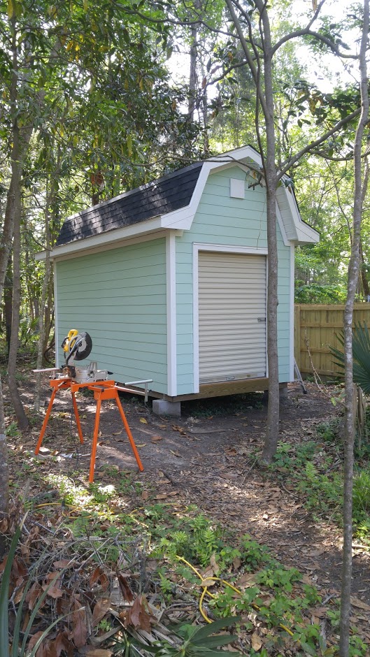

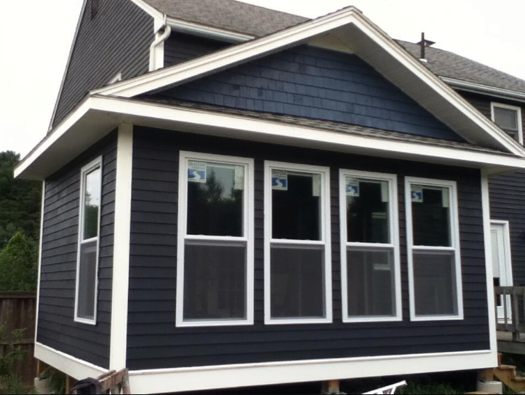

Complete shed:

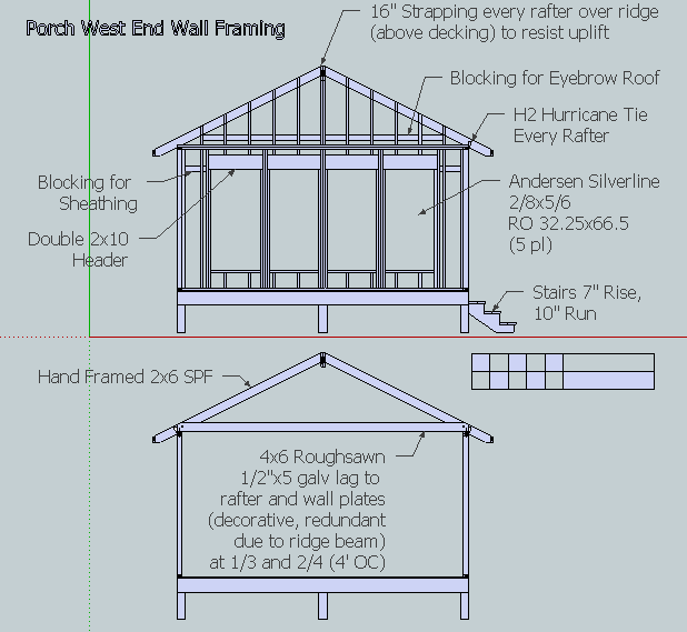

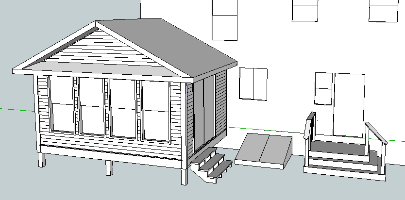

Porch Plans:

Thanks to both of you for posting your sketches and the finished product. You can really get an idea what it is going to look like from the sketch.
The permit process is what brought me into this software to begin with (for my nephew). When I lived in Clear-water county I put an addition on my house similar to your sketch, no permits required, now from what i understand I will need a permit to put up a chicken coop, go figure.
