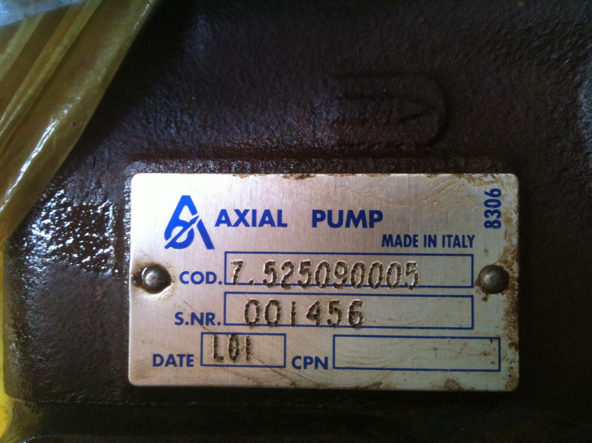

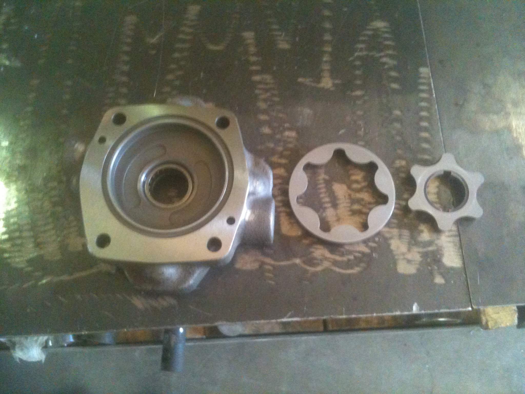

Hello everyone ! I have an Ingersoll rand BL 370 (same as Bobcat b 350), I run into trouble with the axial pump. (made in Italy)See pictures attchd. Machine looses traction when hot. Very hard to get parts for it .
please ,any help will be appreciated. Thanx.

Have you tried a Bobcat dealer? How many hours on machine? Is there a Bobcat dealer near you?

bobcat dealer in toronto told me they cant get the parts for my ingersoll rand bl370 any other sugestions????

Toronto being a major city perhaps someone local could rebuild the pump for you. or recognize the pump manufacturer so you could get parts directly from them. good luck

Did anyone ever find a solution to this issue - as I have the same, i.e. need parts or replacement for Hydrostatic pump, with Tag "Axial Pump, Made in Italy". It would be great to know if you found out who made this pump and if and where parts or replacement can be found. Bobcat is offering a replacement for $5000!
The local hydraulic pump rebuilders are hesitant to take the pump apart without some source for parts or even a seal kit. I have been digging around and I suspect it was made by HP Pumps Italy, which I think has been consumed into bondioli-pavesi...which I hope to find a US distributor for.
Any help is appreciated. I will the solution to this issue once I find it.
Thanks, Greg
