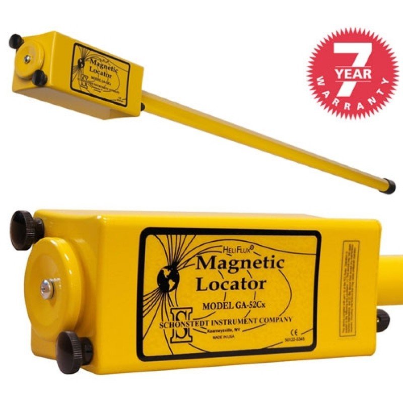

At very least, go to your local rental place and rent a REAL metal detector, something like this:
A big fabric or steel tape measure on a reel (at least 100' long) and a compass app on your phone should get you close enough to find the pins with the metal detector.

I used to have a Schonstedt but don't anymore.
If I have the distance and bearing I have the tools to calculate and locate the point within an inch. I just am not sure on the bearing.
