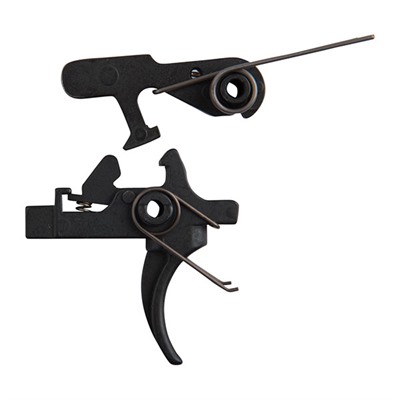

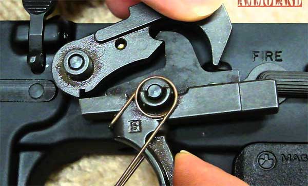

Eddie, try to avoid any AR that has the original milspec trigger. The reason why I say that is because AR15 trigger upgrades are expensive. Most of the options are over $200 for a trigger upgrade. That is a lot of money when you spent $650 to $850 for the basic rifle.
Anything that has a modern 2 stage trigger with the new sear position is the way to go. Cheaper if you get it right the first time.
Mil-Spec-Factory-Trigger.jpg This is the original (heavy gritty, creepy) trigger
p_739000011_2.jpg This is a "modern" trigger with the sear at a considerably larger working radius. Costs no more to make but expensive to buy if you first get the "lowest common denominator"

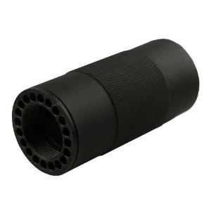

In addition, it is advisable to get a free floated handguard so that accurate shooting is possible. Just an aluminum tube is fine, does not need to be fancy or be covered with cheese grater rails.
