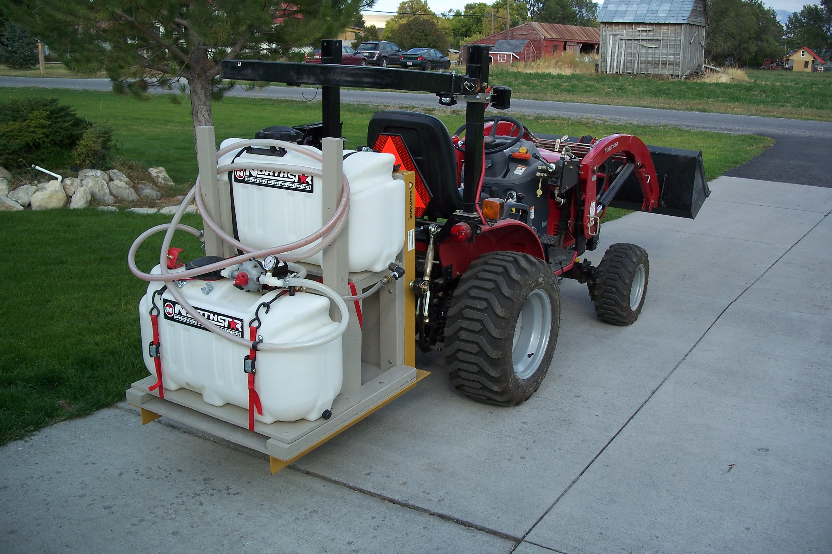

I've got the 002 SN for 2015 for the EMAX22G. I've got around 186 hours on it and I have enjoyed it. I used the loader a lot the first year and found the problem with the bucket, dealer sent out the new re-engineered bucket and I think it will last the life of the tractor. The dealer fixed the fuel tank, and I've got the latest muffler coming under warranty. Haven't had a problem with the solenoid yet, but will watch for that.
I have a small orchard of 25 apple trees (do lots of cider) and use it to spray my trees and other stuff around my 1 1/3 acre place. Oddly, my favorite implement cost the least. I picked up a pair of clamp on pallet forks from Titan for $90 w/free shipping (tell me how you can ship 100 lbs of steel for free). I use them to haul branches and pick up lots of other stuff.
I appreciated your thoughts on the original engine. I wanted a tractor that would last me the next 20 years. :)
