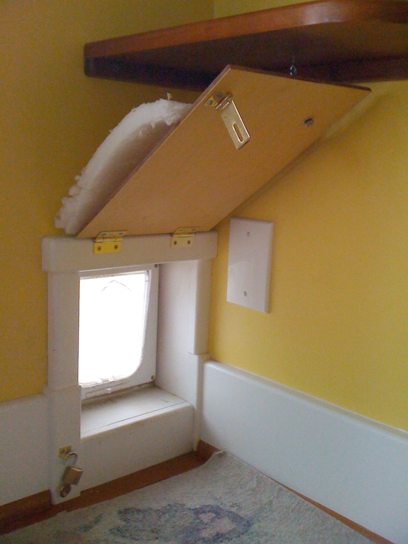

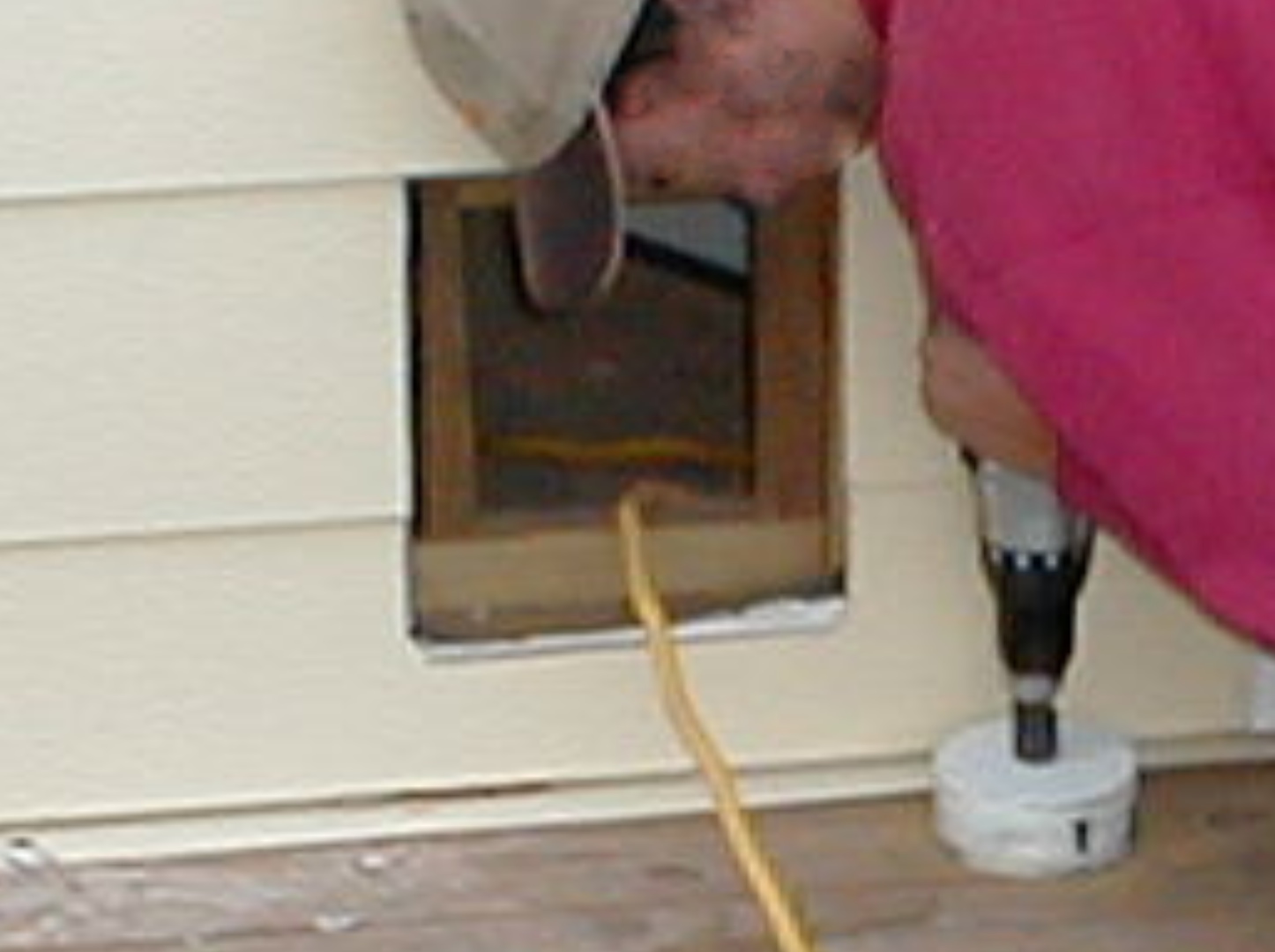

We have built-in cat doors in our house. We have two decks, a screened in deck and a open deck. Neither has steps going down to ground level. The screened in deck cat door is available all the time. The one to the open deck has a little swing door I made that can be locked. It is closed at night. You can see the little padlock for it in the picture, those cats are crafty (but we can leave the key in the lock :laughing:). The white foam is for insulation and to keep the wind and rain from blowing the door in (and getting things wet) when the door is locked.

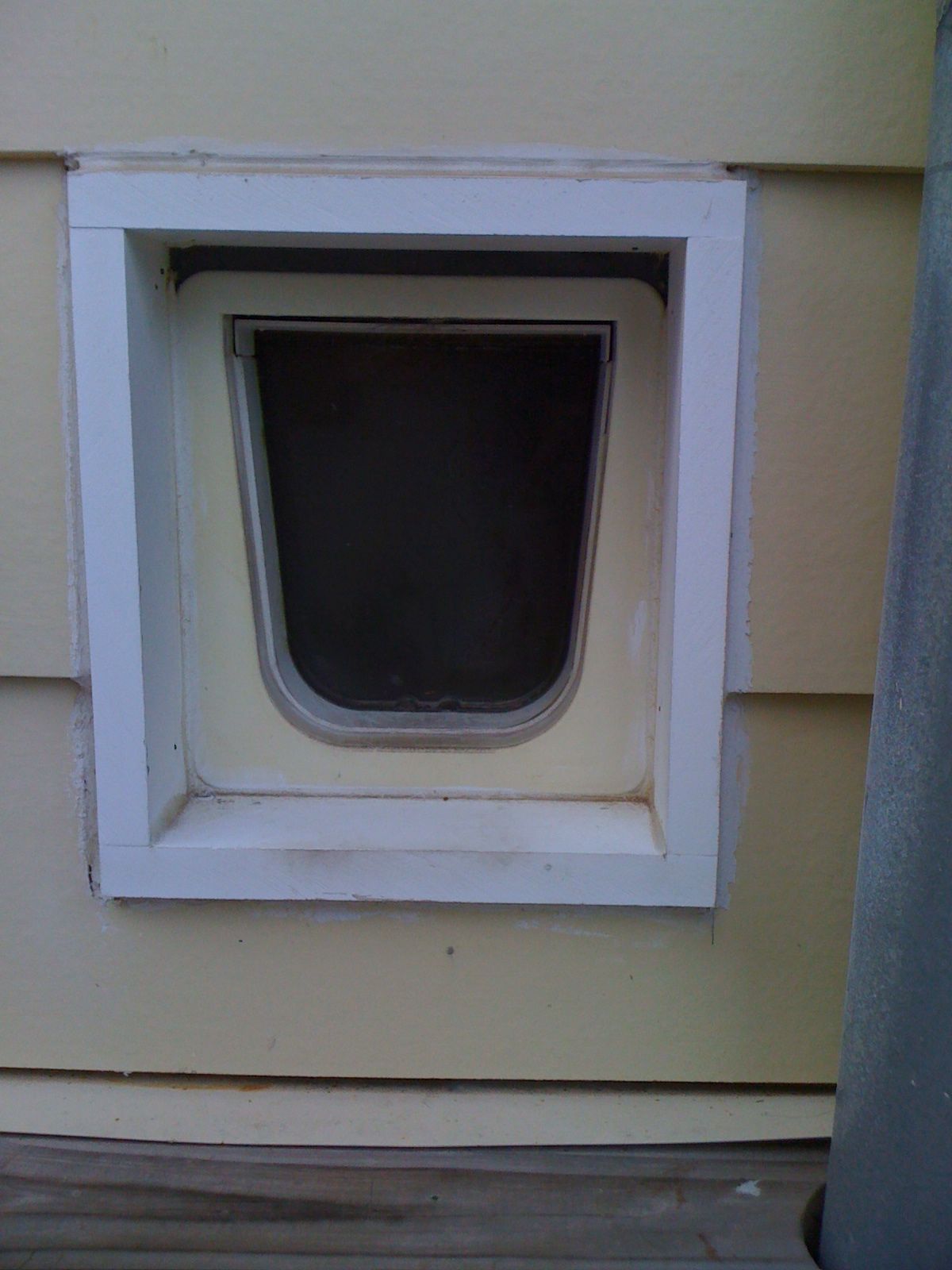

There is also a pictures of that door from the outside, and a bad close up of how it is framed. Basically, we framed with 2x4's. We bought two brands of doors and make the size such that the door can be changed out without having to re-do the trim for the door. Caulk fills in the little gaps. So the door can be replaced without ripping up any trim.
The covered box by the cat door has a cat-5 that will someday go to electronics I'll be making. I'll design a 130 KHz loop antenae that is in the trim around the door, and run an RF ID so we know which cat is using the door. (quick home automation digression)

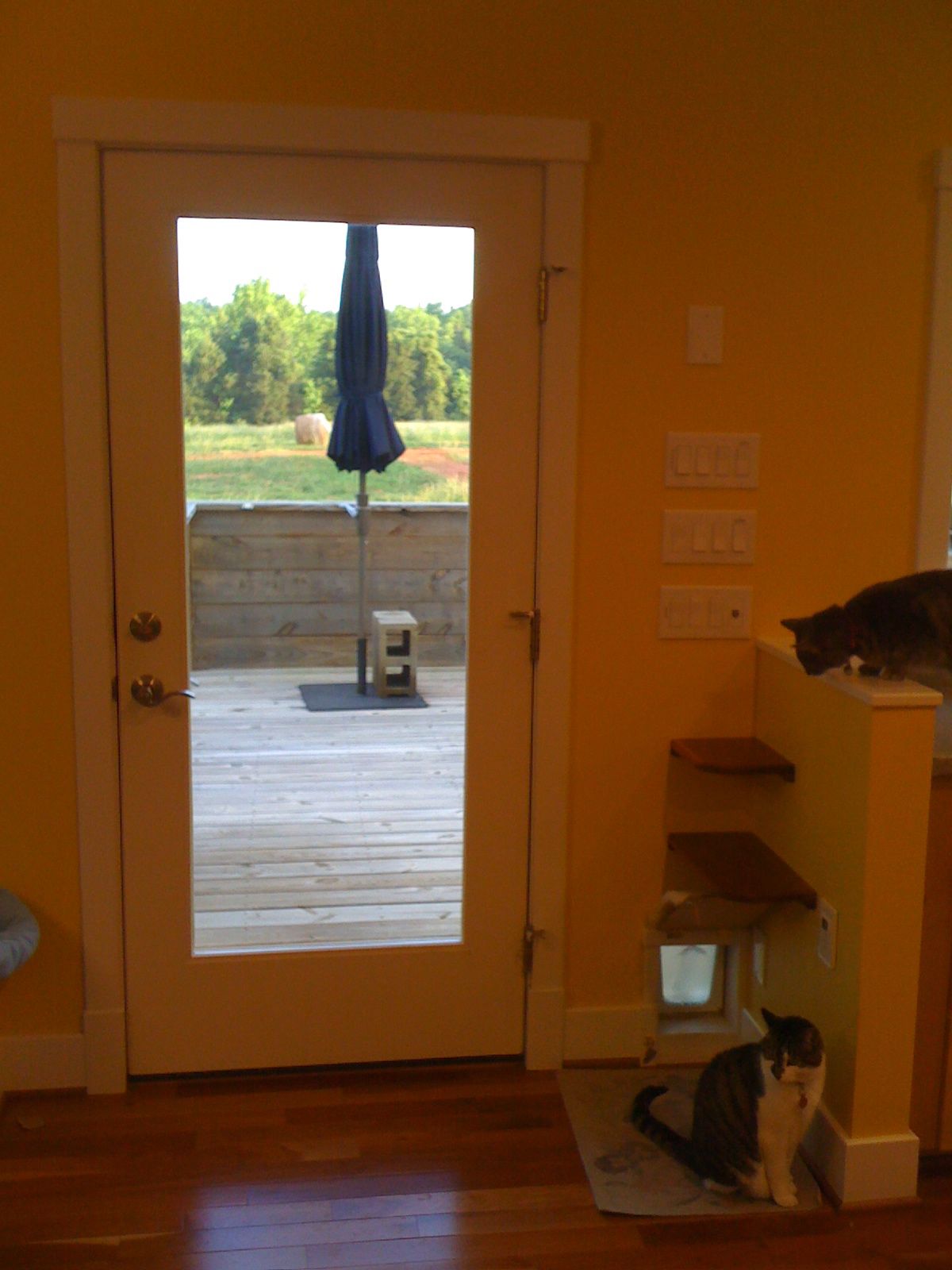

The bigger view of the door (the one that include cats that were curious as to what I was doing) shows why we did the doors separate. We wanted the full view window doors (Full Light Door). The cats like them too- they can sit and watch the outdoors. The "shelves" are cat steps. If we put a block at the bottom, when they get old they can still climb up to that one counter.

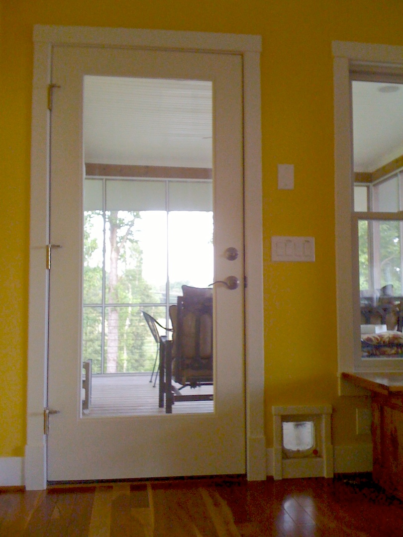

There is also a shot to the screened in deck door (you can tell the deck is covered and see the cross pieces for the screening). Again, the build in door make the people door very nice. Another box for RF ID. This approach is spousal approved and the big door - little door gets a very high "cute" rating from the same judge.

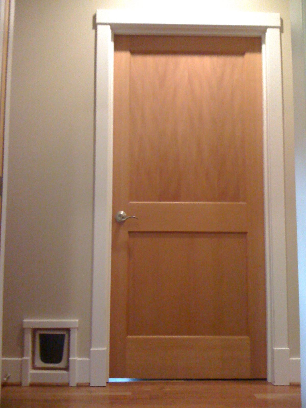

Finally, there is a shot of the people and cat door into the snoratorium. There is a similar set into the master bedroom. This lets the cats rome around at night while maintaining the sound isolation of the snoratorium (used in the unluckily event of snoring). Again, the big and little doors rate very high on the spousal approval scale (as does the snoratorium). The cost of triming the cat door is _more_ than the people door :confused2:. Exact same cuts, but the smaller pieces make it difficult and there has to be some trim wood put in (whereas the people door the trim is part of the door). The 2x4's are thinner than the wall, so the box has to framed out. Can't find a picture of a door before framing, I'll keep looking.

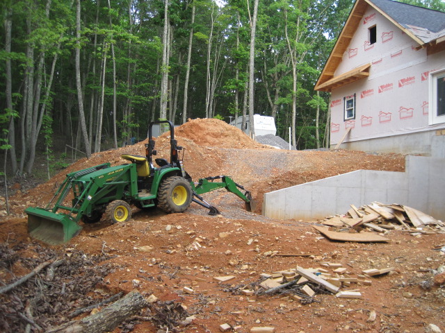

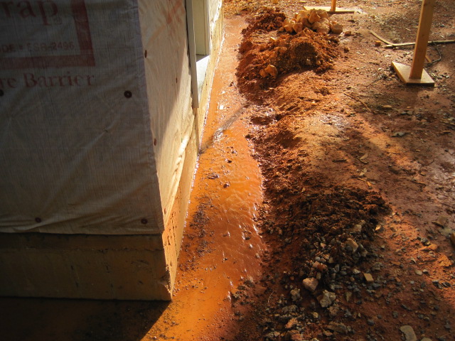

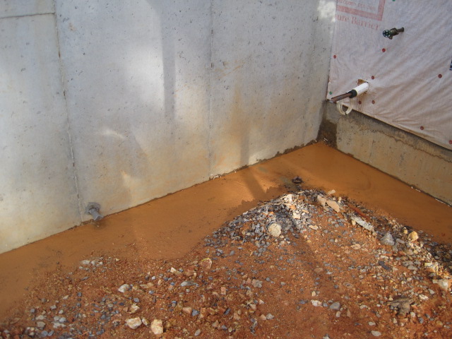

Mud Mud Mud!
Last week I finished cleaning the footers in preparation for the brick installation. Then we got an incredibly heavy rain on Monday.
attachment.php
Our footers got covered with mud again. When it happened the first time after the rains that flooded Nashville, I figured that was an anomoly. But less than 2 weeks later, we got another unbelievable downpour. Now I'm back to the drawing board.
I'm in this circular loop. It's like a bad movie. The footers are lower than the surrounding dirt. I can't backfill the footers to make water run away from the house until the brick is laid. We won't get the rain gutters installed until after the brick is 1st installed, and after the soffits are installed. But everytime I clean the mud off the footers, it rains and covers them with mud again.

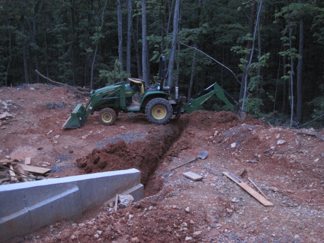

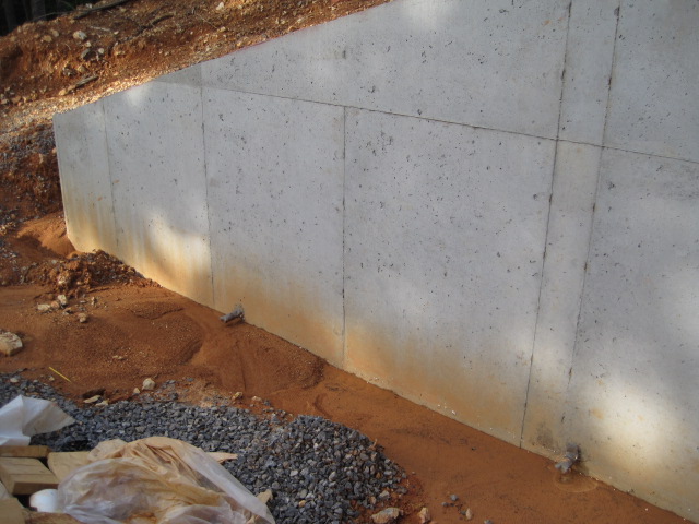

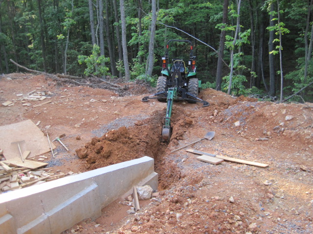

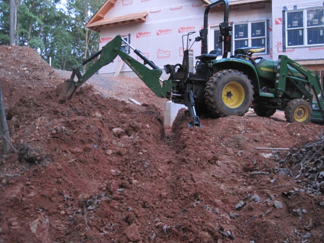

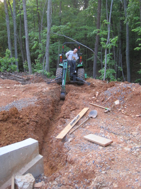

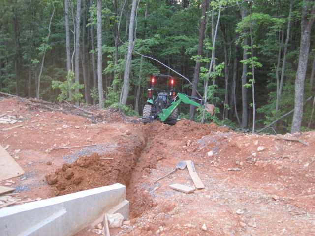

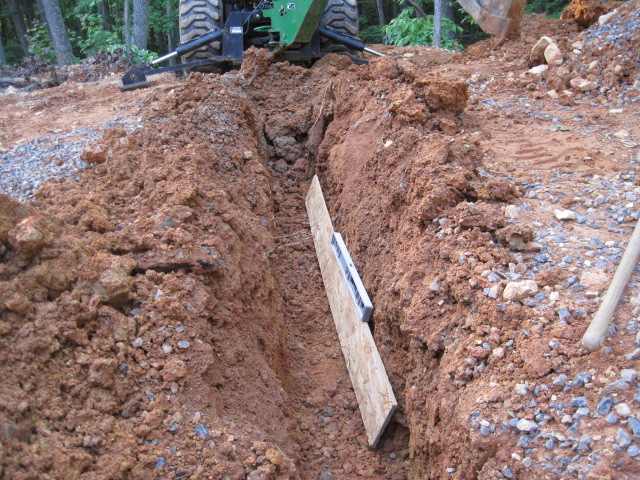

It became obvious that I need to give the water a path to drain away from the footers.
attachment.php
So this evening after work I dug a trench. After the brick is laid, I will put a drain tile beside the retaining wall and will put a drain pipe in the trench to drain the water that gets into the drain tile. I put a level on a board to measure the slope to make sure I get at least a 1/4" per foot drop. My level has a mark etched into the glass that shows the 1/4" per foot drop.

I had to dig and clean off the footers for our garage 4 times during construction before the block was placed there. Ditch looks good, I think you've got control of this drainage problem even if no one can control the weather.
