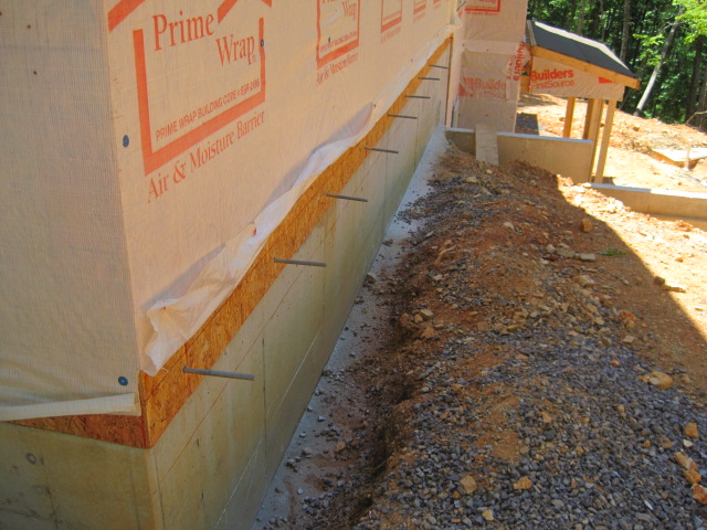

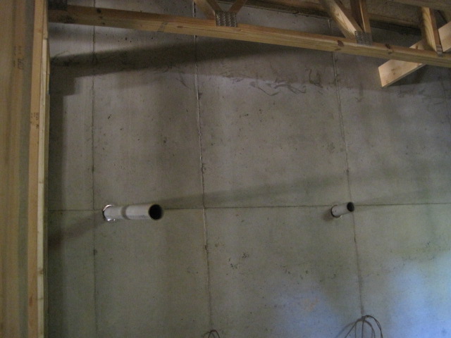

Here are the bolts that will attach a ledger board to the house. The ledger board will be used to attach the back porch floor and deck to the house.
attachment.php
What is not apparrent in the picture is there will be another row of bolts below the existing bolts. The existing bolts are attached to the framing. The lower row will be attached to the concrete foundation wall. The holes have already been drilled in the concrete.

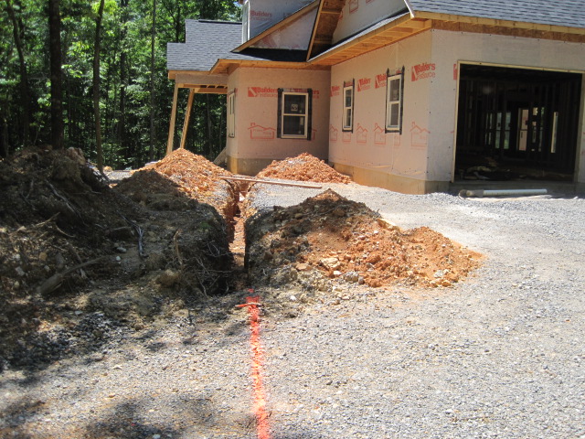

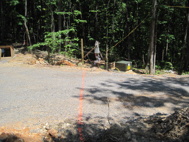

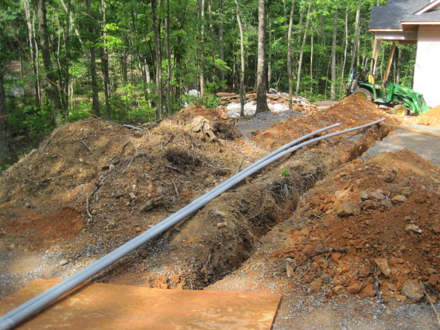

Trench for Electrical Conduit
This weekend I worked on the last portion of the electrical trench between the electrical pedestal and the house.
attachment.php
I layed out with some orange paint the line that will connect the two ends of the trench that I had dug a few weeks ago. Timing for doing this portion has been a little dicey because we can't get supplies to the house while the trench is opened across the driveway. Now seemed to be a good time to finish the trench.

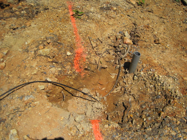

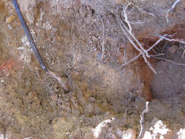

Solving the phone delimna made gave me a little more confidence about digging around this phone cable.
attachment.php
You can see that my electrical trench needed to be dug right beside where the cable exits the ground. I dug a little around the phone cable by hand to get it about 3 inches away from where I would be digging the electrical trench.

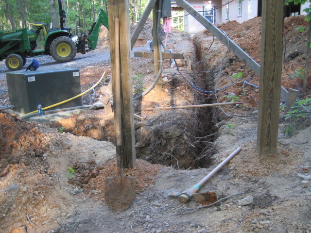

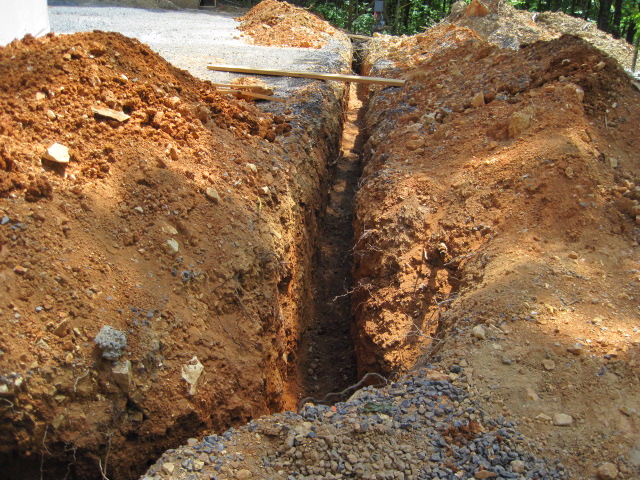

#1,285

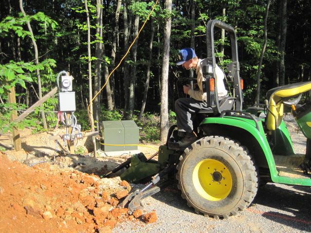

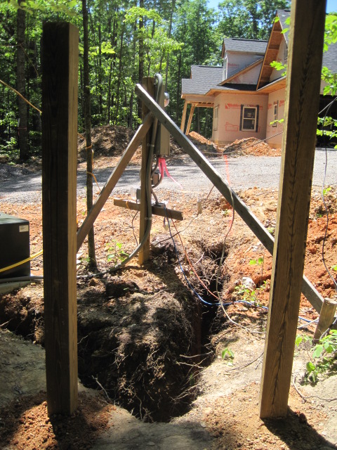

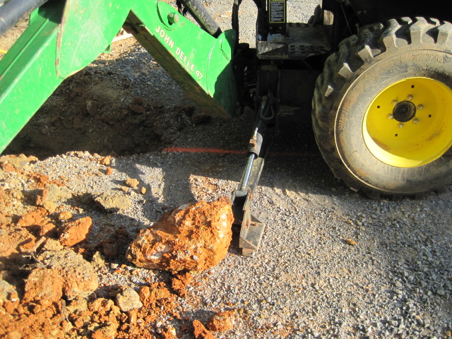

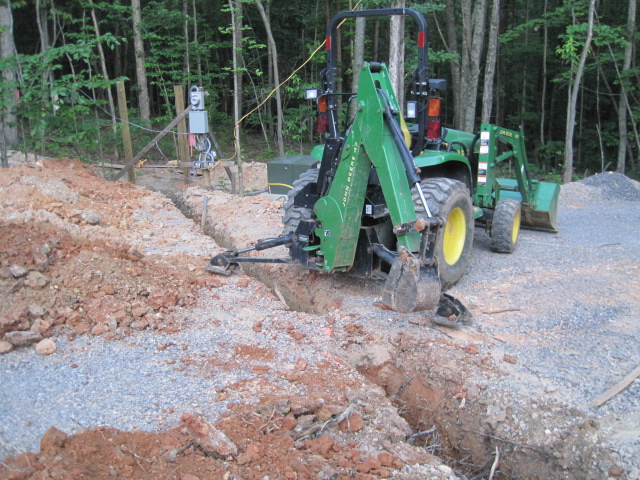

I dug this section about 5 feet deep so that the gas line can cross the electric line here.
attachment.php
You can see the yellow gas line sitting above ground beside the transformer in the background. I'm digging the trench with a 9" bucket; the trench turns out to be about 12" wide or less. A 5 foot deep trench that is so narrow is tough to work in. It's too narrow to climb into. Fine tuning the trench by hand is tough. To remove small rocks that fell into the trench, I would lower the end of a hoe down and pick up the rock. Or I would use a set of post hole diggers to reach down and pull out rocks.
This rock was about 18" across. I hit it about between 3 and 4 feet down. It took a very long time to get it out of the 12" wide trench.
To finish the trench in the middle of the driveway where the two trenches joined, I had to change my tractor angle to the trench. I could no longer dig with the backhoe pointed directly behind the tractor but had to angle the backhoe to the side. When I've dug from this sideways angle before, it was always very slow because I would dig a couple feet of trench, then have to drive the tractor away from the trench and resituate the tractor to dig the next couple of feet. Remaneauvering the tractor every 2 feet would take as much time to do as the actual digging if the trench was shallow.
However, I learned a new and very useful trick. I was able to use the backhoe to lift up the rear wheels of the tractor and move the backend of the tractor about 3 to 6 inches sideways. Every so often I would pull the tractor forward a few inches when my remaneuvering resulted in the backend of the tractor being too close to the trench. That's all I had to do to shuffle the tractor sideways down the trench. This maneuver saved me a bunch of time. In this picture I was digging on the right side and then moving the tractor to the left along the trench as described above.
Here are the pictures of the finished trench.

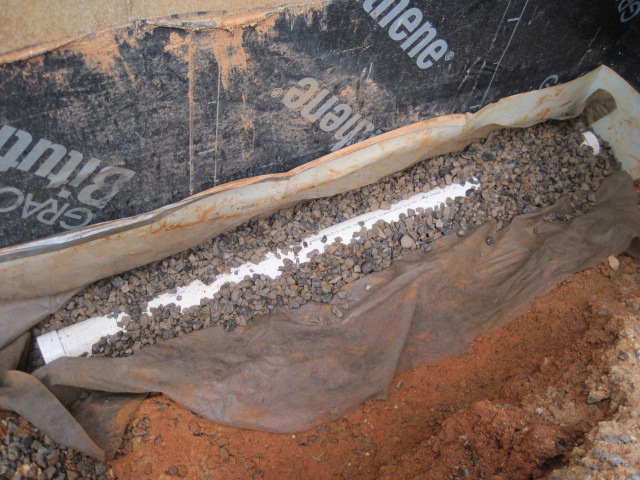

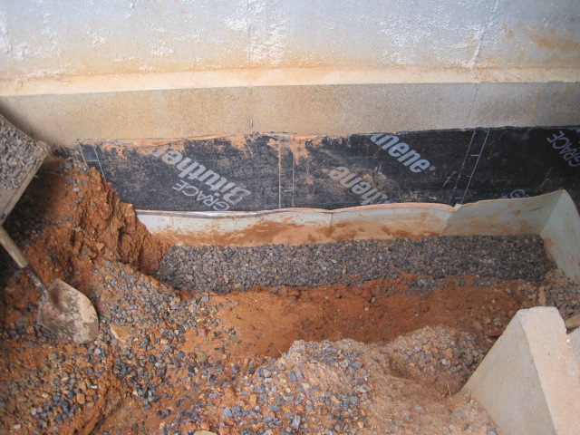

#1,286

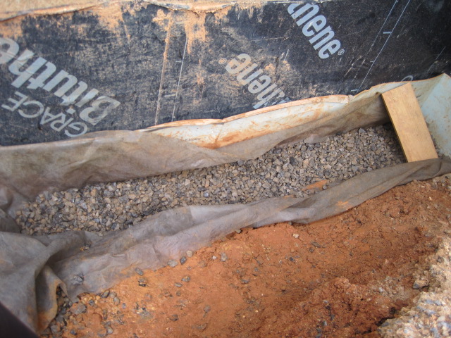

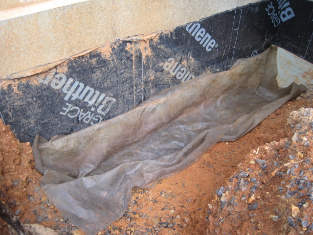

My wife re-installed the drain tile underneath the electrical access holes. This is the drain tile that I attempted to install and was 15 minutes away from completion when a the rain storms that flooded Nashville reached us an messed up my work.

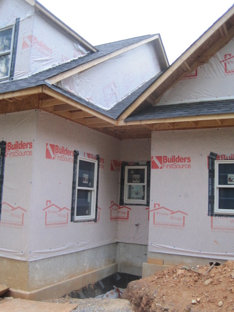

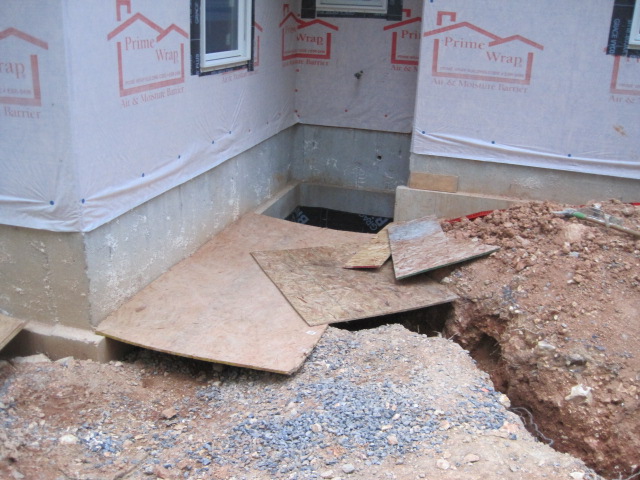

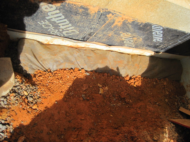

The valley between the garage roof and house roof funnels a lot of rain onto the area where the drain tile sits.
attachment.php
We took some steps to prevent the rain from ruining the drain tile work a second time.

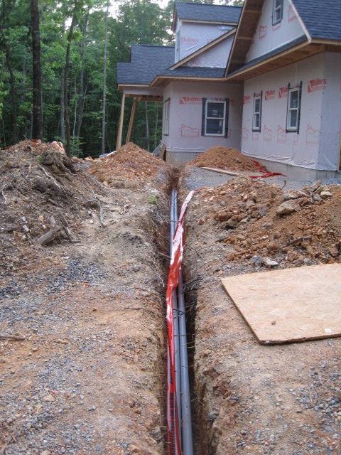

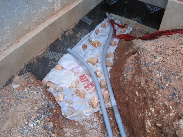

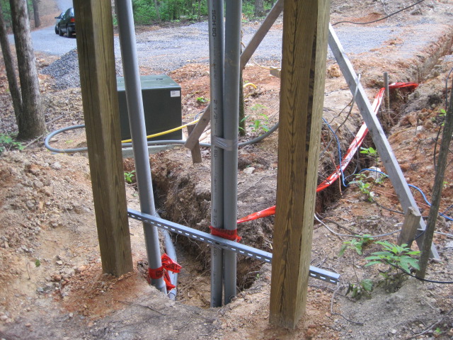

Electrical Conduit

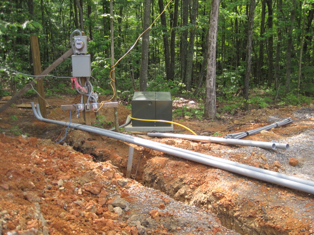

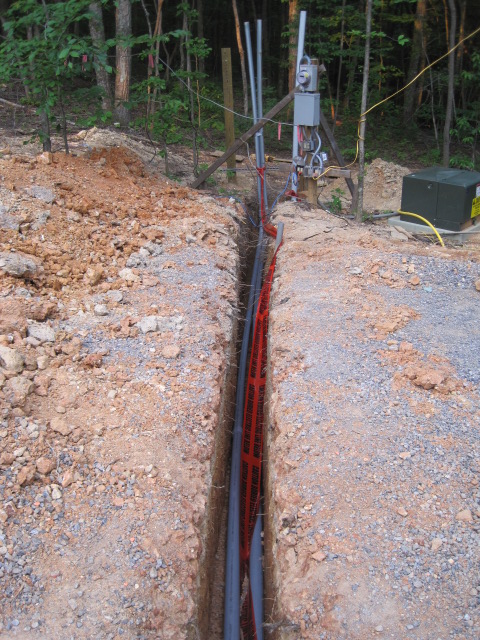

Electrical conduit got run this week between the transformer and the pedestal and between the pedestal and the house. The installers had a device that heated the PVC conduit so they could bend the conduit. The red plastic non-sticky tape will be placed in the trench a foot above the conduit. This tape is designed to warn future diggers that there is electrical wire in the ground below where they are digging.

   / At Home In The Woods #1,289
while that trench is open that crosses your driveway now is your chance to add one more piece of say 2 inch PVC so if in the future you want to run any wires to the other side of your driveway you will have a pipe in place.
   / At Home In The Woods #1,290
That is very true. Never know when you might want lighting, driveway alarm, electric gate or such. It is cheap to do now and expensive later.
