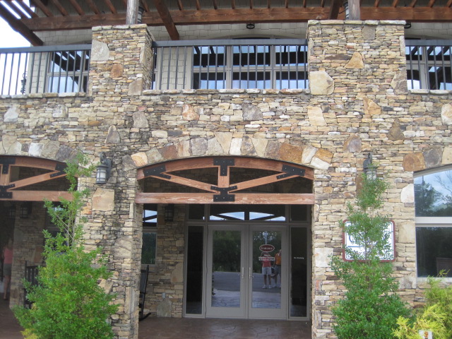

Today we went and looked at a stone mason's work. A club house he stoned with stacked stone is in the attached picture. We will have stone on the dining room in the front of the house. The stacked stone on our house will not be as rustic looking as that in the picture. We had some trouble finding masons near Knoxville who will lay real stacked stone. Most of the stone masons near the city only lay the fake stone. We had get farther away from town to find people who have experience laying real stone.
