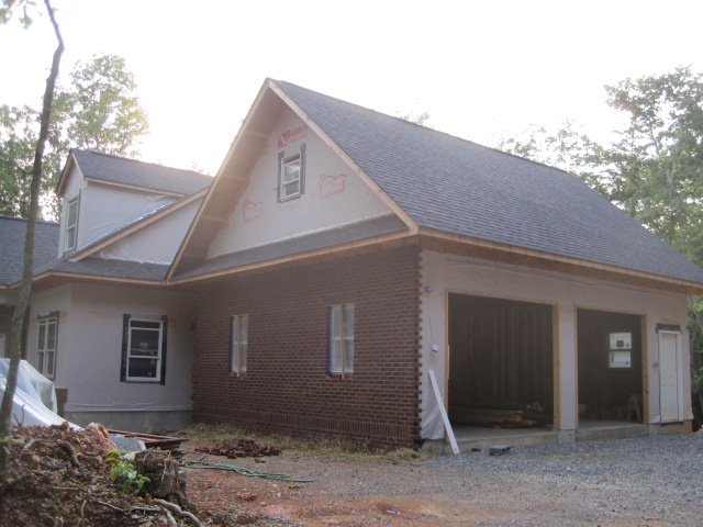

A little more brick was put on the back of the house today. They apparrently got stopped by rain. The new brick on the house is covered with plastic. Here's the brick on the front of the garage without the scaffolding in the way of the view.
