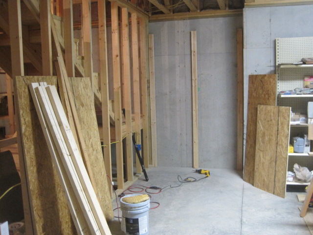

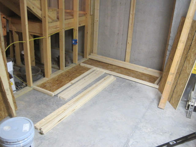

My wife attached one 2x4 to the concrete wall yesterday before her masonry bit broke. Today I continued where she left off. I attached the two remaining 2x4s to the wall. I have to say I was a bit apprehensive about screwing the 2x4s to the poured concrete wall. I've never done it. I remember the subs mentioning using Tapcon screws when we built the house. So we bought some and using them was actually pretty easy. Using a new masonry bit, I set the drill on hammer and had no problem drilling the holes and screwing the boards to the concrete. We put pressure treated spacers between the 2x4s and the concrete to keep the untreated wood off the concrete.

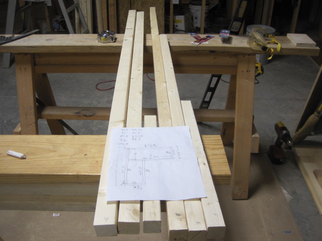

The shelves we are building now are more complicated than the first set of shelves. These shelves are in a corner whereas the other shelves were on a straight wakk. I admit I scratched my head for a while getting a plan together for how to build the frame for the shelves. I eventually put down a plan on paper. I cut the frame boards for the first shelf. I then laid them all out on the floor to make sure all the measurements worked right. On board was 1/4 too short so I modified my drawing accordingly. I then started cutting boards. I labeled each board A, B, C, D, E, F as I cut them to simplify assembling them.

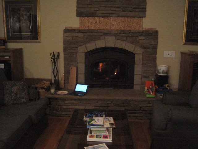

We've had a warm spell so we haven't burned a fire in the fireplace the past few days. However, it's getting colder again so we started a fire tonight. I'm sitting by the fire now as I type this message. There's no substitute for a nice warm fire. To top it off, I'm eating some cookies and drinking eggnog. Life is good!
