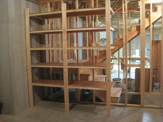

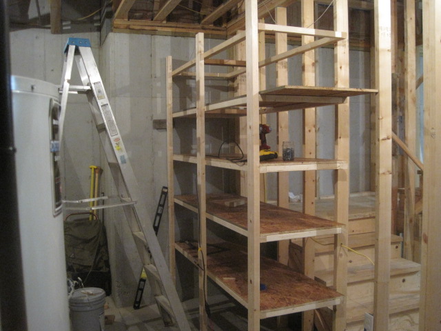

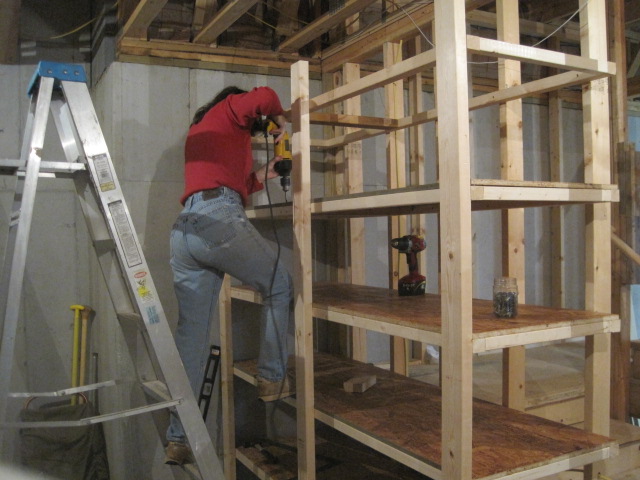

My wife installed the OSB on the shelves today. It's great having a wife who can cook and is also handy with power tools!
You can see our cordless drill sitting on the shelf. The reason we primarilly used the corded drill for screwing is because high torque use drains the batteries pretty fast. However, the cordless drill has a clutch which can prevent stripping the screws, unlike the corded drill. My wife shoved a wedge against the concrete wall to square the shelves while she screwed down the OSB.
attachment.php

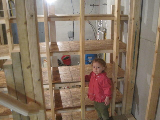

I love the shelves. I think they came out great! My wife designed them with some input from me. She really deserves the credit for them. One particularly nice feature is that we can access the higher shelves from the stairway landing. My little girl is showing you how easy they are to reach from the landing.
One shelving unit is now complete. We have two more sets of shelves to build on the other side of the stairwell.
