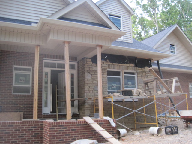

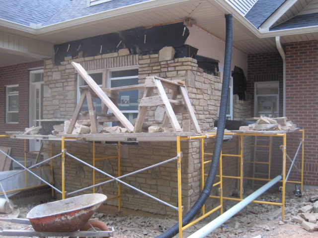

Here are the latest pictures of the stone work.
The stone mason was sick most of last week and didn't get much done last week. He worked today. He has been extremely accomodating. He did the soldering over the dining room window today and asked my wife if she liked it. If she didn't like it, he would have been willing to redo it to her satisfaction. We haven't yet hired anyone to do the cultured stonework for the living room fireplace. There is a good chance we will use the same guy because we like his work and his desire to please us.
