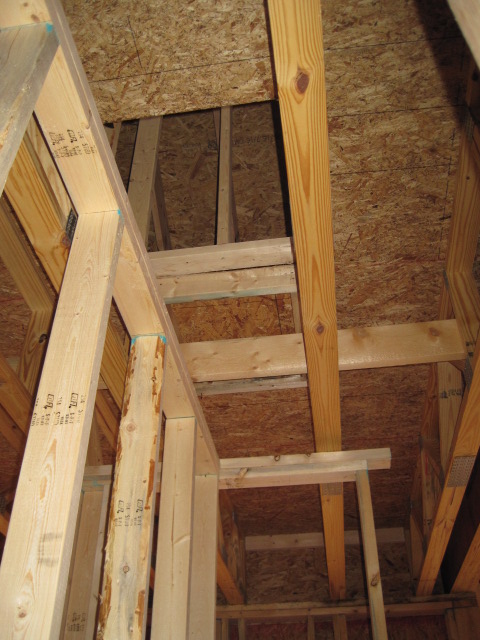

In one of the pics, it shows a 2x4 interior wall meeting a 2x6 exterior wall - if I am seeing it right.
It seems counter-intuitive to me that cutting a notch in the 2x6 top plate to overlap the 2x4 top plate will result in a stronger structure. My backyard engineering sense is saying you are giving up more than you are gaining because it creates a single plate 'hinge' point in the top plate of the 2x6 exterior wall. Whatever stiffness is given up by cutting the 2x6 plate has to made up for by the lateral strength of the interior wall. Depending on what/where the interior wall goes to, that could be good or bad.
Maybe tying them together with a piece of 2x8 would add strength, piece of mind and provide corner nailing in the ceilings.
Of course, my backyard engineering sense has been wrong before. :)

Imagine wall that is just standing there on it's own without any support. Then add corners to that wall and see how much stronger it becomes. now add another wall in the middle and see how much stronger it becomes. This is all very obvious.
Not take those walls and nail them together through their verticle studs. The wall becomes evern stronger to allot of movement, but with movement, that wall will also work itself loose. The further you go up that wall, the more movement that you have. The foundation isn't moving, it's solid. The wall is attached to the foundation with bolts, and the bottom of that wall is just as solid as the foundations.
Now the trick is to make the wall as strong as possible as high as possible. The simple act of overlapping your top plates will lock the walls together in such a way that they cannot work themselves loose when the house moves. All houses move, it's something that never stops happening.
In CA, where earthquakes are common and homes move more then homes in most other places, metal straps are run from inside the foundation to the tops of the top plates. That has since chaged to the tops of the rafters to hold it all down and tight.
With the overlapping top plates, you are locking the walls together like you do when playing with legos or building with cinder blocks.
The strength increase is significant. Anybody who does not build this way doesn't know what he's doing, or is in such a hurry that he doesn't care. If you look at 1,000 houses, you will never see this done any other way. It's the most basic part of framing. Not doing it doesn't make any sense, except for speed of doing the walls on the ground, lifting them into position and moving on to the next wall. It's faster to do it wrong, but not stronger.
Adding the top plates to the walls after they are up isn't very hard to do and in most cases, something you have the rookie to do keep him busy and to have something that's just about impossible to screw up. I remember getting that job before I was in High School, so that should give you an idea of how basic it is.

At this stage of framing, it shouldn't be a big deal to do what Eddie is suggesting, and there's bound to be a pile of cut lumber available on site to do it with unless someone has been very busy getting rid of it.
   / At Home In The Woods #924
At this point some sort of metal plate or strap might be on option. I think simpson makes a code - compliant connector.

Thank you Eddie. I can see if the interior walls are all locked together, and with the corners in them too, it will stiffen up the entire framing.

Also if you were to calculate the small amount of time saved doing it the quick and dirty way and than total up the time for the retro fit repair to try to bring back some strength, there would be no savings in time at all.

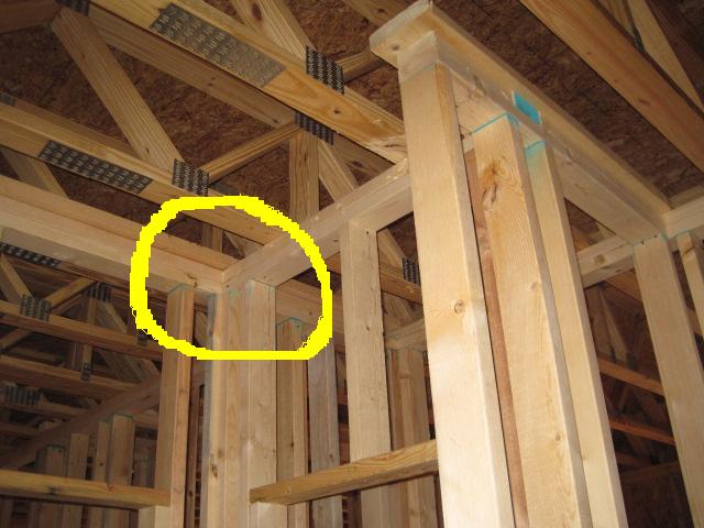

The framer has built several interior walls. I noticed some spots at the wall intersections that the double top-plates do not overlap but the dead wood is used to do the overlapping. Is this ok? If it is not ok, what issues will it cause?
Thanks, Obed
Are these interior walls in the basement or above ground floors? It looks like these interior walls are built after the trusses are placed on the load bearing walls, such as maybe a closet wall or something, the first picture doesn't look like you could cut the top plate out to overlap. At least with the deeper trusses there should be room to nail an overlap if the wall is in between, and the 2nd picture shows the drywall backer overlapping.

Intersecting wall that is tied together by only 1" of dead wood
The earlier pictures of the non-overlapping top plates that I posted a few days ago were not the worse examples. This message shows how the master bath walls were tied to the intersecting wall using only the 1" overlap of the 2x6 dead wood. The sloppy construction of the top plates was the final straw for me. Yesterday the construction manager/framer's contract was terminated. We had to pay him a little more than I think he deserved to make him go away but it was worth it.
Eddie and some others were right that this guy should have been fired. There were multiple reasons why he wasn't let go earlier. However, in retrospect I wish we would have severed ties with him early in the project.

Over the weekend, I had a look at the interior walls and saw that many of the top plates did not overlap at the intersecting walls. I was disgusted. Some of the top plates overlapped properly at the intersections but several did not. The CM was taking shortcuts to save time. He had obviously built the walls lying on the floor and nailed both top plates to the walls while the walls were still lying on the floor with the intention that he would use dead wood (drywall nailers) to tie the walls together. Even I knew this was a sorry practice. I've worked on Habitat for Humanity houses as a volunteer and knew that you nail the top most plate on the walls after the walls are standing in order to tie the walls together properly.
