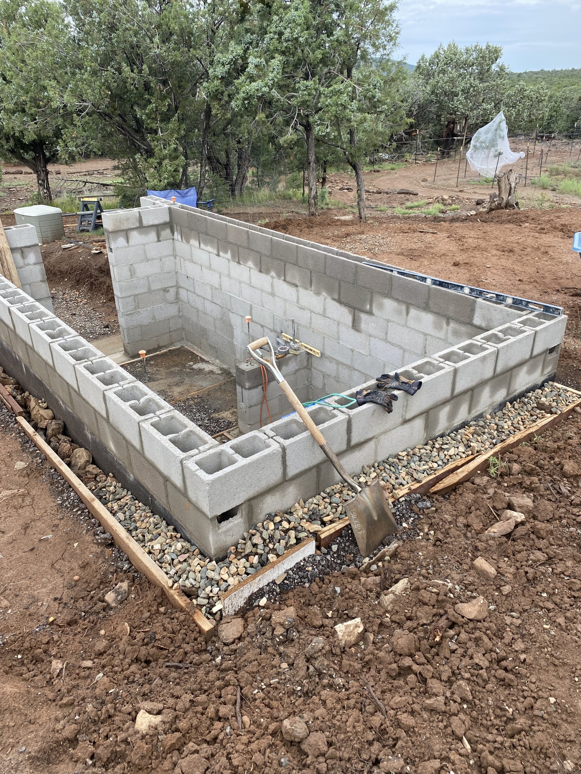

About 12 block a day is what my back will tolerate. Then there’s tarring the outside and hauling/washing gravel for backfill, grinding and placing rebar, etc. The actual laying of block is about 25% of the job, so I’m happy with the progress rate.

Are you going to fill all the blocks with concrete? I found that a metal feed scooper works great for this. I just scoop the concrete out of the wheelbarrow and into the block.
/ AZ ranch
#1,393
I’ve already started filling them. I mix up a batch in the mixer, pour it into a mixing tray, and then I’ve been using some old plastic flower pots to scoop it into the block. Since I’m filling at the halfway point, I’m sticking little 2 ft pieces of rebar vertically in every block to help make a stronger bind with the top half when I fill it. That’s in addition to the vertical rebar that is 5 ft long that I put in at every 32 inches.

I finally finished the 9th and final course. I was planning on grouting today, but Hurricane Hilary May delay it another day or two. It’s suppose to thunderstorm all day.

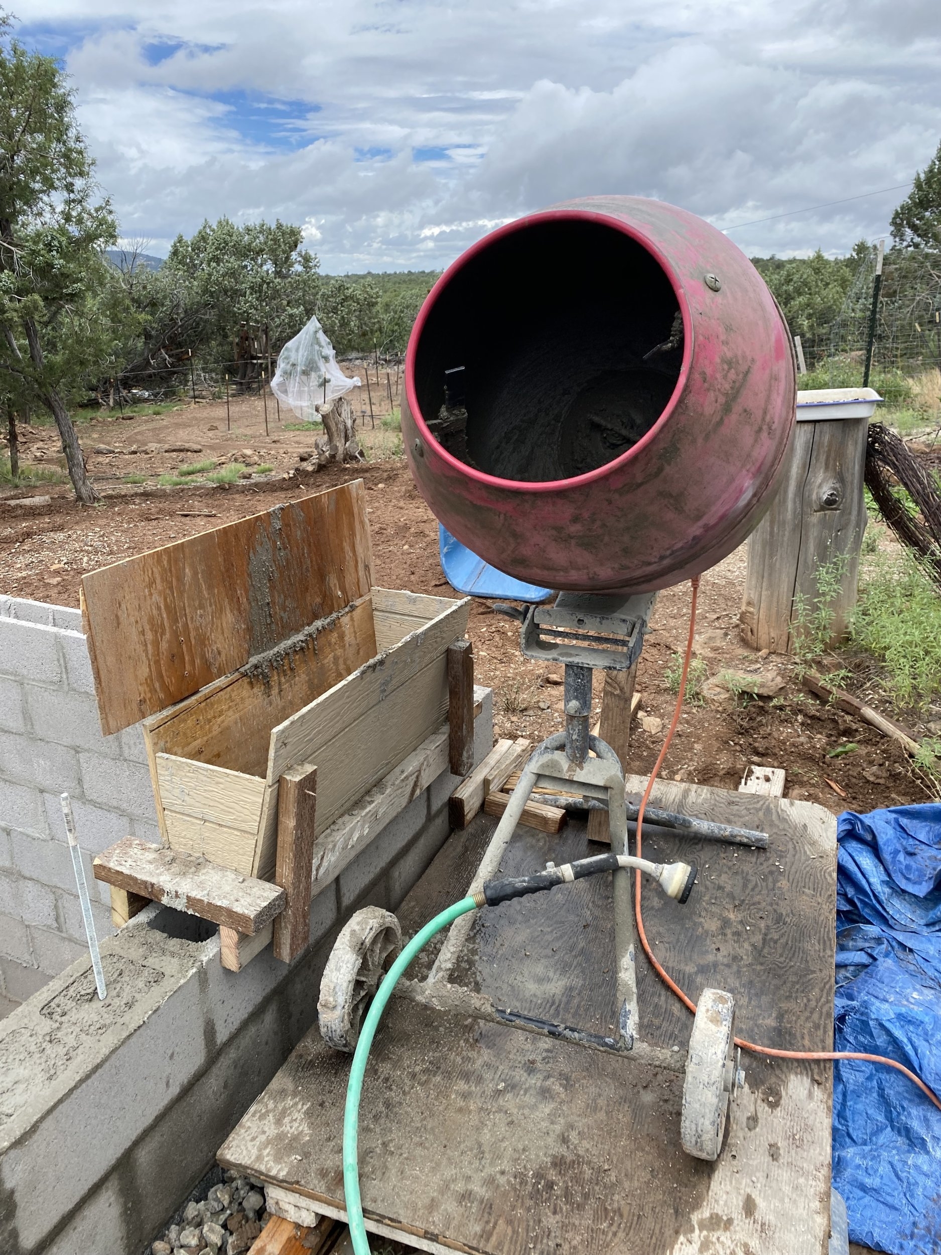

I spent the day on several small jobs in case a storm did materialize. I made a box to slide along the top of the wall that I can dump my mixer into. Cut up some old all-thread to insert as anchor bolts. And hooked up the post hole digger and did a few 4x4 fence posts.
Now it’s time to go out and fire up the mixer!
/ AZ ranch
#1,400
So much for Hurricane Hilary. Like the other Hillary, it was just a lot of hot air. 😄
We got a small sprinkle for a few minutes. Other than that it was just cloudy and cool.
I got 26 bags mixed before the rains came. My homemade box works really well.
