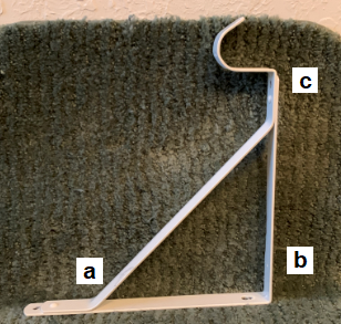

Fulcrum Concept
I'm not giving up yet! I have another example of the situation. This represents the diagonal brace and post design:
You are correct that triangles are strong. In the above, each of the 3 segments cannot change length: a-b is the ground, b-c is the post, a-c is the diagonal brace.
Imagine that this is on wood. Nail a brad at locations (a) and (b). Each brad represents burial of the post/pole. If you apply horizontal tension such as a wire on point (c), what will happen? The brads will not shear. If the tension is enough, the brad at location (b) will pull out. Point (a) represents the fulcrum. This model represents the lifting force on an end or corner post.
The only reason a wooden post stays in place is by post-soil friction. If the friction is overcome, even gradually due to weather and moisture changes, the post lifts.
As stated earlier, if the distance between (a) and (b) is increased, the leverage to lift the post is reduced. This is why the "H" design works - the distance of a-b can be increased to reduce the lifting force so the post's friction is not compromised. Perhaps you have even seen double-H implementations for ground that is low friction (wet?), or they want to apply a lot of wire tension.

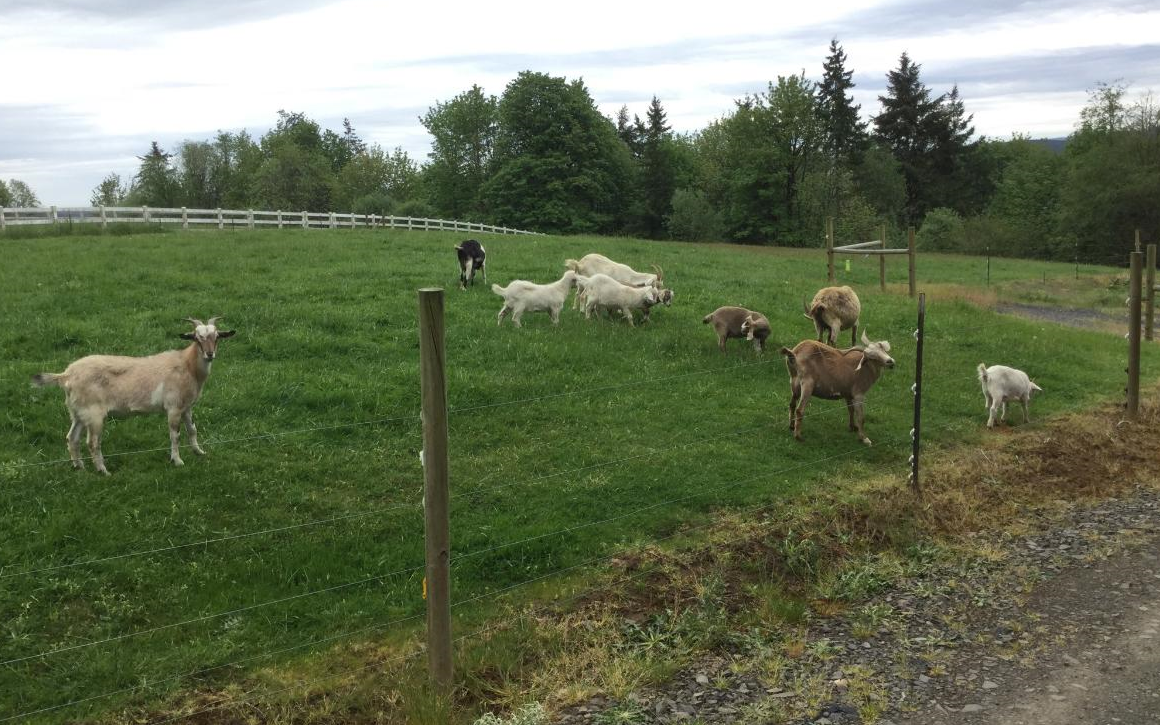

Not going to get into what type of bracing is best. But I like the five strand high tensile electric fence. My goats have never got out after I put them in the training area
for a week they all get used to the fence and never challenge it. But this fence is just to keep livestock in. It doesn't do anything for coyotes and for sure wouldn't
stop a wild hog. I don't like barb wire. My neighbors horse got caught up in the barb wire and just tore its leg wide open, the vet bill was huge he said.
