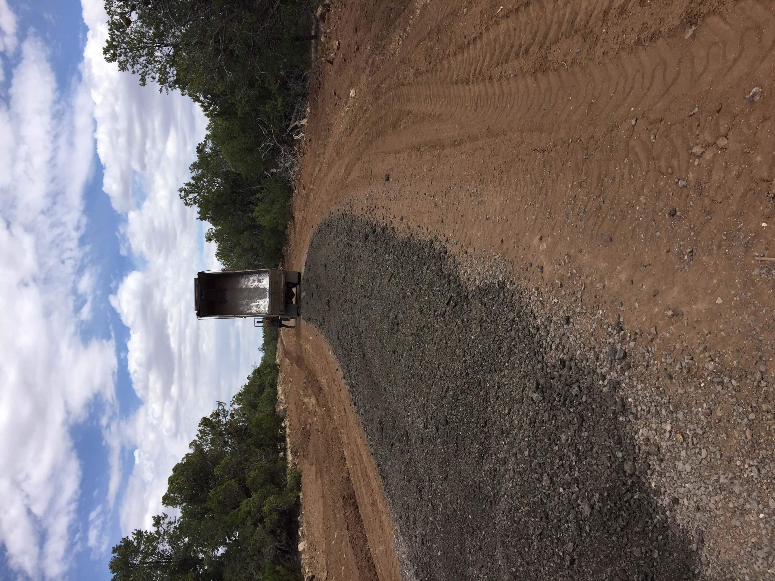

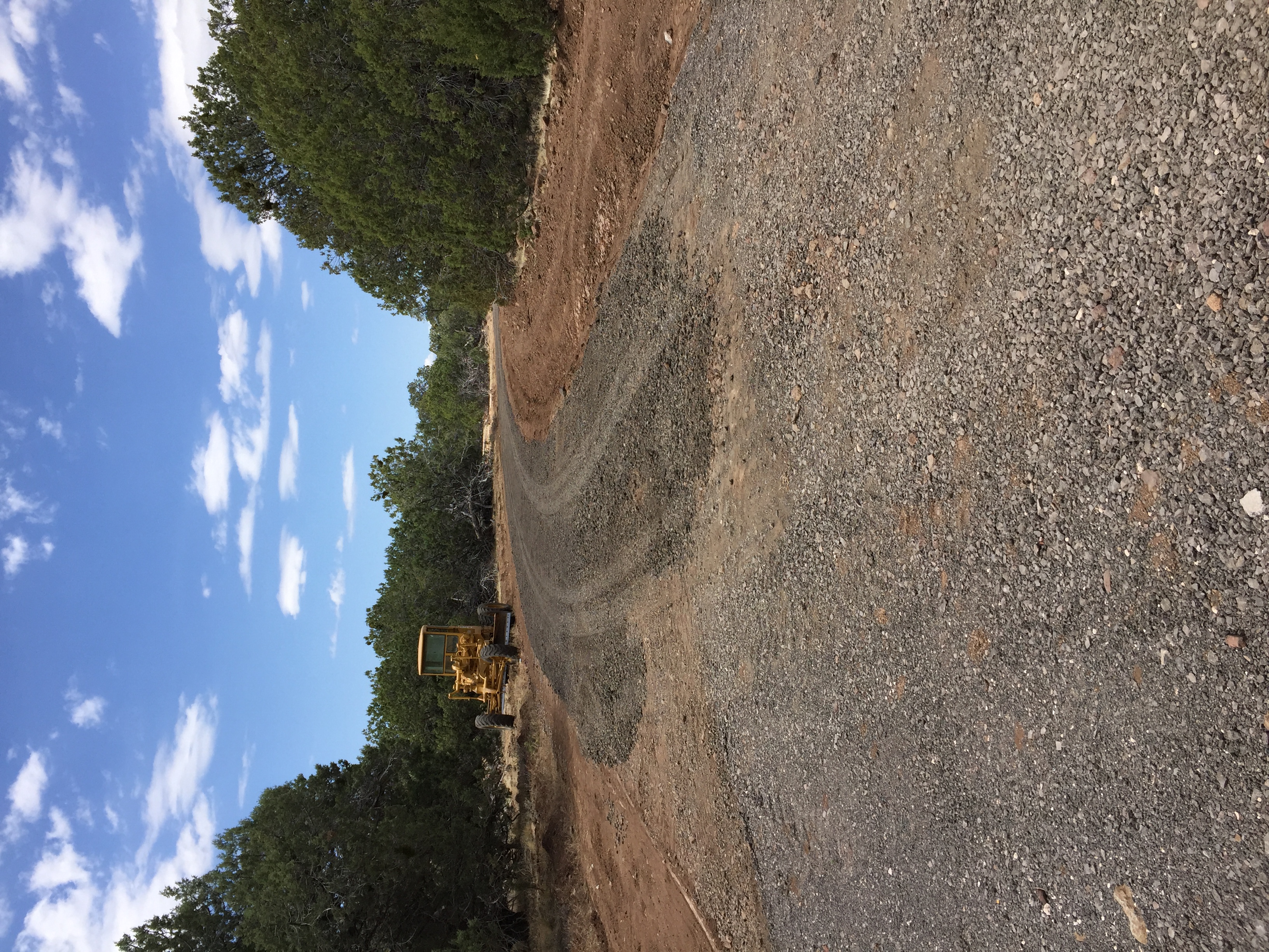

We have a few miles of dirt roads that lead to our place, that can get very muddy when it rains. This year the board approved a road improvement budget. My neighbor and I are doing the work to save the Assocoation some money. We are laying down Millings? which is ground up pavement from the freeway when they do a resurfacing. We are happy with the way its turning out.
I cant remember how to rotate the pictures

Pictures appear to be straight on my iPad
Road looks like you are a professional
   / AZ ranch
#1,085
Thanks. For a couple of rookies, I think we are doing an okay job.

Hey Bo, how does the price of 'millings" compare to that of "ABC"? Do the millings compact well into a unified surface similar to aggregate base course? The reason I ask is it might be a cheaper method to improve our POA road?

We've been using some of those millings up north on Markham Pass Road, as well, Bo. They are great! One of the neighbours takes donations and buys the millings, and another uses his dump truck to haul them. It is a really nice improvement. It's nice having neighbours that care...

Well, its way cheaper for us, but that is primarily because of transportation costs. The millings are just across the freeway, so the guy hauling does have far to go. ABC is a little more expensive, but with hauling costs, its about twice as much. It packs down nicely. We water it and then drive our dump trucks over it.

Who runs the grader? An operator with a good eye and fine touch is hard to find and worth their weight in gold.
   / AZ ranch
#1,093
My neighbor, Todd. It’s his grader and he’s getting pretty good at it.

Photos of the road work are facing West.

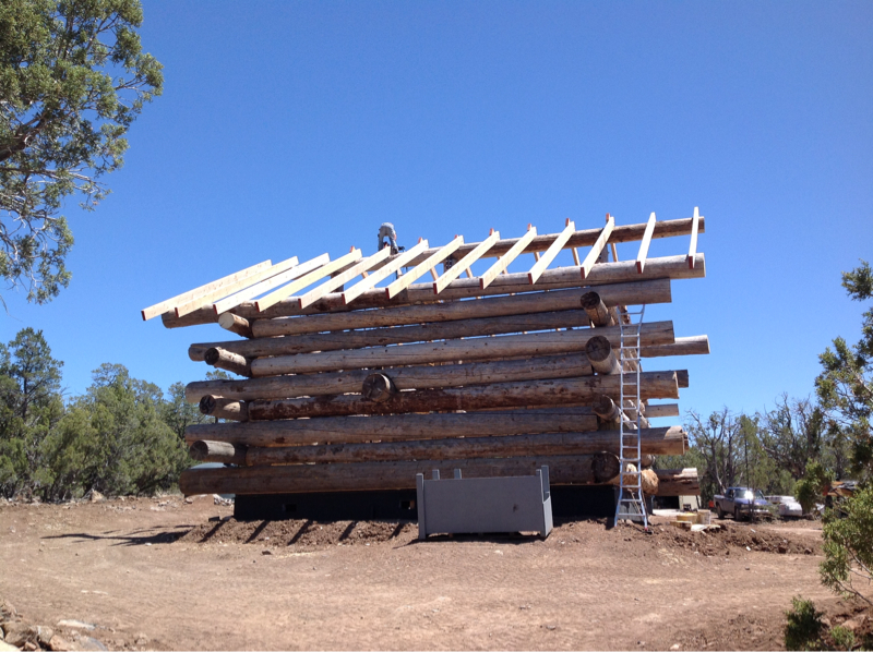

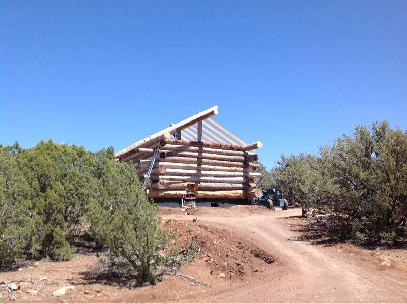

What would I have done differently? Wow, I don’t know that I want to dwell much on that one. I might have hired a experienced local contractor to deal with the County. Heaven only knows how many times they said I had to do something that was merely preference vs actual code.
The 2 year limit on building is BS. I would have preferred to stretch it out and enjoy it more, but regs are regs. It almost seems like a blurr sometimes.
Would I have picked another County if I knew then? I doubt it. Location is perfect for us. Neighbors are the best. Things work out. I guess I don’t believe in luck or chance. All things are directed by Him.
I’m fine with not having drilled a well. I haul water about once a quarter. I really enjoy the solar setup. A 3.8kW system is just right for us. About 8-12 times a year we use the backup generator. Usually in January when days are short and panels are covered with snow, but occasionally in June when the whole family visits (lots of showers, laundry, etc).
There are a few little things, like wishing I had a switch here or there for lights and such. It’s near impossible to push more lines through when you came through a log and then chinked over it.
The Tongue and Groove floors are a pain to keep clean (vacuuming the cracks), but I wouldn’t change it. I love the look.
I might have considered going with one less layer of logs. The second floor is 8 feet before the roof starts. The headroom from wall to wall is nice but the roof is really way up there when you need to get onto it.
If I wasn’t under the time crunch, I think I would have dug out both sides of the crawl space and put a couple water storage tanks down there. I dug out half of it, so it’s about a 5 foot space.
Oh yeah. I cut down one big tree early on because I thought it might block our view. Any blockage would have been minimal. What I did was make the house more visible from the road a half mile away. I think that is my biggest thing, as far as what I would do differently.
