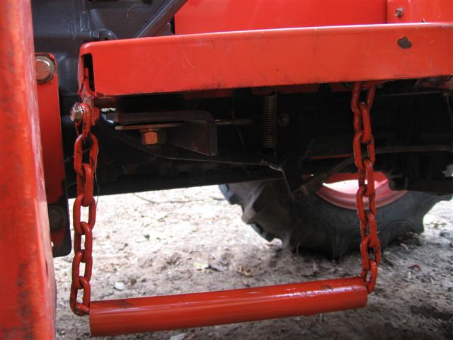

Have you considered making a step using a length of chain like a stirrup? Or, a piece of pipe suspended by a chain at either end? That way the step will move out of the way when it enivitably encounters an imoveable object instead of getting mangled.

That sounds like an easy solution for me thanks for the idea.
   / B-7800 step #11
OK I just replaced my mangled step with a chain and pipe. I just ran the chain through a piece of alluminum tubing and bolted the chain with the original step bolts. I haven't tried it yet because I painted it before I put it on and wanted to wait till it dried good.
