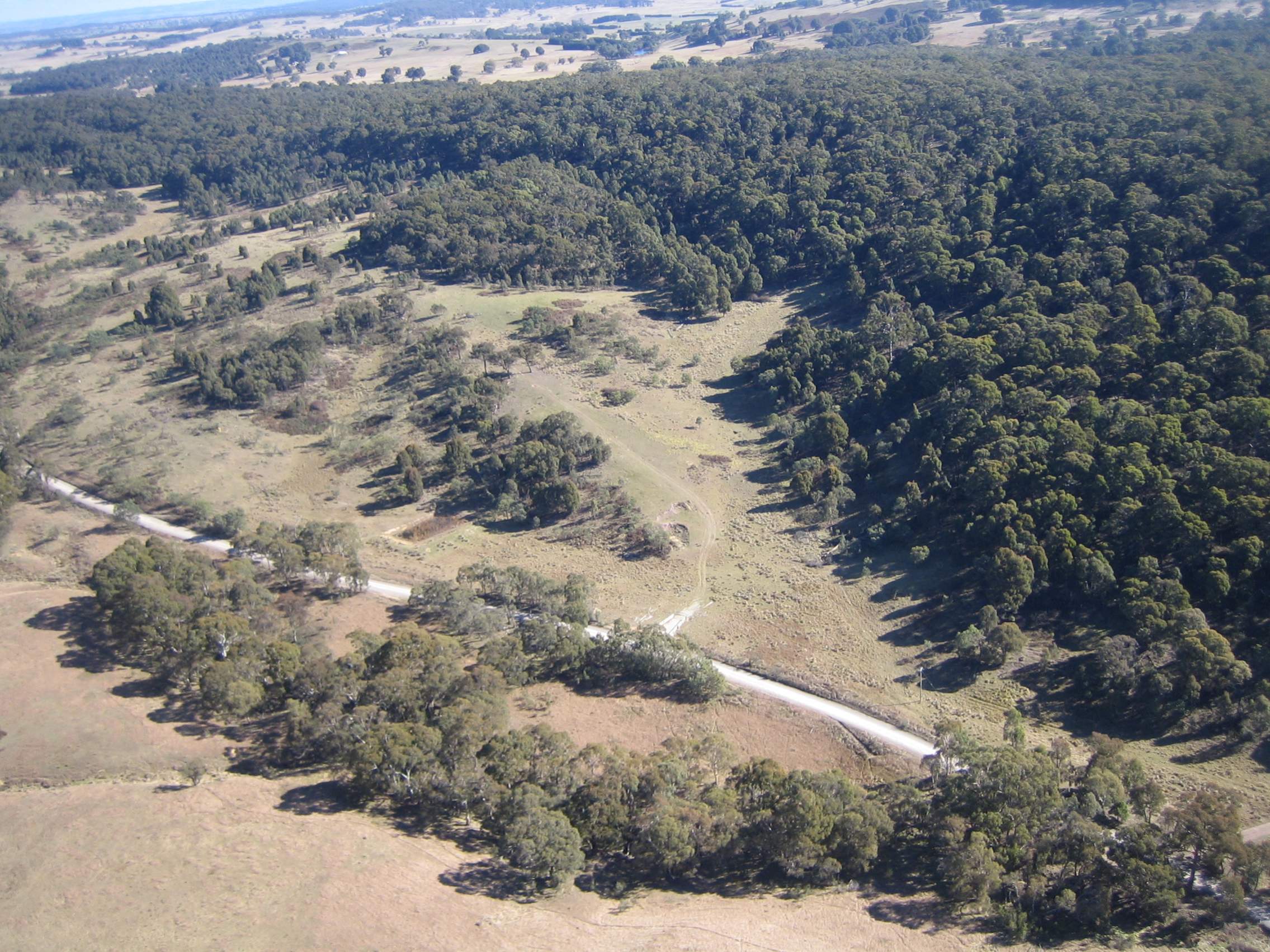

Hello from Sydney, Australia.
I was hoping you may be able to steer me in the right direction.. I am in a fortunate position that I operate a helicopter company... For the last few years I've been using a MTD ride on mower (no cutting deck) to pull the aircraft out of the hangar... Anyway it finally died this week which sort of coincides with the purchase of a 25 acre property that my wife & I have just acquired...
The property which is half cleared is on a slight slope and is in need of some heavy duty slashing, so here is my plan...
Buy a B2320 or the model before, the B7510 for pulling the aircraft out of the hangar and then on the 2 occasions a month that we'll drive the 2.5hrs to the property, put the tractor on a flat bed trailer and tow it to the property so it can be worked. (at the moment, there is no dwelling on the land... I'll be putting in a livable shed (14mts x 14mts) sometime in the next 6 months, so the Kubota will come in handy for this I guess - However it's main purpose on the property will be for slashing etc).
My main question is, will the cheaper B7510 do the trick or do you suggest the B2320 (hoping the model numbers are the same in the US as in Australia?)... Initially I won't need a bucket but would like the option later (I understand that the newer model is easier to get the bucket on and off and I won't need a load control valve?). I'll also be attaching a hitch to the front plate of the tractor for towing the aircraft so the bucket can't be on at the same time. I also need to go very slow and have good control over the tractor when pushing/pulling the aircraft. (Is the B2320 better for this?)

I think either model would serve you well, but don't rule out the BX line which can do all you describe. My only suggestions would be to a) get the loader b) move up to the 4'6" or even 5' "slasher". If you search on these forums, you'll find numerous examples of incorporating hitch receivers, etc. with the front loader bucket. Also, in the states you can get the 2320 without the valve, but you'll need to add it if you intend to get the loader. And yes the loader is very simple to install and remove. Good luck to you.
   / B2320 or B7510 (Duel purpose usage - Aviation & property) #3
Bluesky welcome to the forum. I would also think either tractor will work for what you describe. Looking at the photo of the your property it does not look as if the vegetation is overly thick so I would go with a 5' shredder also. The 5' will cover your wheel tracks and only be oversized in very thick grasses. Kubota is conservative when it recommends implement sizing.

I agree with everyone else, either will do the job. The FEL on the B2x20 series are extremely easy to disconnect/connect. The property looks great!

Thanks for all your great comments and the warm welcome to your forum - The property is half cleared (other part is the wooded area at the top of the picture) - So only about 12 acres will need slashing etc...

If the B7510 is NOT the gear version and NOT the narrow version, then I think it would work as well as the B2320 for you. In other words, it should be the normal HST B7510.
I would be a mite leery of going to a 5' slasher, however. It's heavier than the B7510 is rated for. The tractor will lift it OK, but you'll need the loader or weights on the front to keep the front wheels down. Better run that 5' idea past your dealer before committing. Don't forget, the CG of a 5' slasher is about 2.5' behind the 3 pt. hitch balls and the weight acts through a long moment arm when raised clear of the ground.
My B7610 was pretty happy with a 4' slasher. Might've handled 4.5'; 5' seems iffy. Mowing 12 acres with a 4 footer will be painfully slow, however. Maybe look into a heavier 30HP B7800 with HST if you really want a 5' slasher. The larger wheels of the larger tractor will make the ride much more tolerable as well. Going slow enough to keep from being bounced off makes for a long day.
