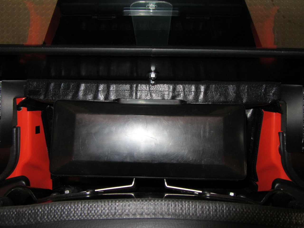

Here's some close-up pictures of the Rigid Industries Dually D2 LED Lights that I used. I'll try to get a picture of them at night to show how bright they are.

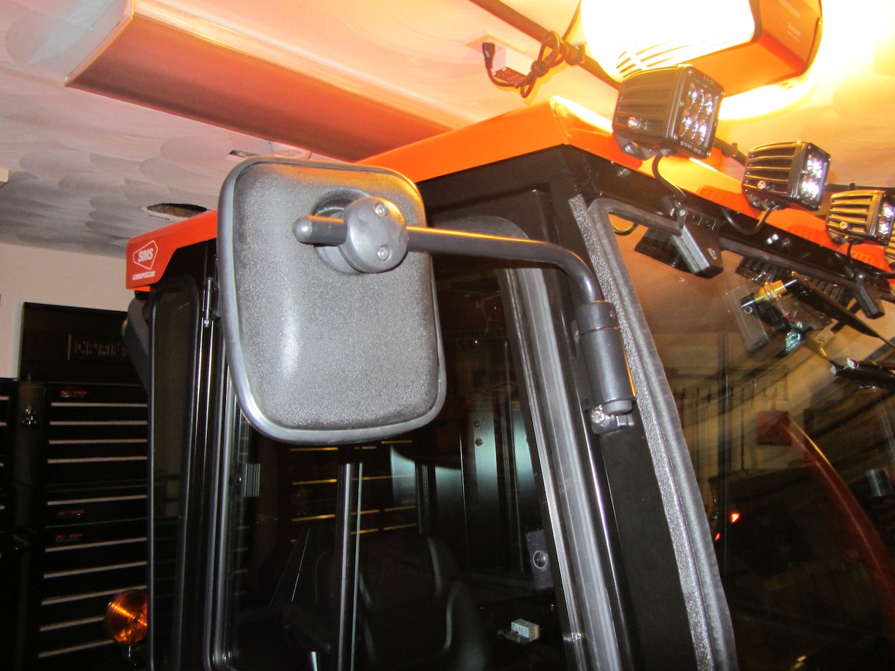

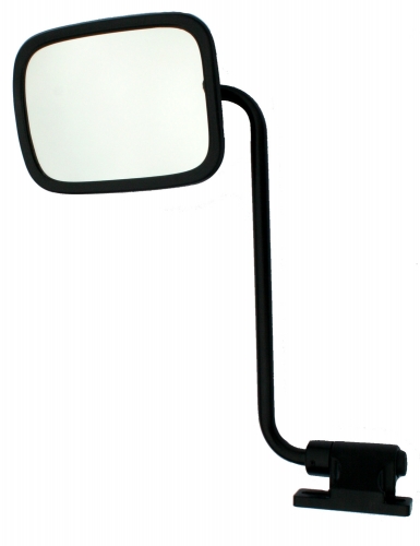

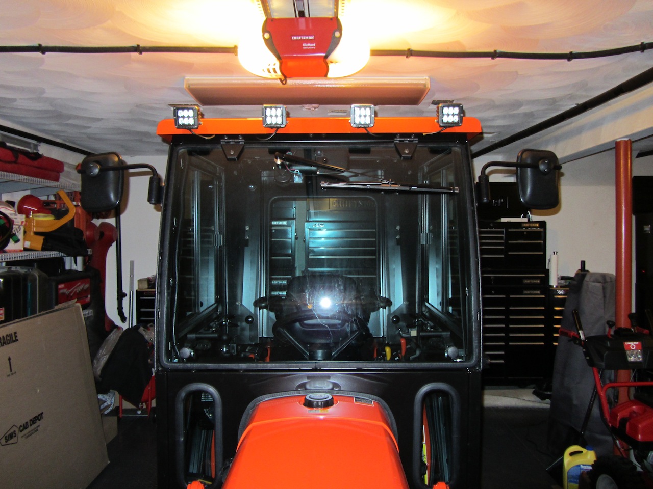

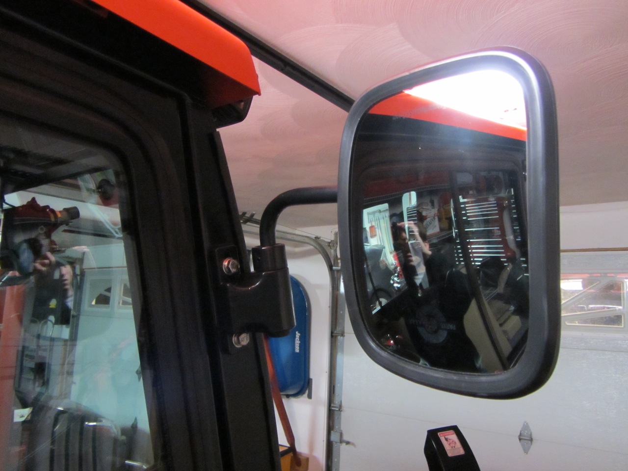

I made some more progress today with the installation of the mirrors for the cab. Even though Sims provided me with a free mirror kit, I decided not to use their kit as I wanted something more substantial. Instead, I went with the Depco Little Hoss Mirror Kit along with some modifications to the arm assemblies.
In my opinion, the Sims mirrors were just too small and even though I wish the Depco mirrors were a little larger, it definitely fits the size of the cab much better than the Sims mirrors.
To install them, all I had to drill holes in the door frames and install 5/16-18" Rivnuts.

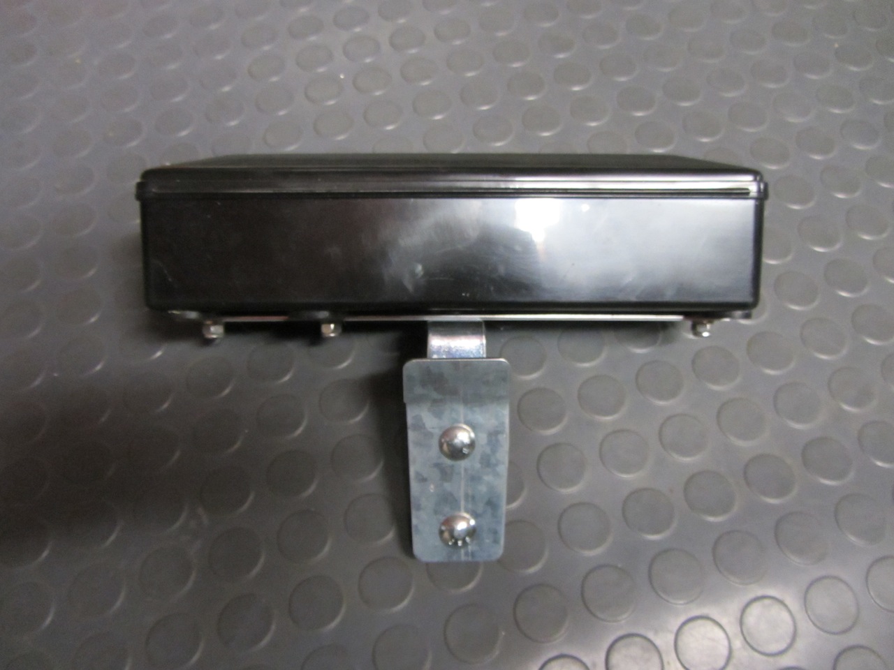

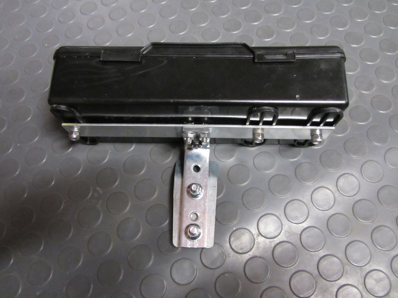

Now that the cab is installed, I no longer had a place to mount my toolbox. The bracket that comes with the backhoe to mount the toolbox to the ROPS interfered with the cab.
Another member mentioned they mounted their toolbox behind the seat, so it got me thinking. Why not make a quick bracket to mount to the SMV bracket behind the seat?
After a trip to TSC, I came up with this design. When the weather gets warmer, I'll break out my welder and weld everything together rather than using bolts. For the winter, this should work just fine holding my 3-point hitch and snow blower shear pins.
In addition, I mounted an MTD chute clearing tool to the BX2750D. It fits right on the side of the chain house without having to drill any holes. It should work well for clearing slush from the chute when it gets blocked (actually, I needed to use it during the last snow fall.)
