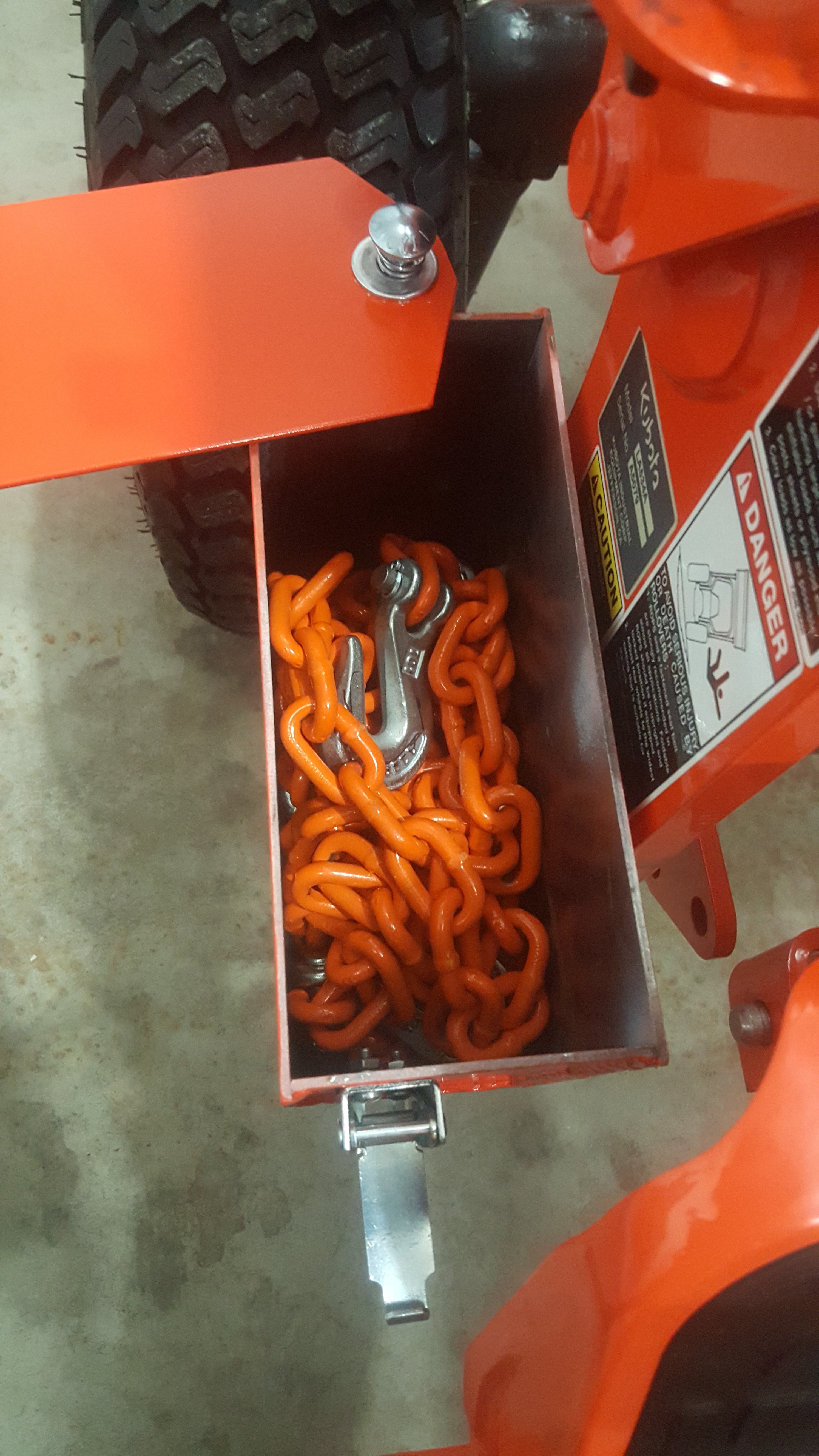

Rkidd,
Like that tool box a lot. Can’t wait for the modifications to start
