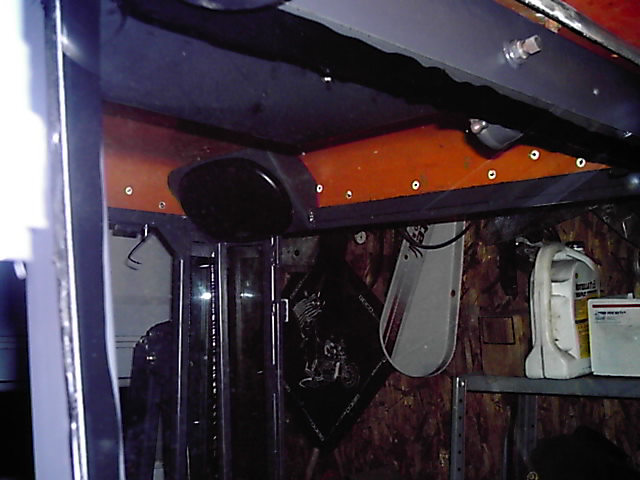

Yes I glued right to the outside of the frame. I glued it myself so it is not perfect but I hope it will work. In the first picture you can see a recess where my side window will be going. It is for the window gasket to hit on but I could of done something like this for the front glass instead.

here are some pictures of the simple bender that I used to make the curved sections of the cab. The hardest part about bending steel with it is keeping the steel flat. I started with a board cut to the shape of the bend that I wanted. I slipped the end of the tubing between the bolt on the right and the board and worked it around the bend, but the tubing would spring back and not hold the shape. I had to change the shape of the wood and work the tube in smaller sections until I got just the right bend. It was slow work but the cost of the tool was great:D
