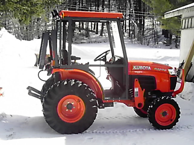

ok, here are a few pictures of my cab
I use the original Jinma Canopy for the Roof and all around laminated Glass, the Cab self it is made of 60*30*3mm, 40*30*3mm square tube and a few meters of 30*5mm and 25*3mm flat steel and steel sheet, Door and Rear Window are made of 30*20*2mm square tube

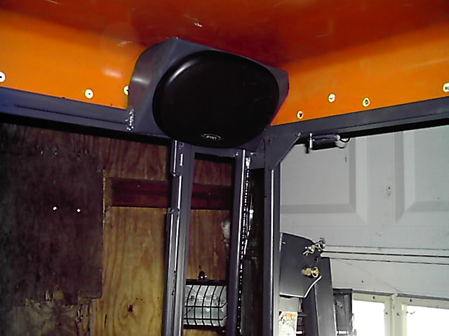

and here is one picture of the Heater

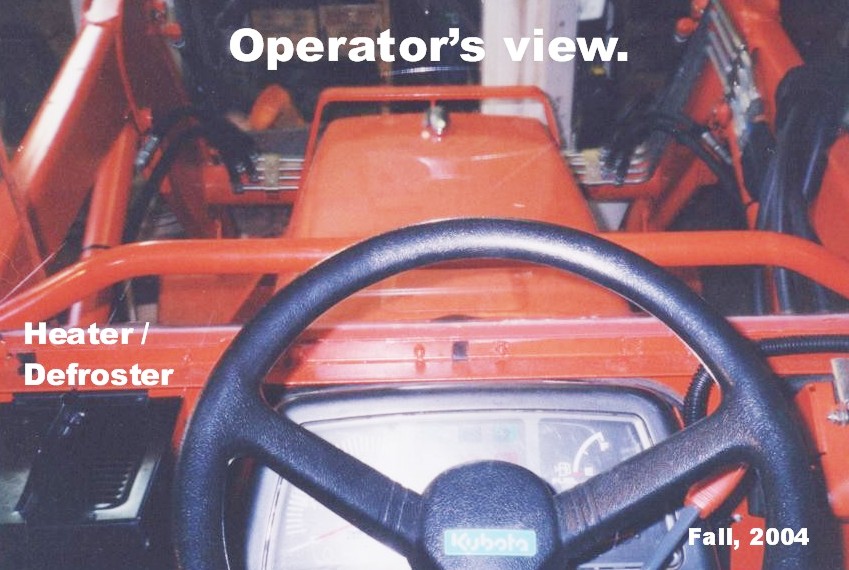

I think your heater problem may be due to the heater being outside the cab. I think you are losing a lot of heat outside. Mine is inside and is higher than yours and I have no problem with it. It's to the left of the instrument panel.

Nuno awsome job on the cab It sure looks like it belongs on that tractor. I should have recessed my glass like you did. I glued mine to the outside of the frame. I think it will be strong enough but It would be more protected if it was done like yours. Did you paint the whole machine or just the cab?
I can't see you having problems with the heater due to it being mounted too high. I figured you had it mounted up by the roof.

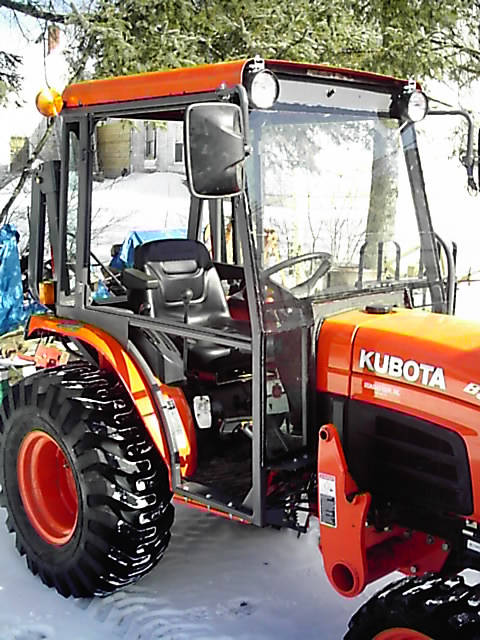

well here are a few updated pictures of my cab build. It is hard to see but the front glass is all installed and 3 of the 4 rear corners are in. I still need to get the last corner and the lower side near the brake pedals glued in then the basic cab will be complete minus wiring and heat. I still need to clean up and paint the windows and doors. I also need to order the glass for the door.
Rob
