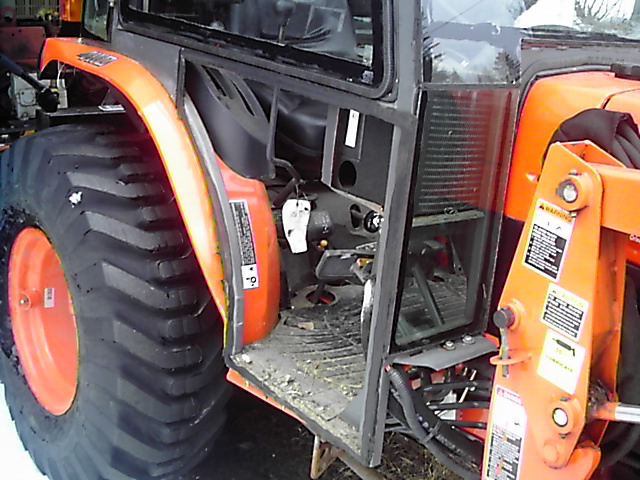

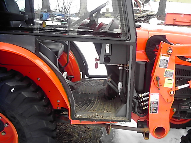

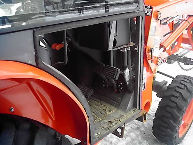

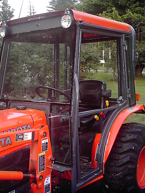

I was looking at the curve at the lower portion of the doors around the fender. What material is it made of and how did you get such a nice arc on it ?
   / B3200 cab build
#42

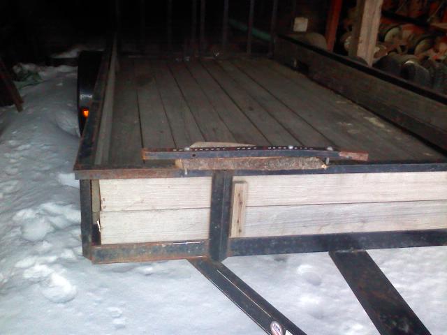

I made it out of 1/8" 1x1 tubing. I made a crude bender bolted to my lanscape trailer. It took mutiple trips back and forth to get the bend that close. The hardest one to do was the bend for the door because it had to match close to the cab bend. When I am at work tomarow I will snap a pic of my trailer with the bender on it.
Rob

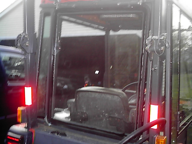

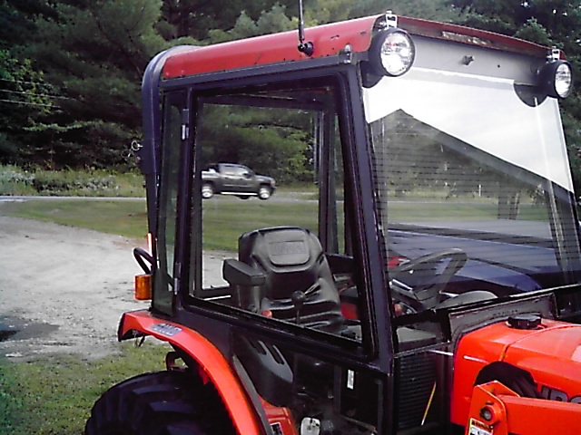

i am not sure if i have understand it right but, have you glue your glass outside of the Cabframe or have you make an frame like this ?
i weld pieces of 30*5mm of flat steel into the Window oppenings, 10mm from outside so that i have enough space for 6mm laminated Glass plus the Glue.
At first i was thinking to do the Glass job by myself but then i found an Glass shop that do the whole job (Glass, cutting the Glass and mounting) for 380 Euro/495 USD. for German conditions this is an absolutely dumping price.
I paint the whole Machine because i was thinking to paint it with Green paint since i purchase the Tractor and now it was a good moment to do this Job.
before it was paint in red and you can see the old color inside the left fender.
The fender will be covered inside with black PU-Body Protection soon.

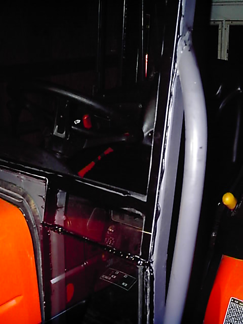

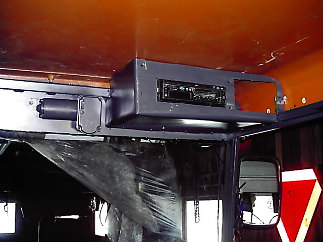

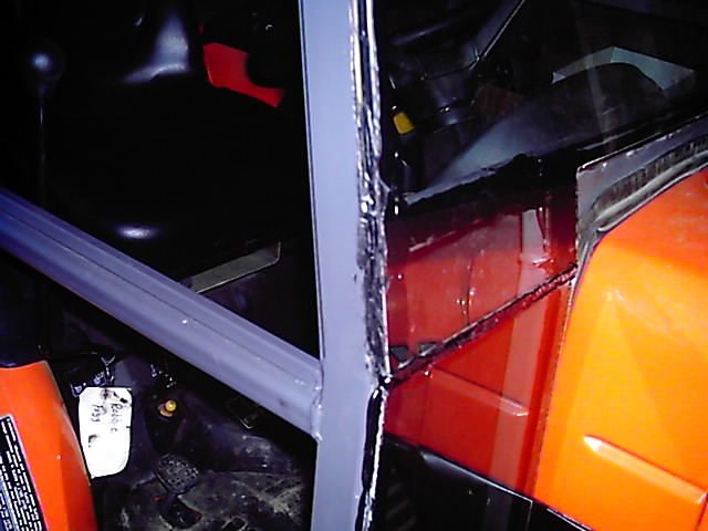

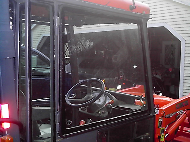

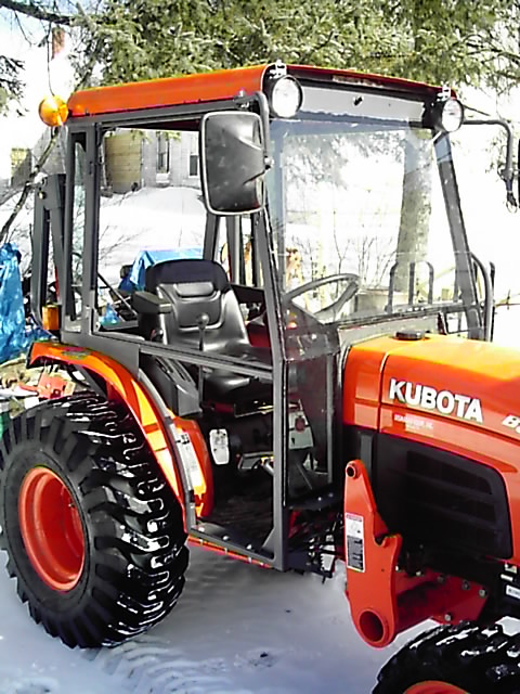

Yes I glued right to the outside of the frame. I glued it myself so it is not perfect but I hope it will work. In the first picture you can see a recess where my side window will be going. It is for the window gasket to hit on but I could of done something like this for the front glass instead.
I thought your tractor might have been painted. I did see the red on the inside fender before I asked. Again it looks great you must have a good place to work on stuff. Painting is hard to do in my work shop this time of year.

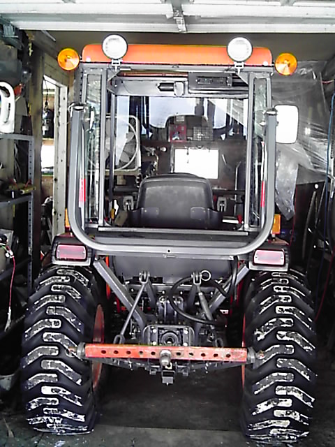

here are some pictures of the simple bender that I used to make the curved sections of the cab. The hardest part about bending steel with it is keeping the steel flat. I started with a board cut to the shape of the bend that I wanted. I slipped the end of the tubing between the bolt on the right and the board and worked it around the bend, but the tubing would spring back and not hold the shape. I had to change the shape of the wood and work the tube in smaller sections until I got just the right bend. It was slow work but the cost of the tool was great:D
Rob

*Update*

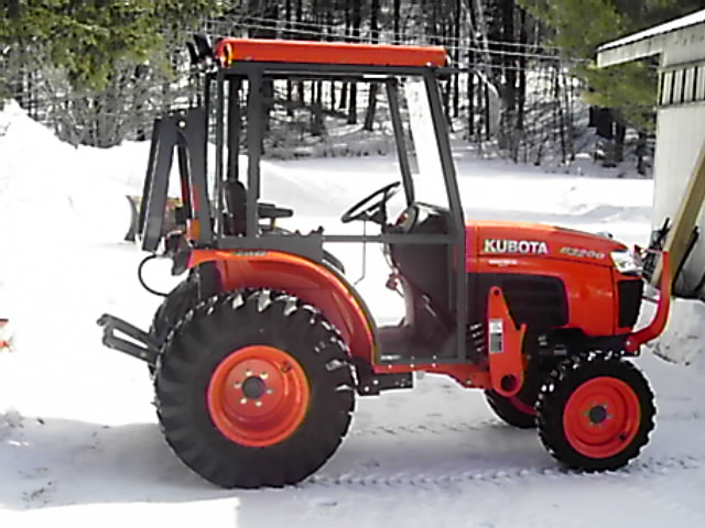

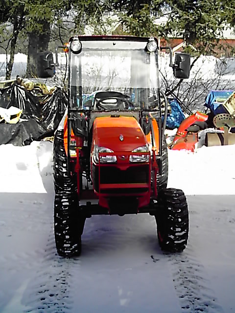

I finally have got around to cleaning up and painting my door and window frames. I installed the glass in the side and rear windows and put the rubber seal around them. I made some templates and ordered the last two sections of glass for the door today. I will need to make something for the seal on the rear window to hit on. I have some ideas of how to do this. It is still a work in progess but I am gaining.

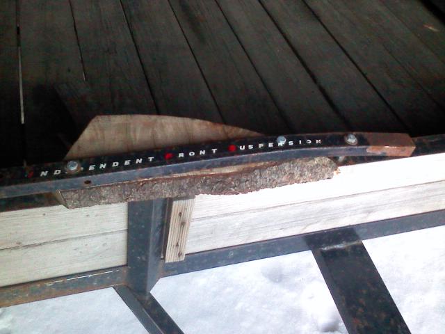

*UPDATE*

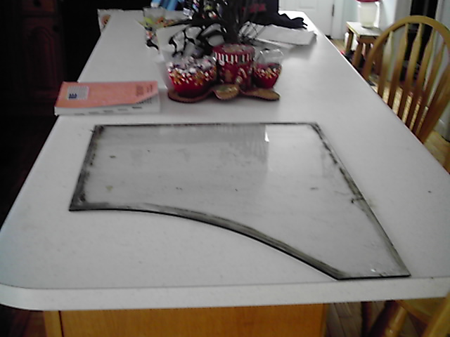

I went out and used the tractor today. All was going just fine. I was hooking onto my pallet forks and climbed back into the cab and looked out the right hand window and saw a odd impression in the snow. Upon further inspection I found that my lower right cab window had fallen off and was laying on the ground. Now I am nervous. that window was one of the first few to be installed. I sure hope they all don't do this.
here is the window unharmed. Sure am glad I looked and saw it on the ground before I drove over it.
