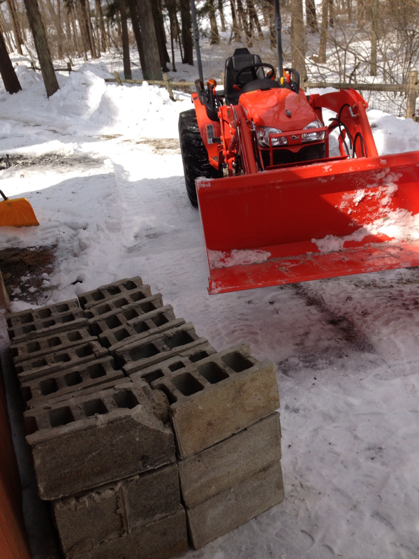

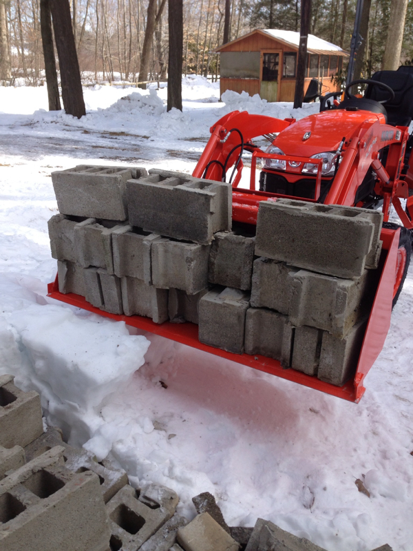

About 30 blocks plus the rubbish from the coal bin we no longer need.
From here
To there
Probably a hundred feet. Without the machine, they'd have sat there til spring.
