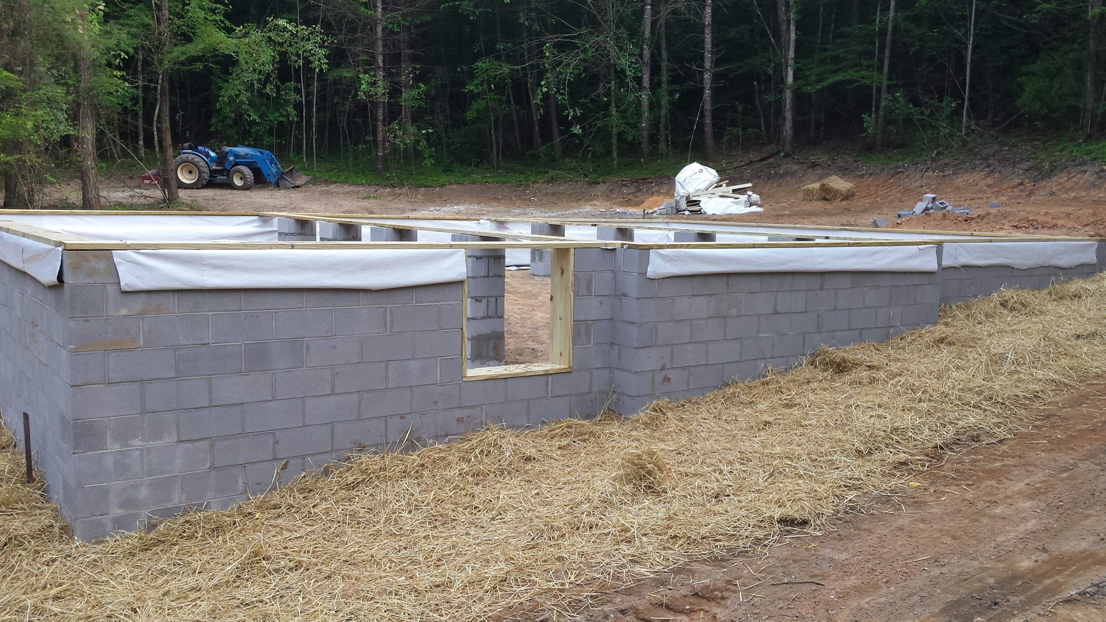

Fantastic pics! s219, as you know, I'll be doing a conditioned crawl as well. Here's a pic of the highest portion, and the GC says its about 6.5ft high.
Looking towards the front high side:

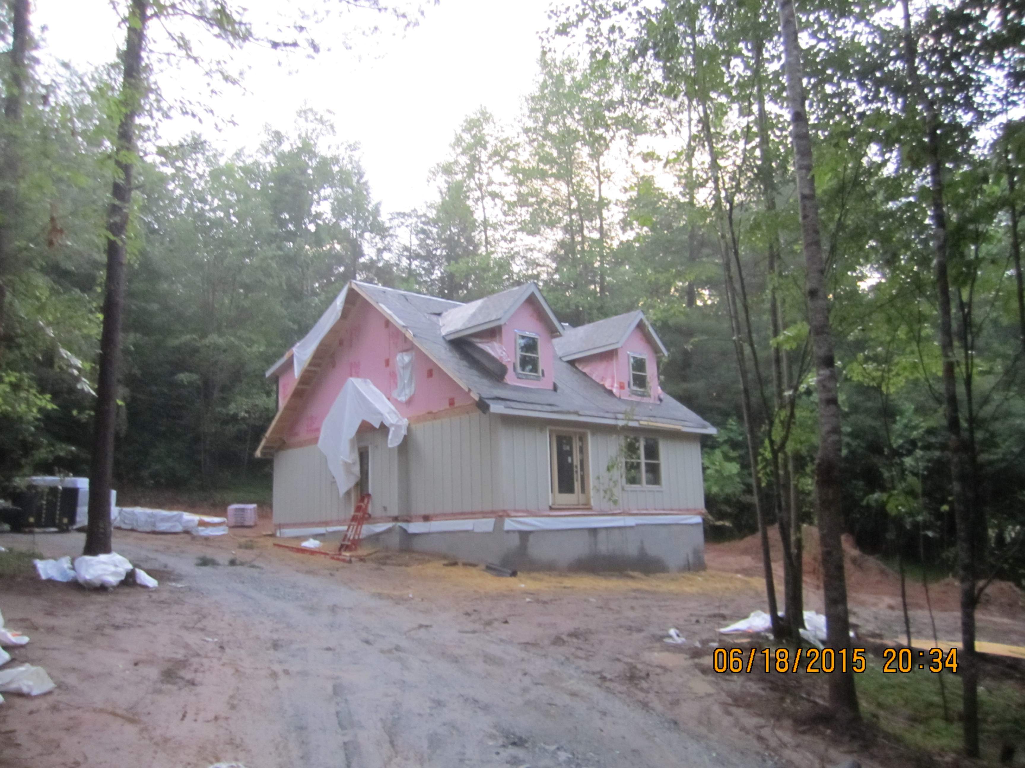

s219, with your conditioned crawl, does your rat slab go over or under the heavy poly vapor barrier? Here's a pic of my home being 'put together':laughing:. The crew will spend another complete day finishing the rough work, then on to well, septic, stairs, decks, paint, etc. It looks a lot different than the home plans; can't believe that besides the door and (1) window, I have zero other windows on the side you're looking at:eek:. I'll either have to get one installed, or be thankful that it faces East.
That foundation doesn't quite look as tall as what I feared earlier. Stone veneer ought to dress it up pretty nice, me thinks.

Does seem a bit odd about the lack of windows on that side, but I have zero artistic/architectural talent so maybe it wouldn't look right or something. I suspect a builder could slap a couple in there fairly easily at this stage, as long as they are able to re-frame the studs to put a header where it's needed. Now is the time to do it if you really want to. But get someone with architectural skills to weigh in and decide on placement. Oddball-placed windows look worse than no windows to me. I often seem them crammed or crowded into a space and it just doesn't look right.
Is that Hardy panel with Hardy battens?? We used Hardy panel, but went with PVC for the battens after learning what Hardy wanted for each batten. I forget the cost, but it was a bit crazy.

S, it is indeed Hardie all the way. This company, Blue Ridge Log Cabins, just recently started offering wood board/batten in addition to their usual 9in 'D' log. After listening to the those on this site about the cost, maintenance, and bug issues with logs, not to mention the inability to do additions in the future- I floated the idea of using Hardie. They agreed, didn't charge any extra, and through the advice of this site, I couldn't be happier. The company since has told me that they increased their price by $10K due to the expense of the swap:thumbsup: I should be able to get a pic of it completely put together, tonight.

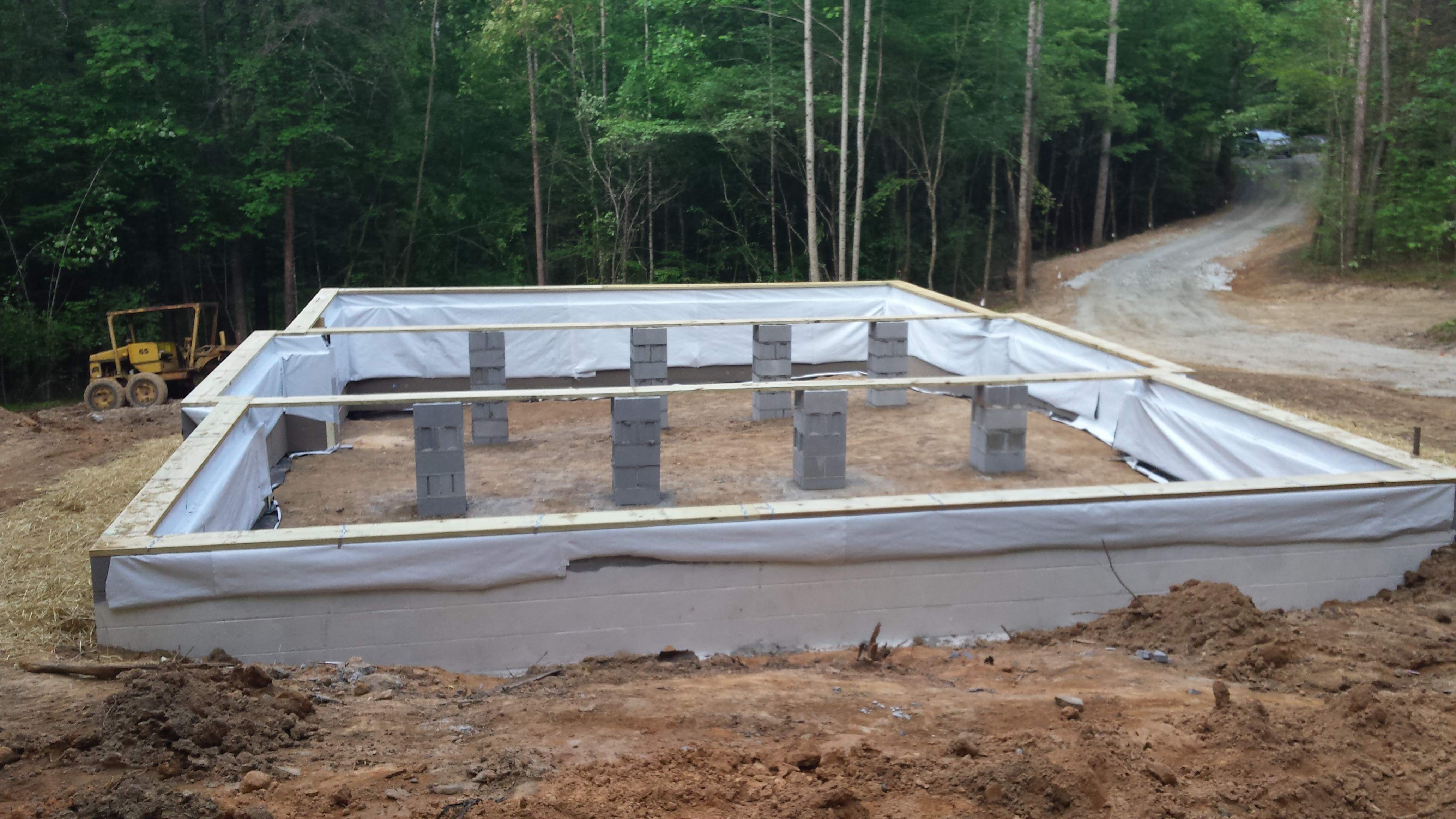

I thought I read that you placed some crete in your crawl for storage?

Oh yes, we do have that small slab in the corner, which is 4" thick -- I think rat slabs are normally only 2". There is a plastic vapor barrier under that which was placed prior to pouring the slab. And then the heavy crawl liner (like a white tarp material) that covers the rest of the dirt floor in the crawl overlaps onto the edge of the slab, and the insulation crew shot down a run of spray foam to seal it down.
