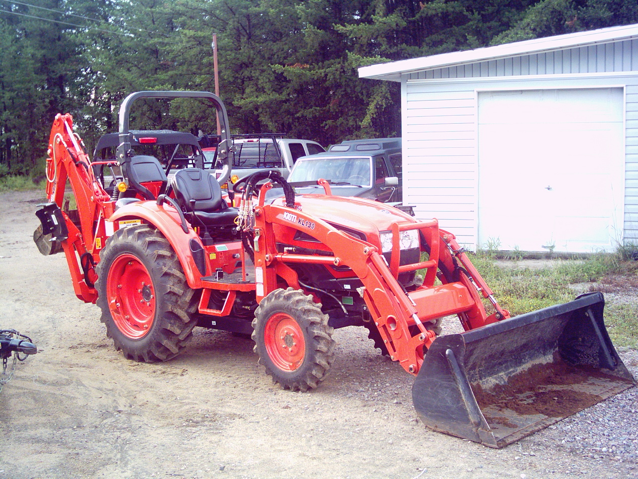

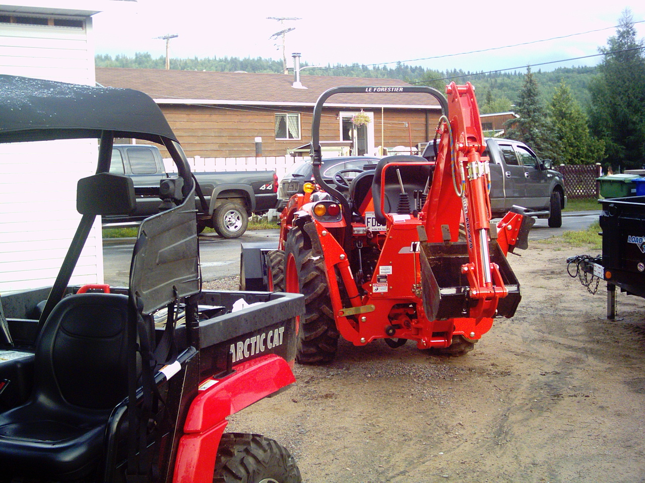

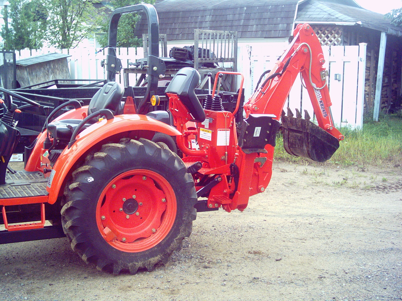

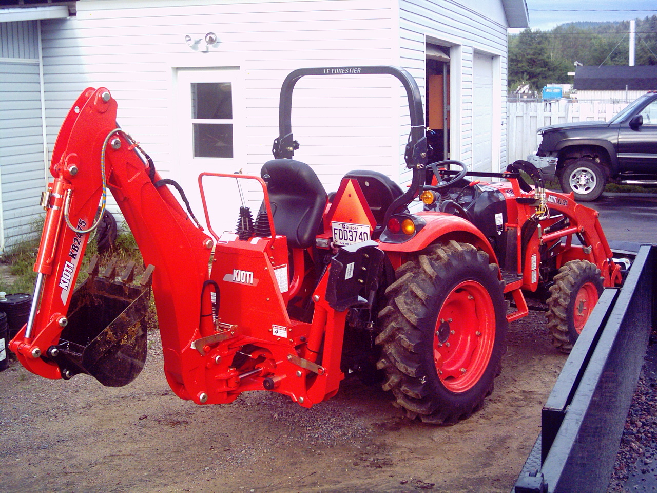

Final it's here, my new KB2475 backhoe. I have the 18 in bucket and had the bigfoot pads installed. Now just have to get used to operating this thing:D:laughing:

   / Backhoe for CK30 #43
Nice hoe, Karl. Are you going to connect up the toplink, too?

Why bother?
I don't know if i should connect the top link to the BH:confused: looks like it's made to connect it, but... i think it's a nice way to break the bracket from all stress from digging:confused2: I'll be ordering a 9 or 12 inch bucket tomorrow, 18 for stump digging is a bit too much.
   / Backhoe for CK30 #46
I don't connect mine. It is useful to connect if you need a place to store the top link or keep it out of the way but modern subframes are designed to support the BH without using the top link.
   / Backhoe for CK30 #47
I was told by dealer that Kioti does not recommend connecting the top link, at least on my CK20S.
We might all wonder why they put a bracket for a top link on the tractor if they do not want it connected???
   / Backhoe for CK30 #48
I don't think the top link is supposed to be connected.
I have never connected mine.
   / Backhoe for CK30 #49
Those back hoes sure look nice, but man, $7000 worth?? I don't know about that..
   / Backhoe for CK30 #50
I would connect it. Additional support and stiffness is good. I really like
the improvements made to the 2475 over the 2375.
What does your owner's manual say?
