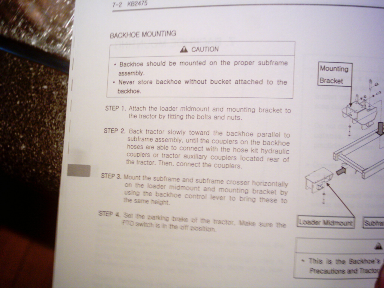

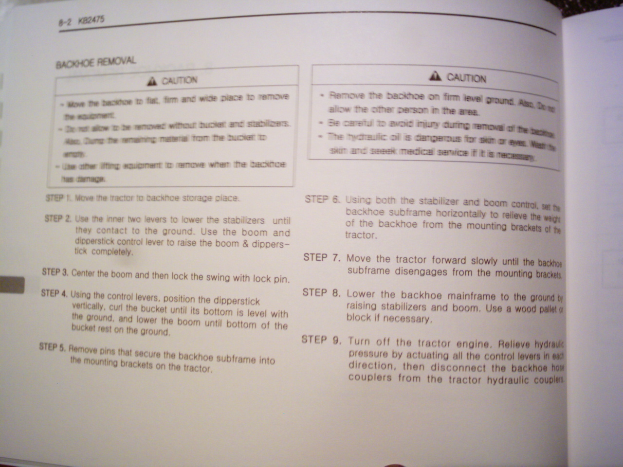

For those interested, these are the pages of my KB2475 manual for installing and removing the BH, if i read clearly, there is no mentioning of the top link. doesn't mean because there are holes/brackets that you have to put something in there:laughing: Dont want to start a debate here either.

Simple question, why would the OEM of the back hoe put the brackets on the back hoe for the top link and then tell you not to use those very brackets that they put on and I assume to use? Very very :confused: ing to me. I'm glad that I have my Case 580 Super E, don't have to worry about these things. ;)
   / Backhoe for CK30 #59
My Rhino came with the top link brackets because the backhoe is sold as a 3 point hoe, the subframe is an option.
   / Backhoe for CK30 #60
Is this true of these other hoes? :confused: If so, then that makes sense, but I'm thinking that that may not be the case in some of these instances. :confused3:
