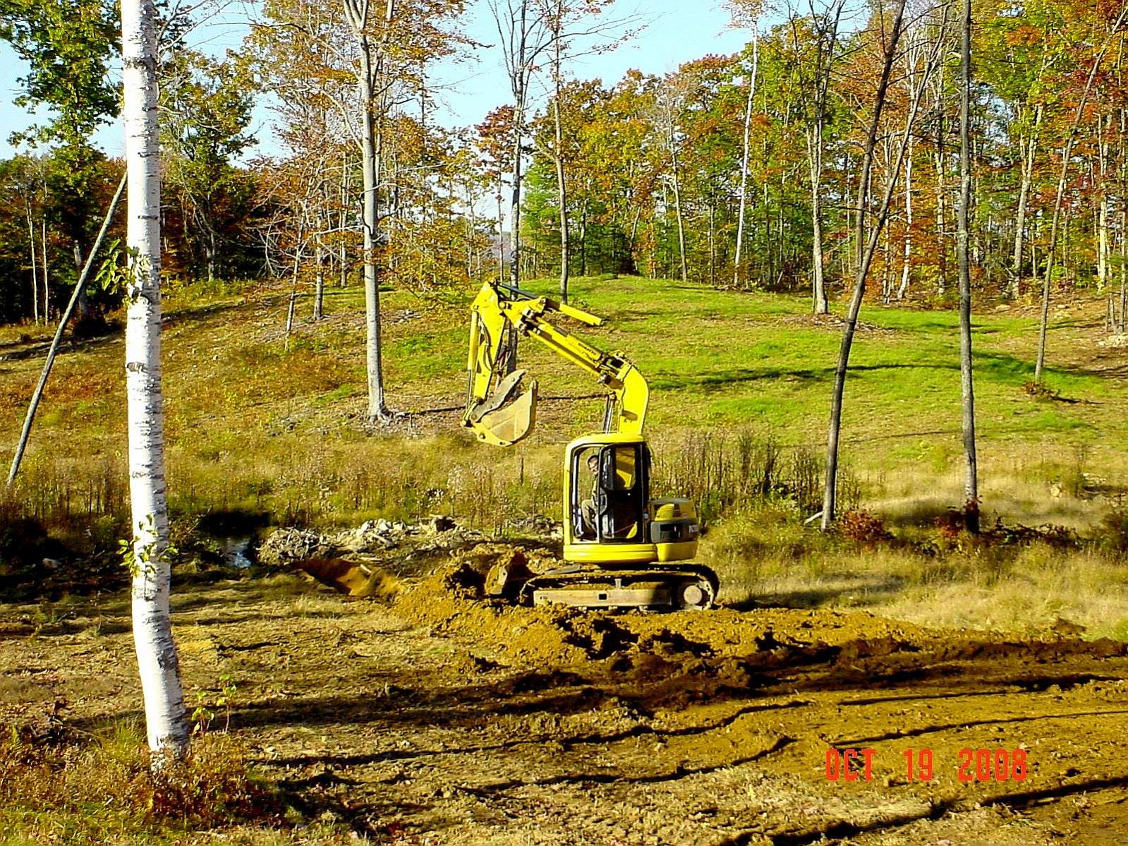

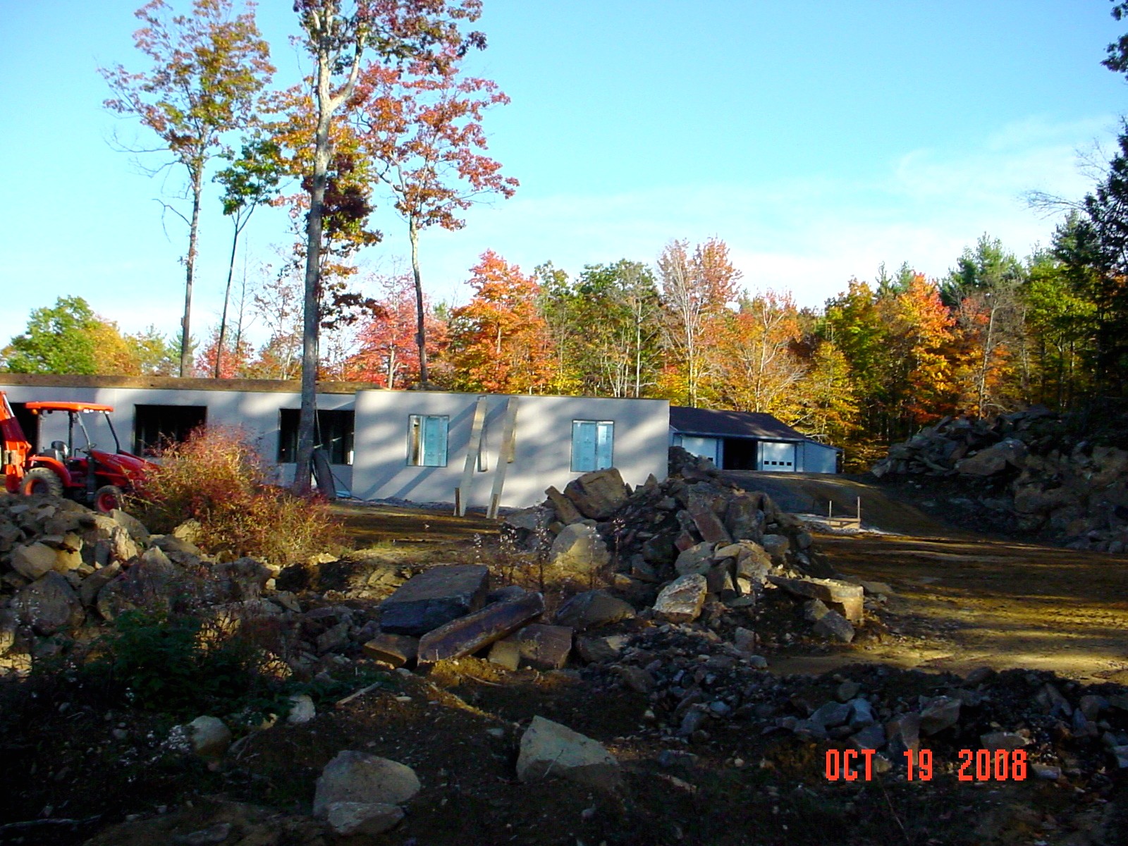

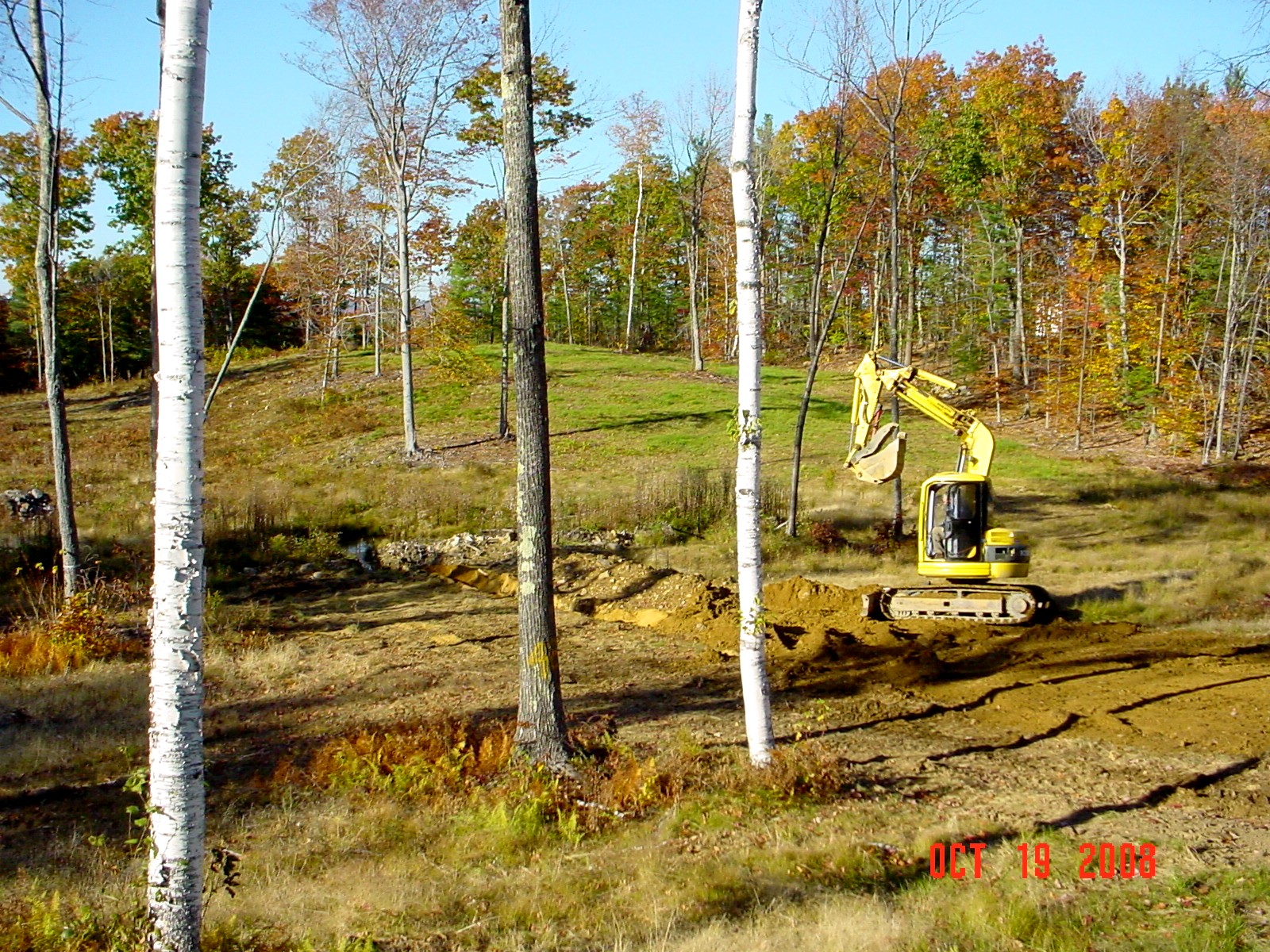

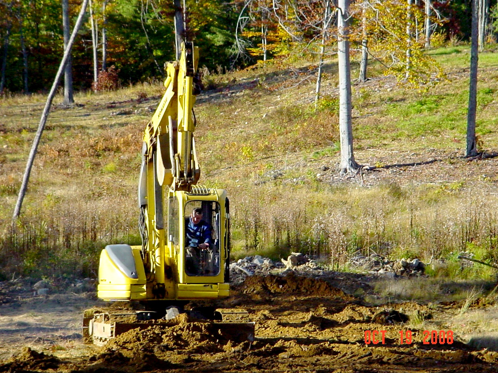

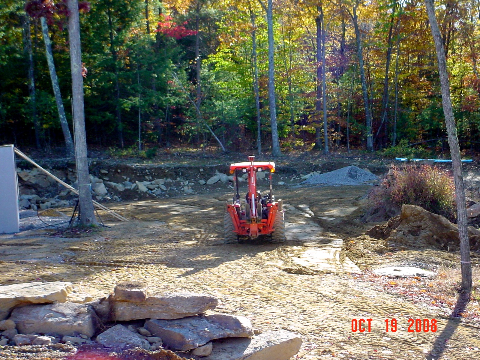

Yup!
I agree.
I have an L39, great little TLB I work hard.
The BH got a lot more use before I picked up an old Komatsu PC75UU-2 with blade and Thumb. 18,000 lbs and too small, but I now use the BH as a balast most of the time. It is still very handy for a small job, but the excavator is much faster and easier to use on any serious digging.
However if you can only have one machine and don't want to rent, get the TLB. First ask if you will have use enought to keep it after the majority of the work is done.
Excavators are like big old boats, cost to keep running is not for the faint of heart. I guess neither is hiring out and renting.
