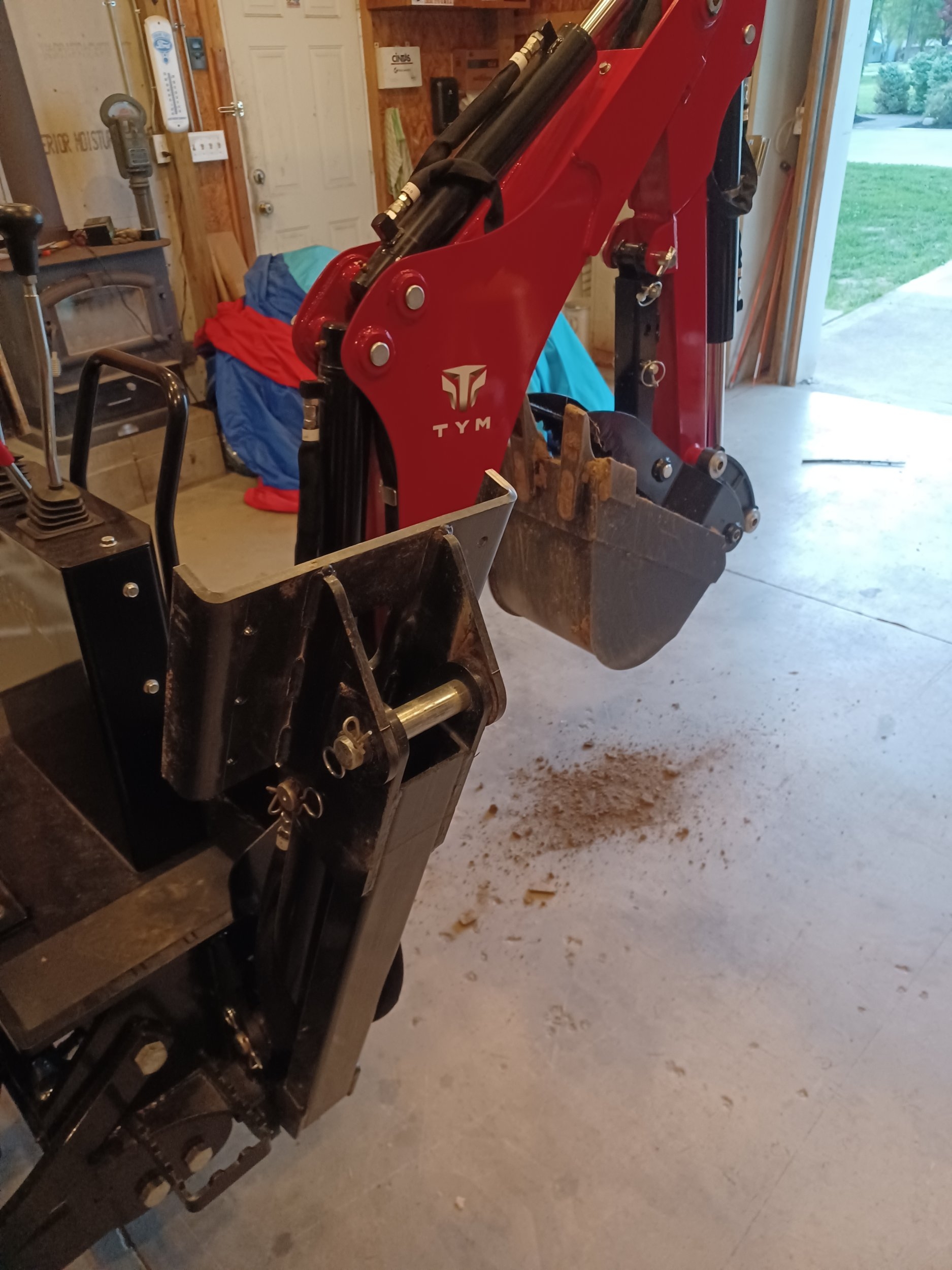

I have a T25 w/backhoe...
Although the outrigger arms are still able to be run into, I flip the bases over so my grandkids dont hit their heads on them...

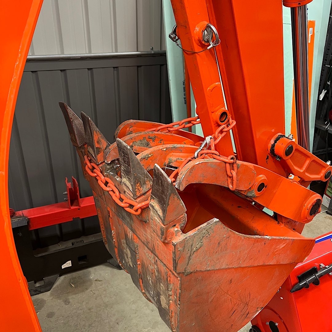

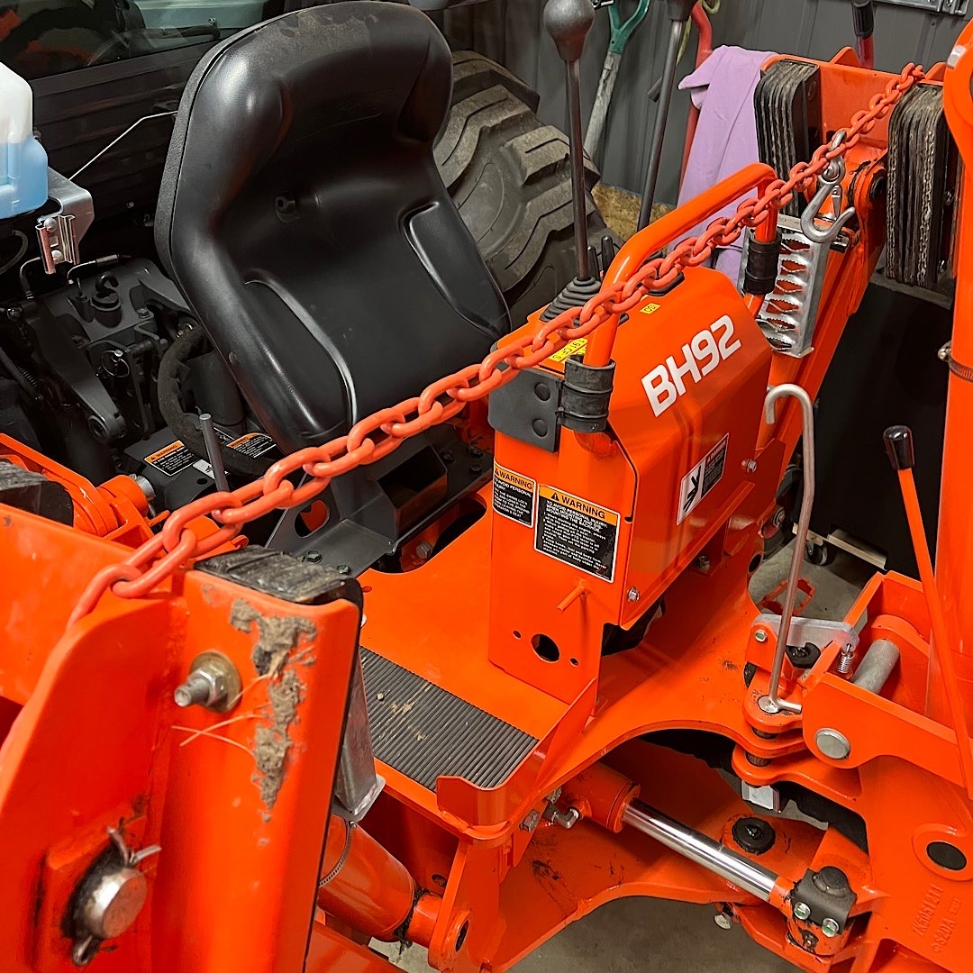

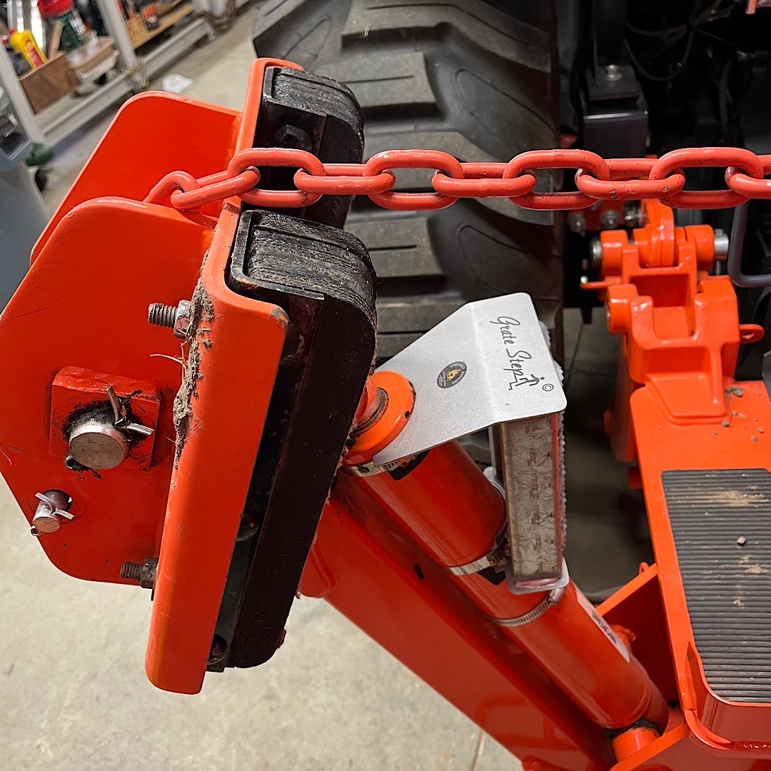

Install the backhoe shoes to eliminate catching on sharp edges. I use a chain to keep stabilizers from creep, same with bucket.
