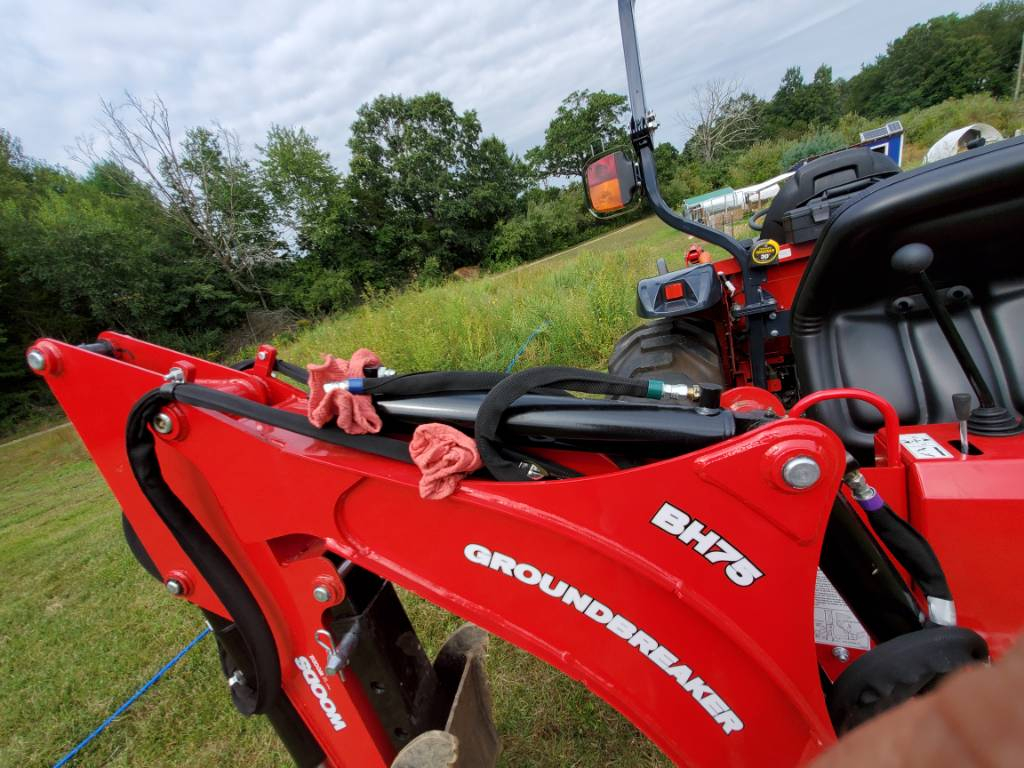

Anyone run into this issue with a woods bh75? I am digging a trench for water and power lines and found a good sized rock. No way to lift it out so I dug a deeper hole behind it and when I went to push it back with the bucket I heard a bang and the dipper arm swung loose. Found the half of the eyelet in the hole, no sign of the grease fitting. It looks like really cheap pot metal.

Maybe a bad casting? Was this the first time you've used the backhoe? It looks like it can't have many hours on it. It's WAY too clean!!

First major job with it. Took down bushes and brush before.

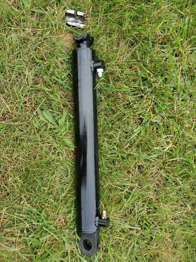

I'm a bit surprised on how thin the ring looks that broke. Would have expected something a bit more robust from Woods

Woods probably just buys the cheapest cylinders they can find.

Certainly Woods does not manufacture their own hydraulic cylinders.

Anyone run into this issue with a woods bh75? I am digging a trench for water and power lines and found a good sized rock. No way to lift it out so I dug a deeper hole behind it and when I went to push it back with the bucket I heard a bang and the dipper arm swung loose. Found the half of the eyelet in the hole, no sign of the grease fitting. It looks like really cheap pot metal.View attachment 713444View attachment 713445
Im guessing the pin is bowing significantly and that boss sees extremely high stress from the bore trying to make the pin stay perfectly straight. Stresses would be highest with a new and tight bore - like yours. How wide spaced are the BH ears in comparison to the width of the cyl rod pin boss?

It's not tight, about 1/16th on either side. The pin looked fine, no issue removing it.

Clearly there was a defect in casting of the piston eye.
May have been made that way, or damaged at some point.
If you find can't get a replacement, it would suggest there is a known manufacturing problem.
