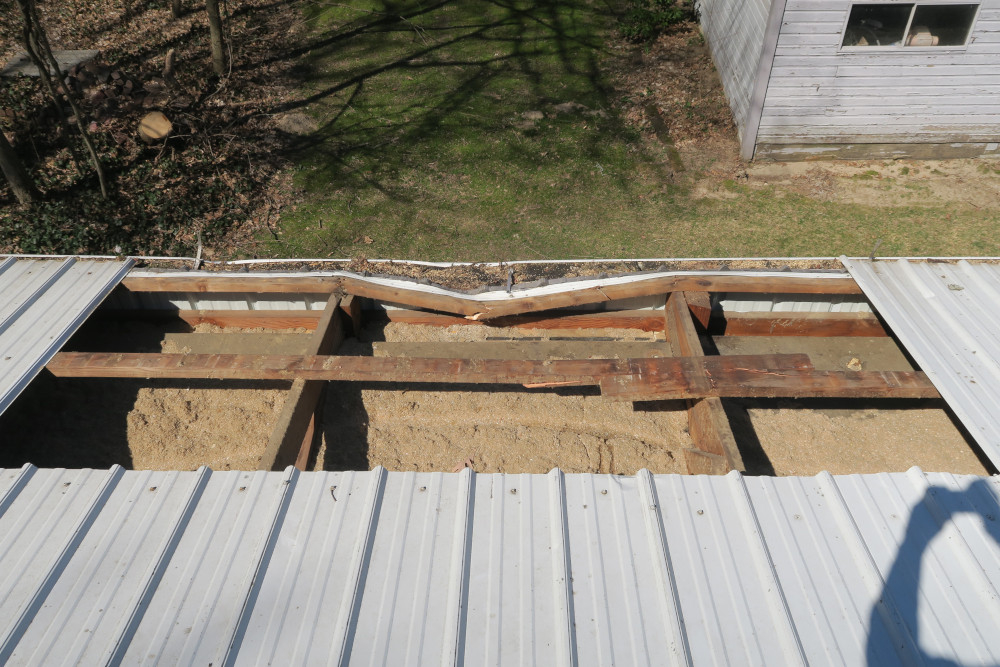

Just to close the loop on this. After waiting to get materials and good weather, I finished the repair. When I removed the damaged roof section I found I had two cracked purlins.
I spliced in some 2x4s to repair the damage.

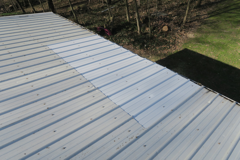

I slid the repair panels under the old metal, up to the next purlin.
I also replaced one sidewall panel but there was no structural damage. Total cost was about $150. Since this is a tractor site, I did use the tractor to get some of the material up to the roof and also to hold the sidewall panel up while I worked it under the eave trim.
   / Bad Day for Pole Barn #110
Good report Kenny. I had wondered a few times how everything turned out. No Truss damage was a Blessing!!!! Thanks for the update and pics including the tractor!!!! :)
