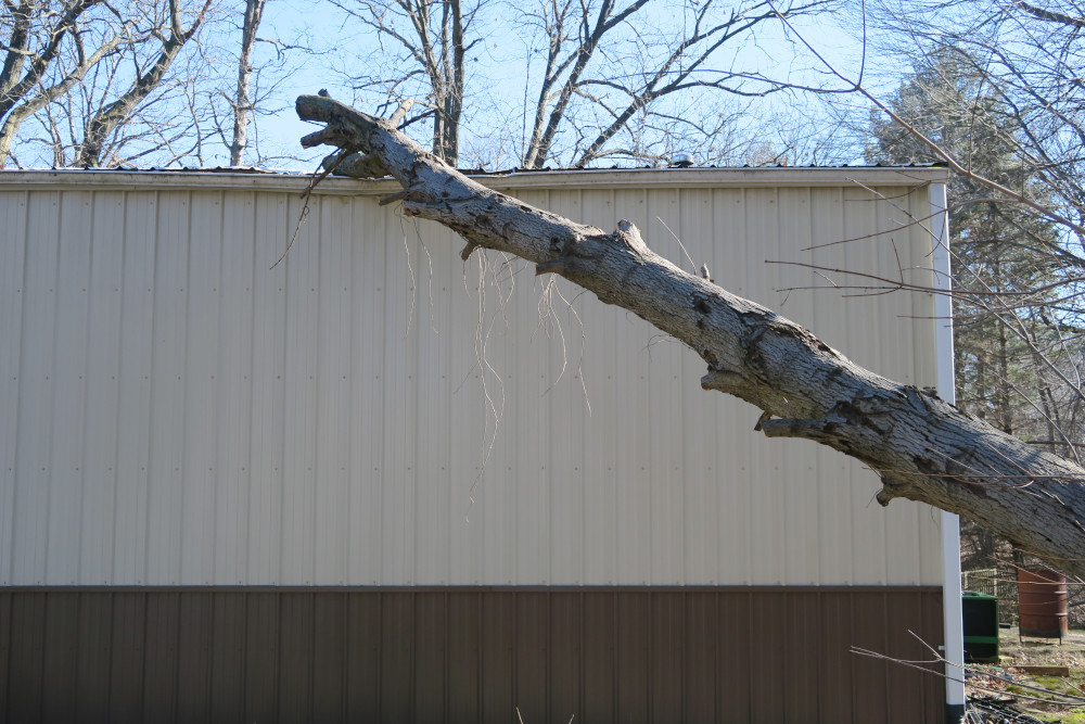

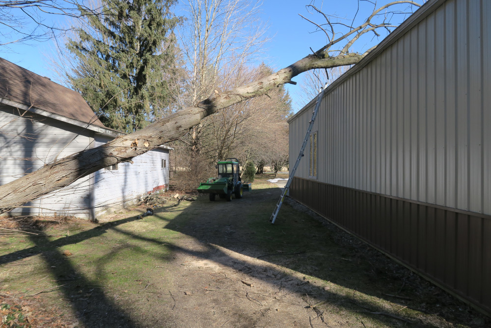

I don't have any equipment close to capable of lifting this so I did as I usually do - make do with what I have. The first thing I did was trim what I could with my pole saw from the ground and cleaned up the area.
Then I got on the roof and trimmed everything that wasn't loaded to reduce the weight and limit the potential for things twisting into the barn as it came down. My 20v Dewalt pole saw was a real hero here. It did a great job. Also, a tip for anyone else in this situation - take a broom up on the roof with you. It's gets slippery with the wood chips and sawdust.

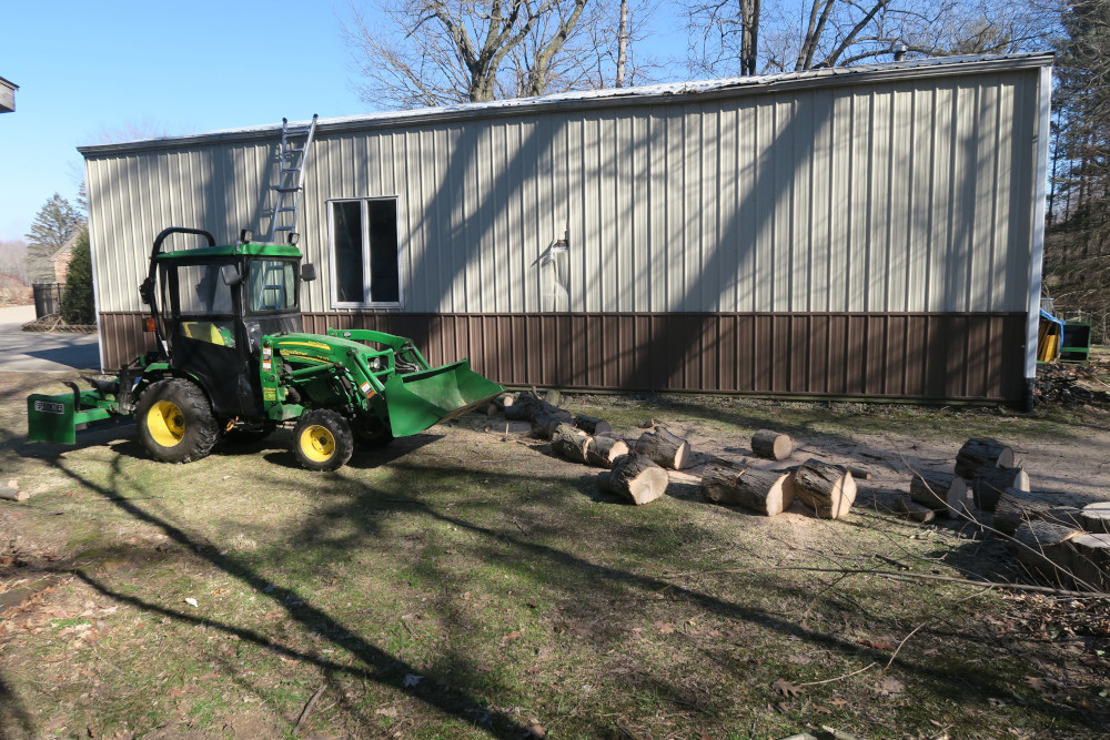

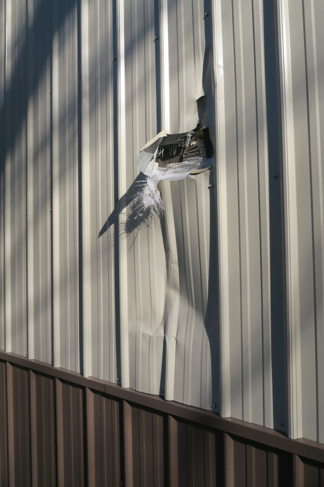

Next step, I cut a big notch in the top edge of the tree, as high as I could comfortably reach. Then I undercut it until it started to move and ran like hell. As I had feared, it did hit the side of the barn as it fell, so I've got to replace a piece of siding, as well as some roof sections. I did get lucky though in that all the wall damage was confined to a single piece. Now that it's down, I will have to work out the repairs.

That looks like it's been hald dead for a while. You may need to be prepared for the insurance not to cover it due to deglect.
You really dont need a large piece of equipment to remove that tree. Cut everything on the roof except for the main trunk that's alreaty on the garage. Then get off the garage roof and cut short enough that the rest of the trunk wont hit the wall. Your prob left with a 4ft section of trunk that will be falling uncontrolled. A 4ft section if it even does hit the building may damage 2 pannels and 2 more pannels is alot cheaper than a crane.

Nice job! Did your neighbor offer to help with cost or labor? Asking for a friend! ☮️✌🏻

How did the roof look? Did it bust the purlin? Puncture the roof metal?

Looks like it's time for another window.
