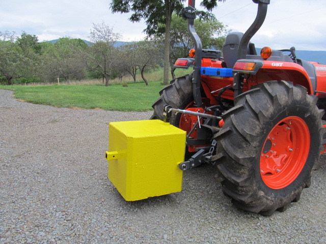

That is exactly the way I formed the corners on my counter weight block. By beveling the corners like that, not only will it prevent crumbling but also will not chip away should you hit something while making a sharp turn or backing into an object. And possibly hurt less than a sharp corner (like when hitting your shin against it).
I lined the interior of the box form with left over 6 mil plastic sheeting that I had left over instead using oil or grease as a release agent. Used a staple gun to fasten the plastic sheeting.

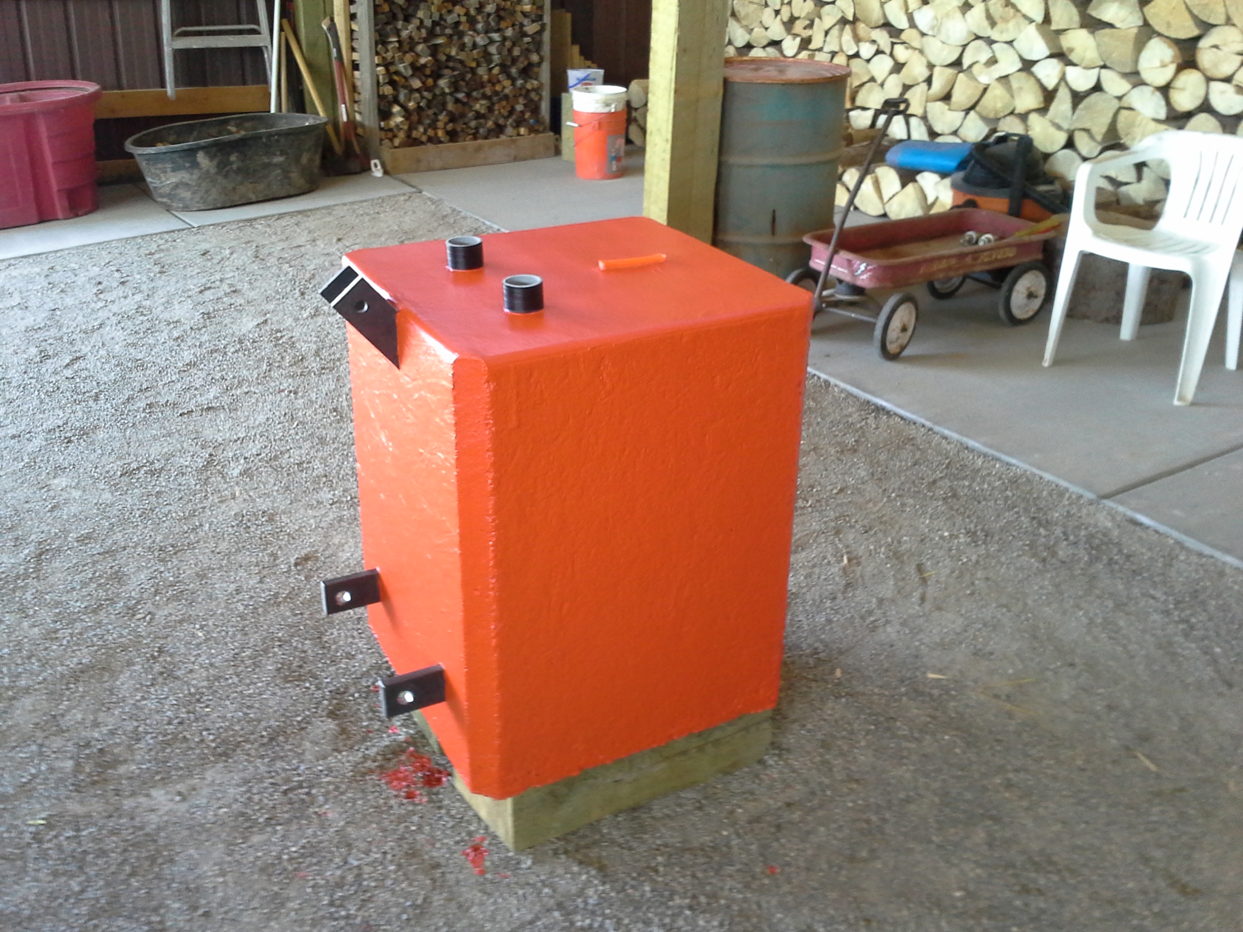

I just welded up a 2x2x1 ft steel frame from angle iron bed frames and cut panels from a remnant piece of 16 (maybe 12) gauge plate and filled it with 8 60 lb bags Sacrete... Total cost about $36 ... Probably weighs in at about 500 pounds...
Dale

It also seems the paint helps keep it from breaking apart over time. Keeps the water out of the small cracks.

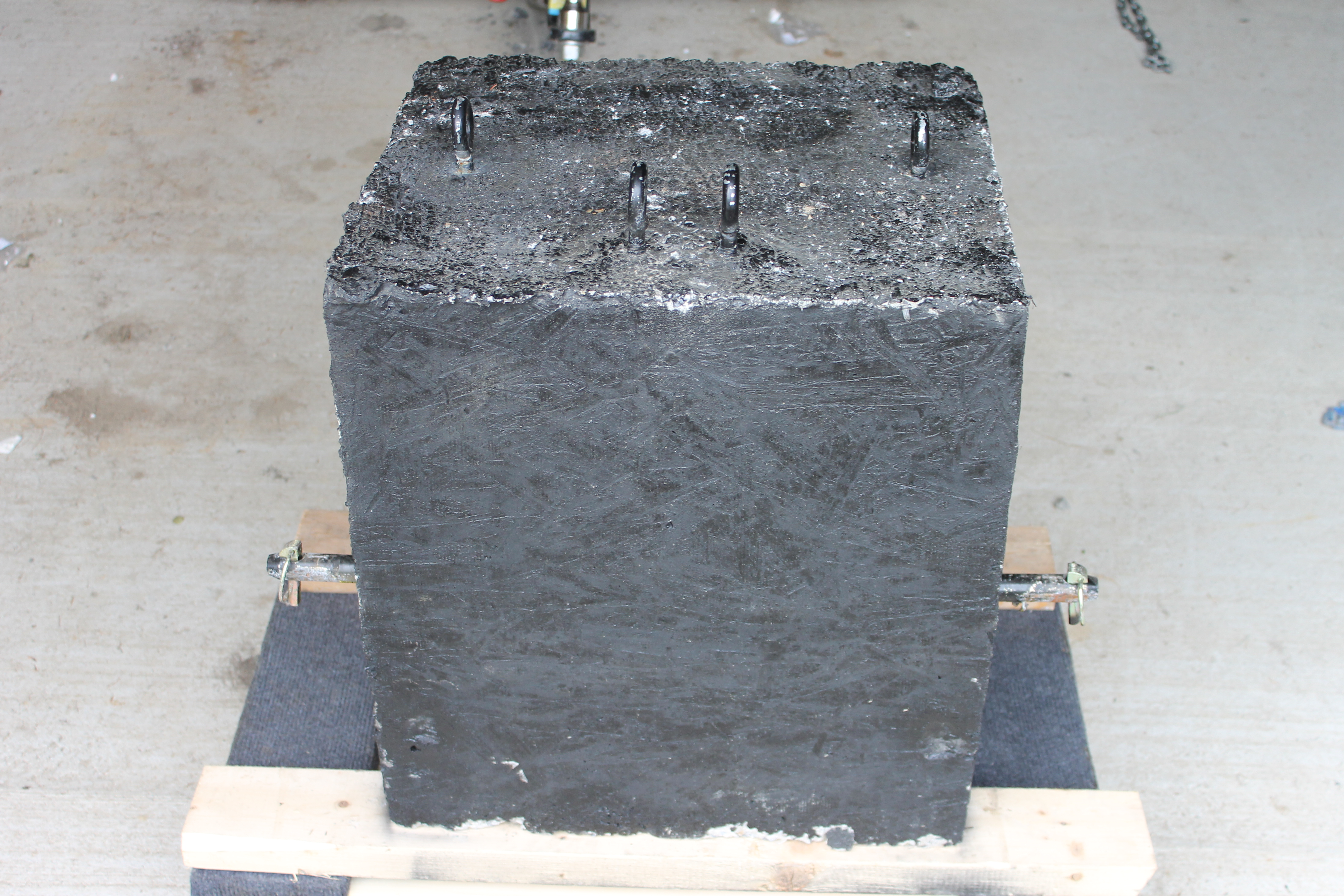

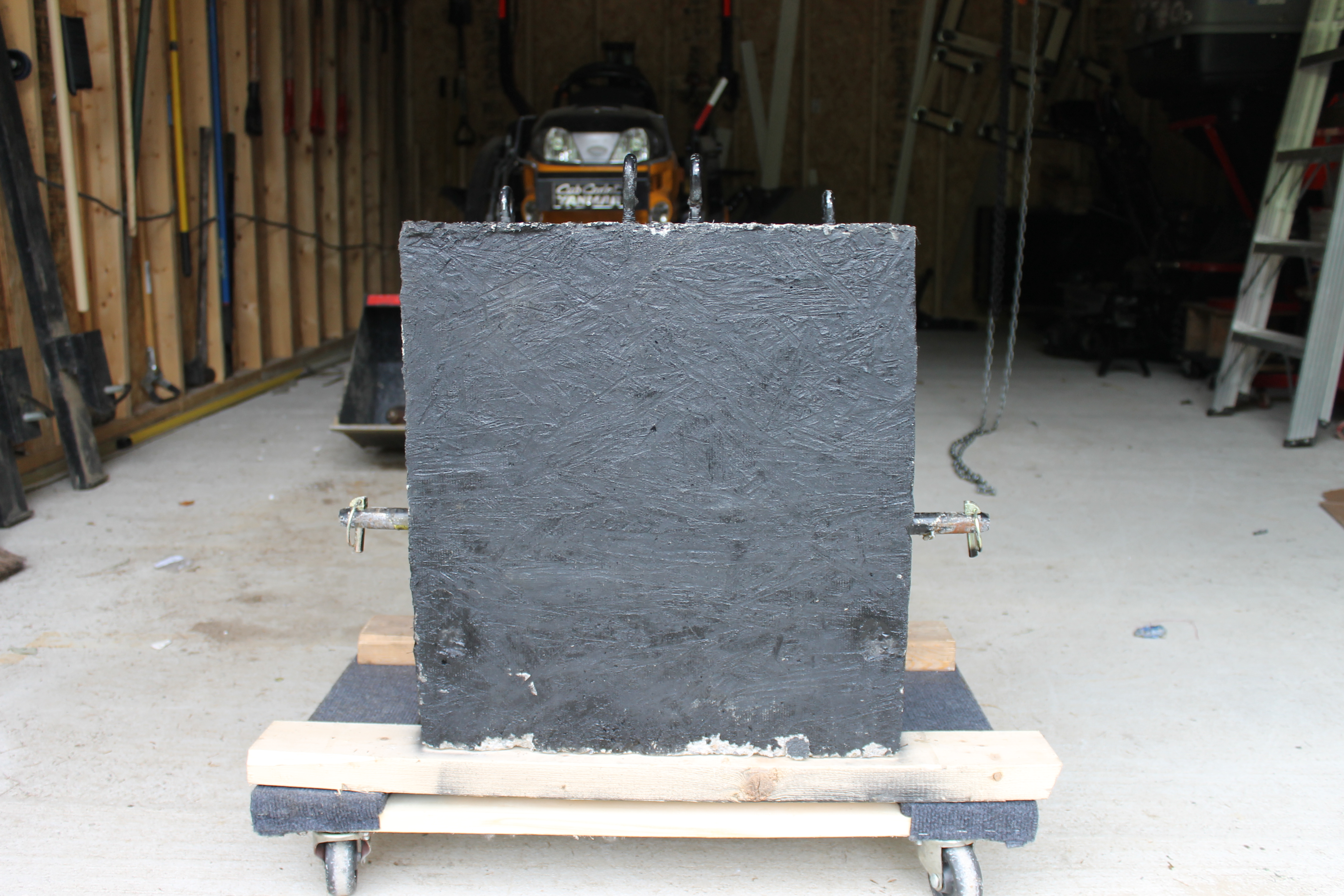

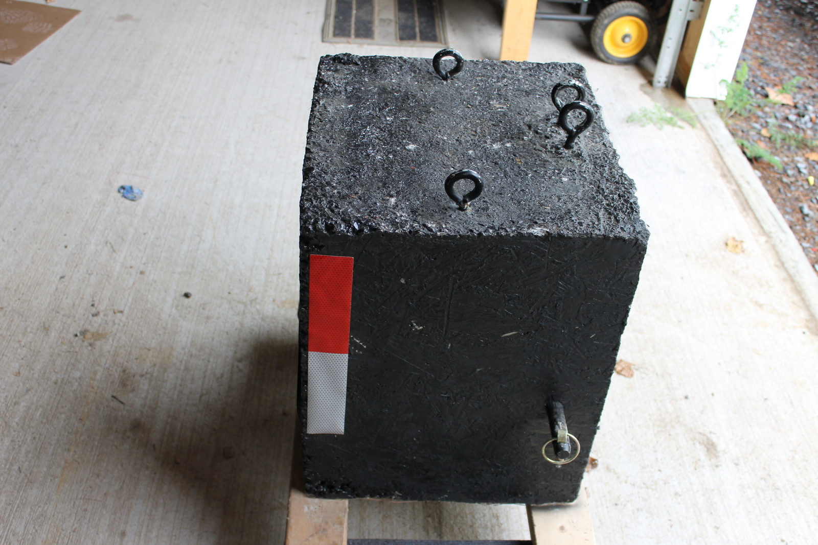

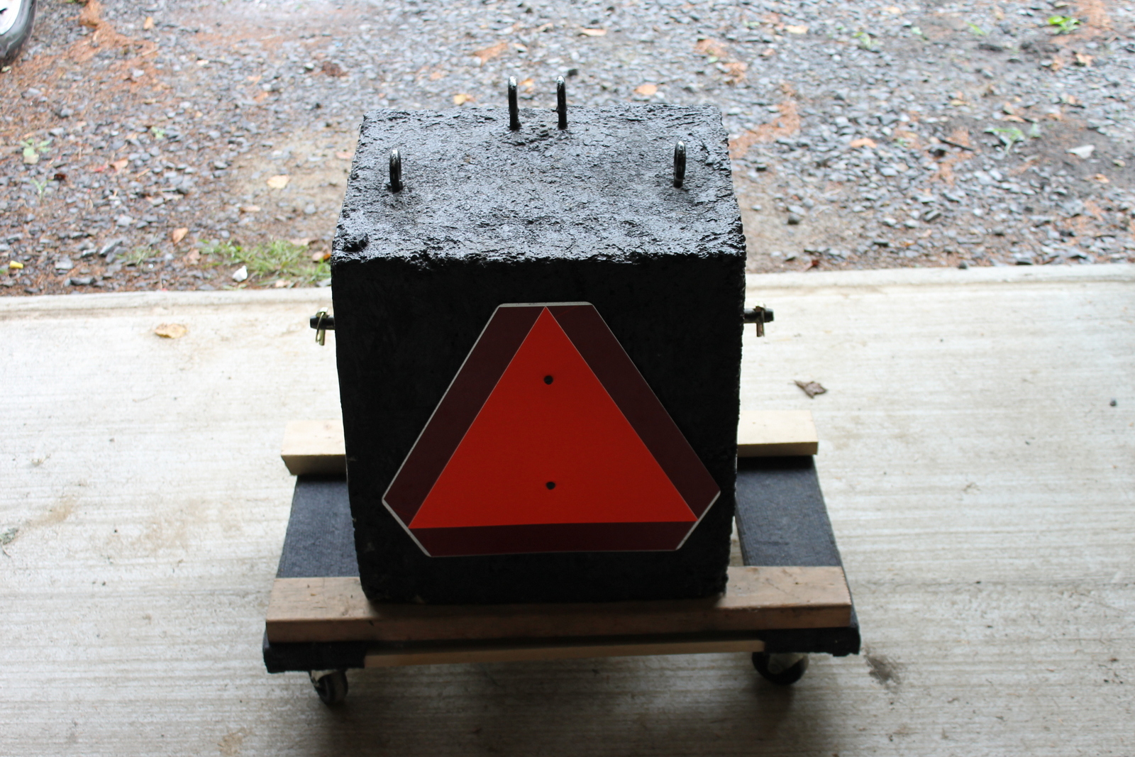

I made mine out of 4000 psi concrete when I has a slab poured.
Made a form out of OSB put a draw bar in and welded 2 large eyelet bolts for the top link all together with rebar inside. The middle eyelet bolts are centered so I can lift it with the
loader if needed.
Is measures 20" tall, 19" wide and 16" deep
I set it on a moving dolly.
