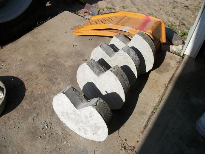

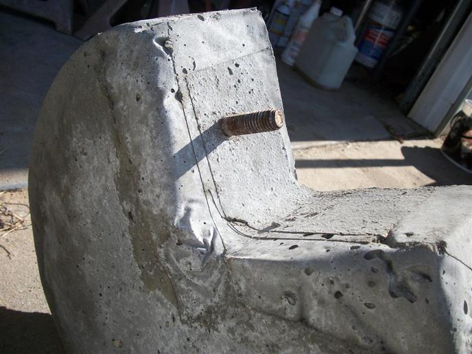

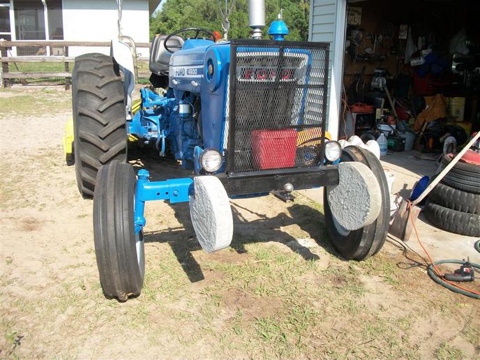

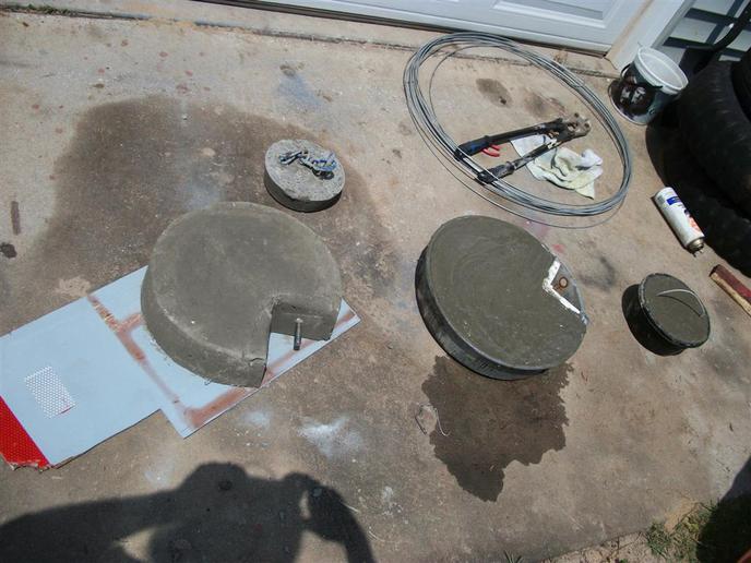

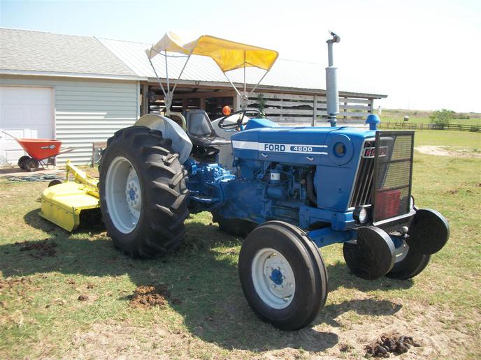

to the guy with no laoder.. if the front has a bumper.. or a tapped boss in the front bolster for a bumper.. use those attach points.
soe botls and angle iron will make good hangers.. from there.. cast some cement weights.
I made front bumper weights for my old ford 4600 using an old deep metal farm animal feed pan, formed in some pieces using styrofoam as a mould, and some 5/8 bolts, and heavy gauge rod / wire as a stiffener.
some black paint and they look like cast iron weights.. but only cost about 3$ each....
