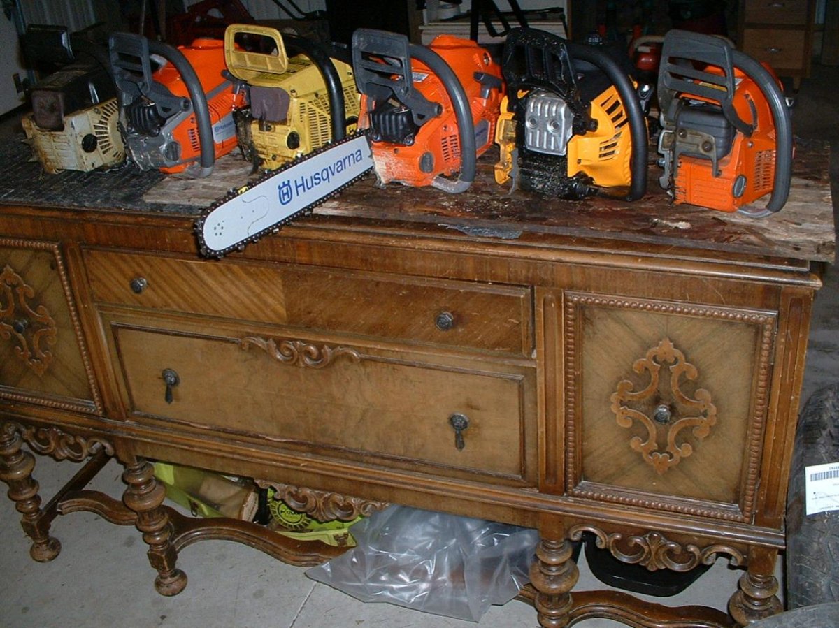

My 550 ne346 545 all stock were way faster in the hardwood cuts with 16" 3/8 over the 325 they came with. Have tested folks saws in the shop with them there and they leave with 3/8 on their 550's 346's 545's too. These saws have the balls to pull it better and faster in cuts.
450 = 325 IMO still
I have seen a case where the saw dont have the balls like a like new 490 I had and kept 325 on it. But the rest of my 490 and 500 and 5000 saws wore 3/8.
/ Bar and Chain replacement #36
45cc - 50cc some I had out testing. Not all made the pic cut as ran out of room. :p
