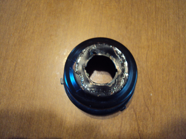

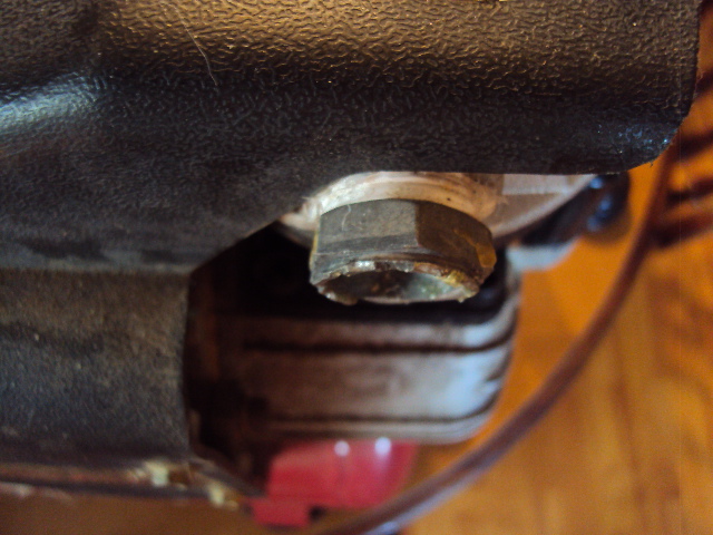

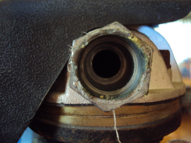

Alright, all you 'Metal Melters',
How is the best way to make a permanent and lasting repair of these two components.
I have a small air compressor. The housing that holds the filter has been 'torn asunder' from the fixture that threads into the air intake port.
They are dissimilar metal types and I'm wondering what is the best way to join the two.
The first time the compressor got knocked over, there was still some teeth holding the two together and I just used epoxy to add some strength. Now, there is nothing still engaging between the two pieces.
I haven't cleaned of the epoxy, which I will do before implementing my repair. Also, I'll make sure that I have nice, clean metal as well.
Now! Let the learning begin. :)
Thanks to all for their time and typing.
Here are some pictures:
