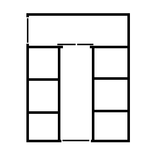

I'm building a new 30x40 pole barn on the site of my old 1800's barn.
https://www.tractorbynet.com/forums/projects/426549-new-pole-barn-started.html
The barn is going to be divided into 2 spaces - 28x30 with 6 stalls for animals (3 on each side with an aisle in the middle) and 12x30 tractor storage / shop.
The old barn had 2 electric lines going out to it. One is a 220 volt line connected to a 30 amp breaker and the other is 110 connected to a 20 amp breaker and that line is connected to a light switch in the house. My plan is to use the 110 line on the switch for all of the exterior lights, so I can turn them on and off from the house. I am planning on splitting the 220 line to two 110's. One 110 will be for all the plugs in the barn and the other will be for all the interior lights which are 8 60 watt LED shop lights.
All of the wiring in the barn will be in plastic 3/4" conduit to keep it neat and keep it away from the animals and other critters. I am also installing a new 1" conduit under the concrete floor for future expansion of a new 50 amp 220 line for a welder, car lift or electric heater etc. Will install that extra circuit down the road when we run water from the house to the barn, a distance of 150 ft.
My question is what is the proper way to split the 220 to two 110's. Can I do it in a junction box or a sub-panel? Are sub-panels allowed by code? An acquaintance who is an electrician mentioned to me sub-panels are not allowed in my situation.

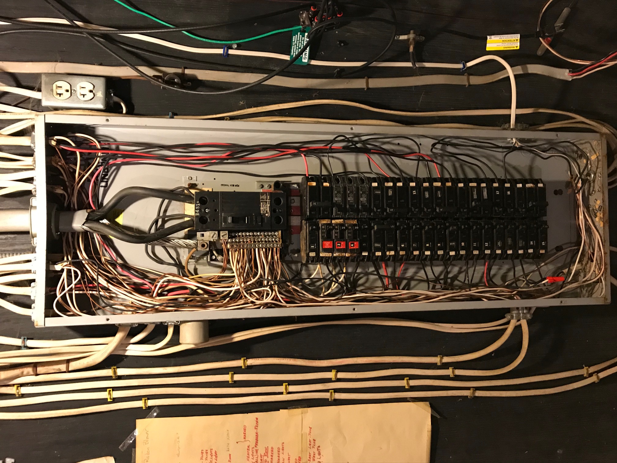

The 220 circuit is 3 wires and a ground. Black (hot), Red (hot), White (Neutral) and Ground. When I disconnected the 220 at the house panel (required for the initial inspection) both the ground and the neutral were connected to the same grounding / neutral bar inside the panel.
I should mention that in the old barn, the 220 circuit fed a fuse panel with 8 fuses which powered the lights and plugs in the different rooms of the barn.
So am I out of luck on getting two 110 circuits out of the existing 220 wiring?

Not at all. Depending on the size of the wire, you can add a small subpanel in barn. If its a 10ga wire, max is a 30 amp panel. Get one that has separate ground and neutral busses. Subpanel cannot have neutral and grounds on same buss. If the panel in house is the main panel, than grounds and neutral go on same bus bar. If the subpanel will have more than 6 breakers, it will have to have a main breaker. Since you have a 4 wire run out to barn, you have every ability to have 120v circuits out there.

What you describe can be split into 110V circuits. Neutral should be bonded to ground in your main panel (as it was) but nowhere else. You will need ground rods at the barn.
That setup is pretty standard for feeding a subpanel in a secondary structure. You will need to wire it up to a standard circuit panel (whether you just need two circuits or not, you'll need a panel). That will have have two 110V hot bars down through the inside. Single breakers would alternate one of the 110V legs or the other. Dual breakers will use both legs for 220V.
If you don't think you'll need a lot of circuits, you can get by with a very small panel. That is what I installed at my pier and in my barn. I think they can handle a maximum of 6 breakers. At the pier I have a dual 30A 220V breaker for my boat lift and a single 15A 110V breaker for a receptacle. In my barn I just have 3-4 15A 110V breakers for lights and receptacles.
Do you know what gauge that main wire is that runs from the house to the barn?
