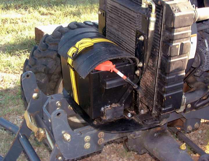

Well I've got the acid stains and rust all scraped off. I've primed and painted the rusted parts and have a battery box in which to install the battery. Now I just need to decide whether or not to re-engineer the charging system try to trade for an Optima battery or just leave it add the battery box and replace the battery every four years.
When I installed my battery box, you may notice in the photo that I didn't have a top on it. That's because the top wouldn't let me close the hood. It hit the back of the headlights. If you want to use the battery box, you may need to cover it with an old flat rubber floormat under the hold-down strap like in the photo below. I also had to straighted out my HST cooler support arms some because the battery box was too deep to fit. If you could find a smaller box, all this would be a moot point, but I used the smallest box I could find at the time and had to make some additional mods to make everything work.
Thanks for the tip. The boil over typically just drips down the side of the battery so it should fall into the box. I will put a mat below it and have some spares. This will become a daily maintenance routine like checking the oil.
The problem with my battery box without a lid is the big screened vent on top of the hood right above the battery. My tractor sits outside and rain would soon fill the box around the battery. I don't think that would be good, so I cover the box with the mat to keep out rain primarily. The fact that it keeps air from flowing over the battery is just a plus.
I keep my tractor under a leaky lean to. It doesn't get tones of water on it but it is not a garage. I was thinking of mounting a drain in the bottom of the box with a hose that would empty below any metal tractor parts. I'm concerned that this would get ripped off though.
