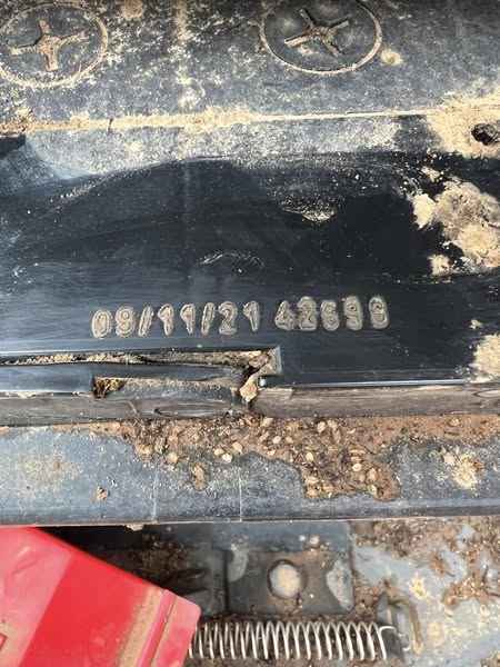

My 2022 Massey Ferguson 4707 tractor has a dead battery. The date of 09/11/2021 is on the battery, so I'm guessing that's how old it is.
I bought a battery for my wife's van last month, and the guy at NAPA said that batteries only last 3 years on modern cars because of all the electronics on them that never turn off. Her battery was 3 1/2 years old. It looks like my battery is just over 3 years old.
Does this make sense to everyone? I used to get five years out of a battery, and sometimes in older vehicles, even longer. 3 years just seems like it's too quick to die and need replacing.
I do not want another Massey Ferguson battery. I'll go to NAPA and see what they have during the week. Before I go there, I'm curious if this label makes any sense to you?
I haven't removed the battery yet. I should do that now, but it's too cold out there, and I'm going to work on my fence first.
Is there something that I should ask for when I go to NAPA to get a better battery?
Several pieces of info are available if you know how to translate the info. CCA=Cold Cranking Amps (your battery has 800) this is different from CA=Cranking Amps (I did not see this number in your battery). CCA is in my opinion a better indicator of what your battery can do.
Your battery also includes some deep cycle ratings. Not really helpful for cranking, but modern batteries tend to carry these ratings as modern vehicles often have a continued draw on battery power besides just the cranking needs.
It shows 75 ah and RC 170. A bit of explanation for these. RC=Reserve Capacity and AH=Amp Hours. Your battery says it has a reserve capacity of 170 minutes. Good luck getting that long out of a battery even new and fully charge (at least in my experience and opinion). It is also rated at 75AH (again I doubt you will ever see that ability from a battery). A bit of explanation on this.
If you have a 1 amp continuous draw on the battery, it will provide that 1 amp for 75 hours. The reverse is also there—75 amp draw will be sustained for 1 hour. Also whatever combo equates to the draw and time—25 amps and 3 hours.
My bess guess is your old battery was a 1000CA, but match the 800CCA rating, pay close attention to the space you have available for the battery in your tractor. I’m not sure what group that battery belongs to.
