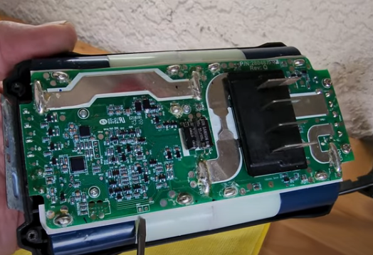

This morning, I did my 5 battery use on my Ryobi 14" saw. Overall, I am satisfied, but, well you knew there would be a but. Twice now I have had the saw quit after cutting for maybe 20 minutes. The display on the battery is indicating "battery overheated". After removing the battery from the saw, the overall temp of the battery pack does not seem that warm, how ever, the bottom of the battery does seem quite warm. This is the area where the control circuit is. Here is a cut from a Youtube video of a 2.5AH 40V battery showing the control board.
I have just got a new 40V 4Ah battery for the saw. Now I have two of them. I sent a note to Ryobi asking if the "hot battery" thing is a battery fault. Doesn't seem that the battery should shut down that way.

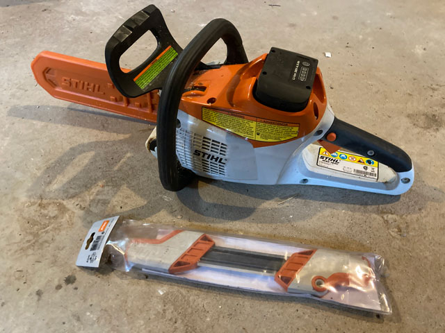

Tools brought along while blazing a trail yesterday.
The thing is LiIon batteries are fairly complex requiring precision control to prevent damage, as witnessed by that complex battery control module.
Perhaps the module knows what it is doing, that one cell is acting up necessitating shutdown to prevent a fire?
Does sound like you are due a replacement under warranty.

Shutting down for thermal regulation is the battery and tool operating as they are supposed to. The harder you push it, the more heat is generated. How long it takes to reach that point is dependent in part on the design of the tool.

All true, but the more fully charged your battery is, the less prone the tool is to overheating. A new battery (charged) is your freind! We take 5 into the field with us.
