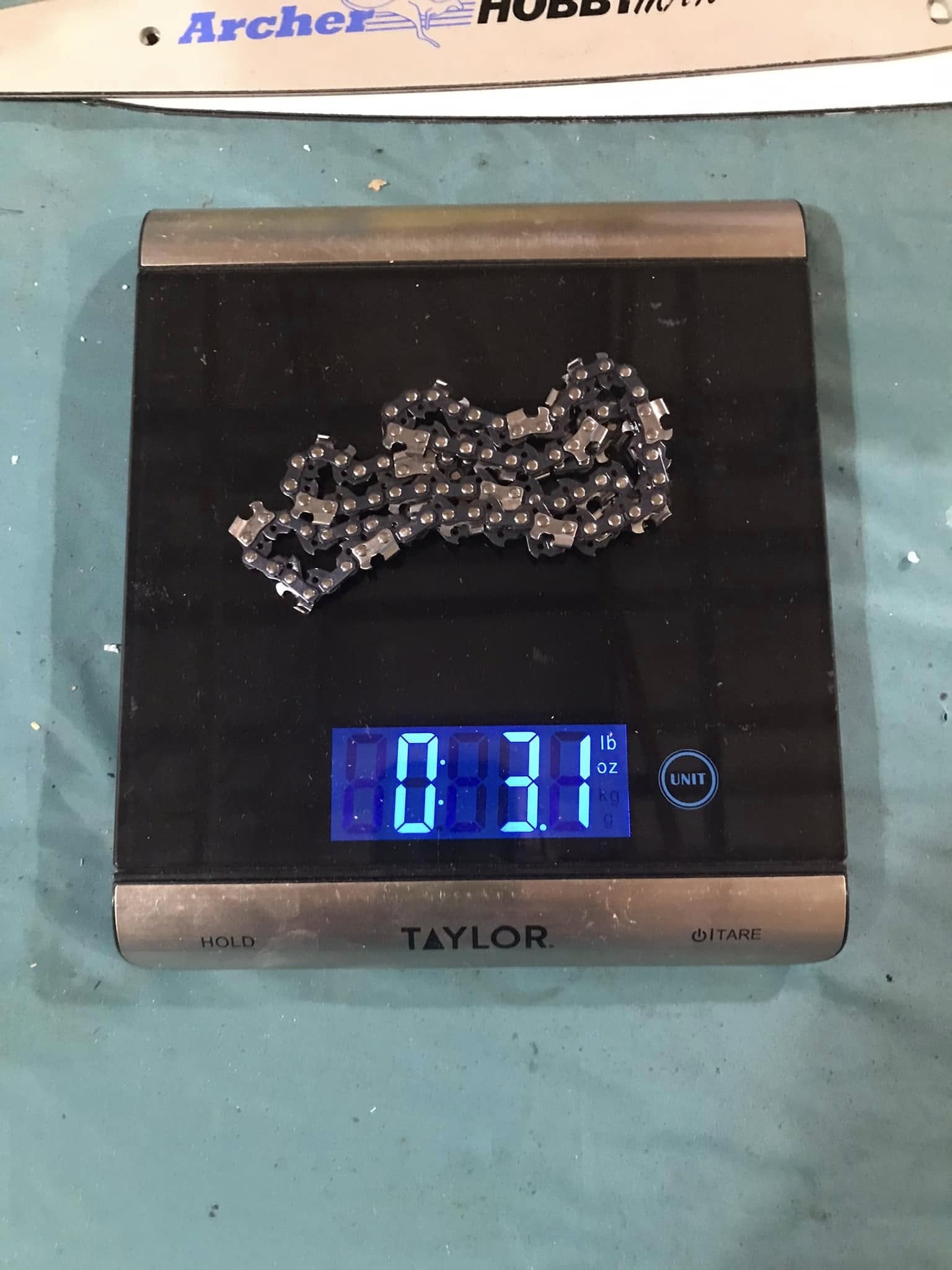

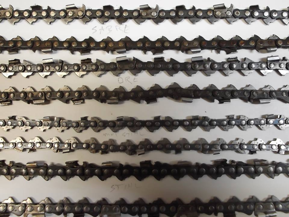

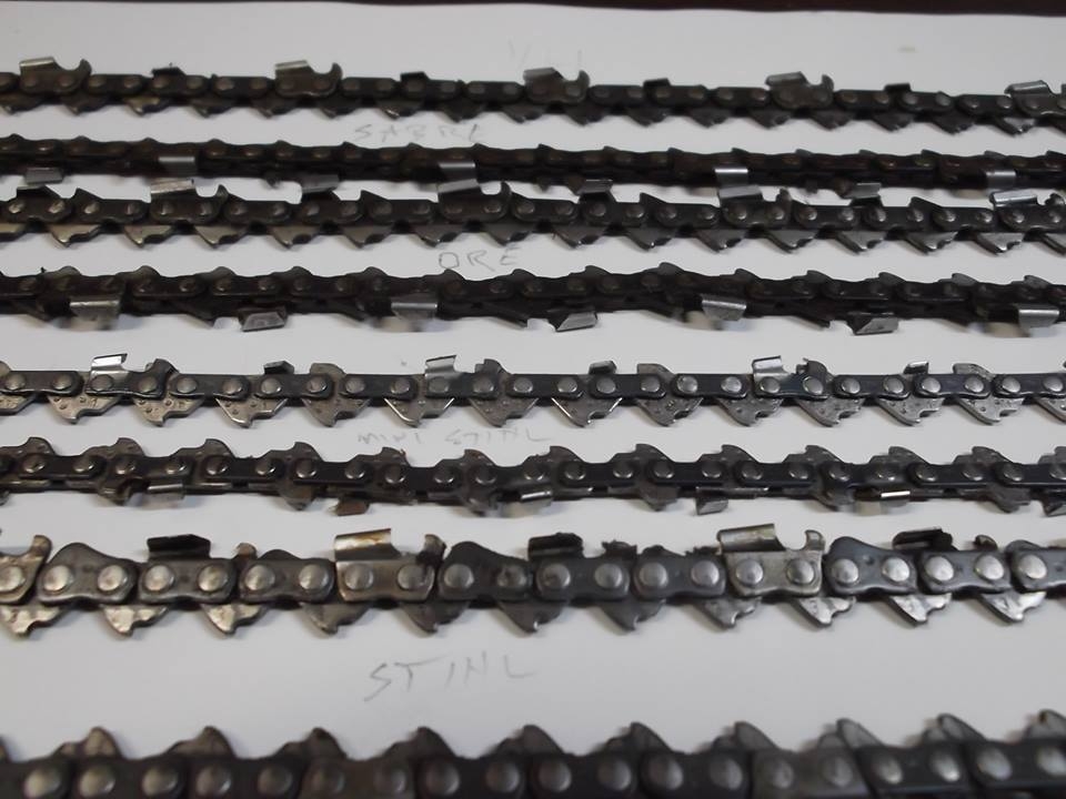

Here is size difference of regular 1/4" we grew up with and 1/4" MINI micro
Chain that was on my 150T marked 3rd chain down. 1/4" MINI micro works for me as it is.
Then one I run on my fruit tree pruning set up.
