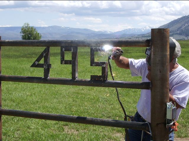

OK, I put three 12v batteries in series and it worked extremely well! I was amazed on how good a weld was made by the pure smooth DC current. This is a pic of the setup just prior to welding on some street numbers.

The only problem I had was using cheapo jumper cables that didn't always make good contact. If I was to do this on a regular basis I'd get some short heavy cables with battery terminal ends and use a proper stinger. A few times I had the arc weld the rod to the flimsy jumper cable clamp I was using.

I made about a dozen 1/2" welds using 1/8" rod. All welds were very nice in appearance with PLENTY of penetration. The cheap jumper cables got kinda hot, but I'd say even with that there would be a pretty long welding session providing the cables were let to cool between welds. I feel very comfortable using this setup.

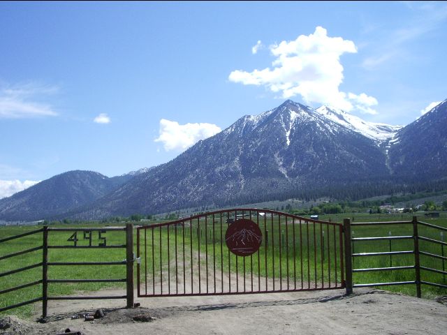

The finished product.
I want to thank all for the help as I never would have thought of using car batteries had I not read about it in this forum. /forums/images/graemlins/laugh.gif
In a pinch, and especially where there is no power it sure can do a fine job.
