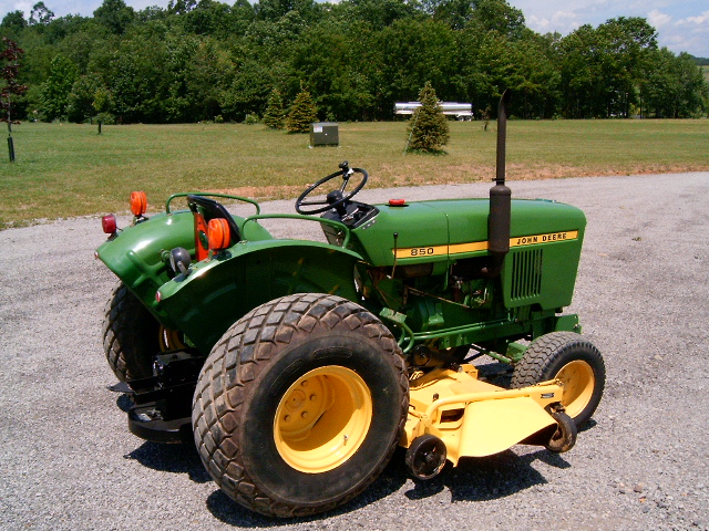

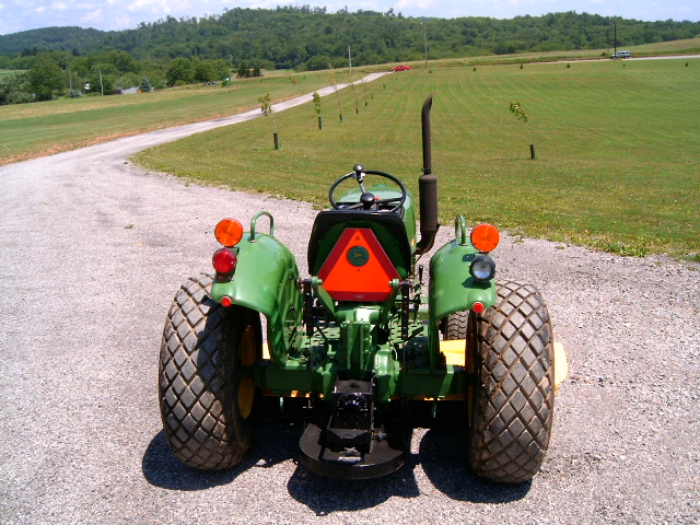

I have that same mower on my JD 850.
Pro's- Reliable mower, mows nice.
Cons-You need to remove the 3 point hitch arms and it is difficult and time consuming to remove/install the mower and gearbox if you want use the tractor for anything else.
I use my 850 for mowing only. So other than maintainance my mower never comes off.
One other thing to watch out for. My turf tires come very close to the mower deck. Larger diameter tires may rub the mower deck
