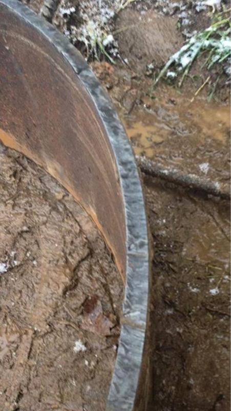

Here's a true endorsement, this is 3/4" wall pipe from the pipeline I had to cut the section of pipe in two rings and cut designs out of it. I split the pipe with the plasma but I cut the designs with oxygen acetylene for the higher speed, I was pushed for time. Exactly 3/4" thick handled it like a champ.
