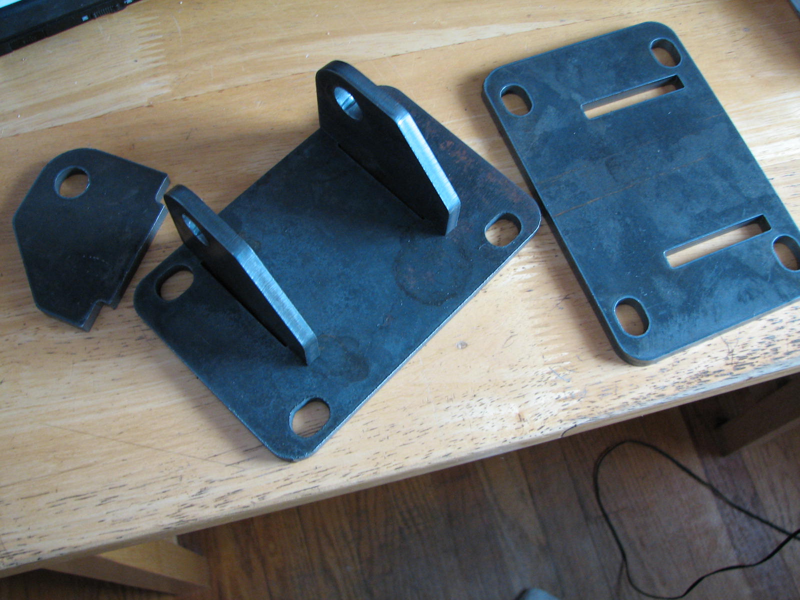

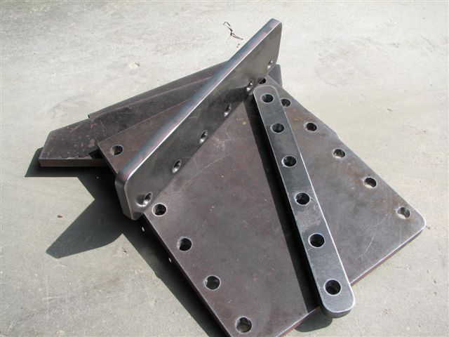

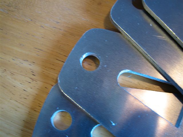

A few pics of cut samples done with the ZPowermax45 in my home shop, some hand cut, some on a cnc machine. Jim Colt

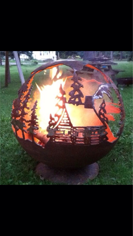

I do hand cut metal art with an Everlast Power Plasma 50. It is dual voltage and does great up to 3/4" only cost $900 and I have used it for over a year daily! Also I have dealt with Everlast customer service and they are very knowledgable and easy to work with. Plus there is a 5 year warranty on all Everlast machines.
   / Best 3/4" plasma cutter for under 2K?? #20
That fire pit is incredible! Nice work!
